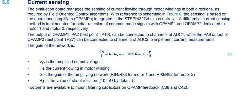

We noticed that the Overcurrent warning appears even when Overcurrent Protection is disabled. Could this be related to the missing feedback capacitors C38 and C42 on the OPAMPs for current sensing?
