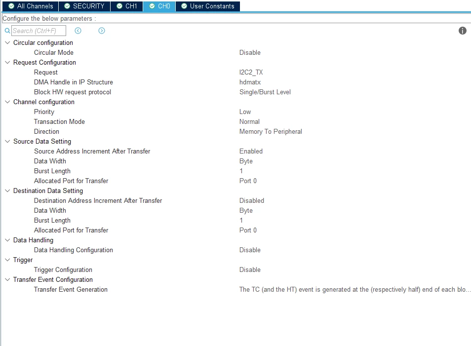

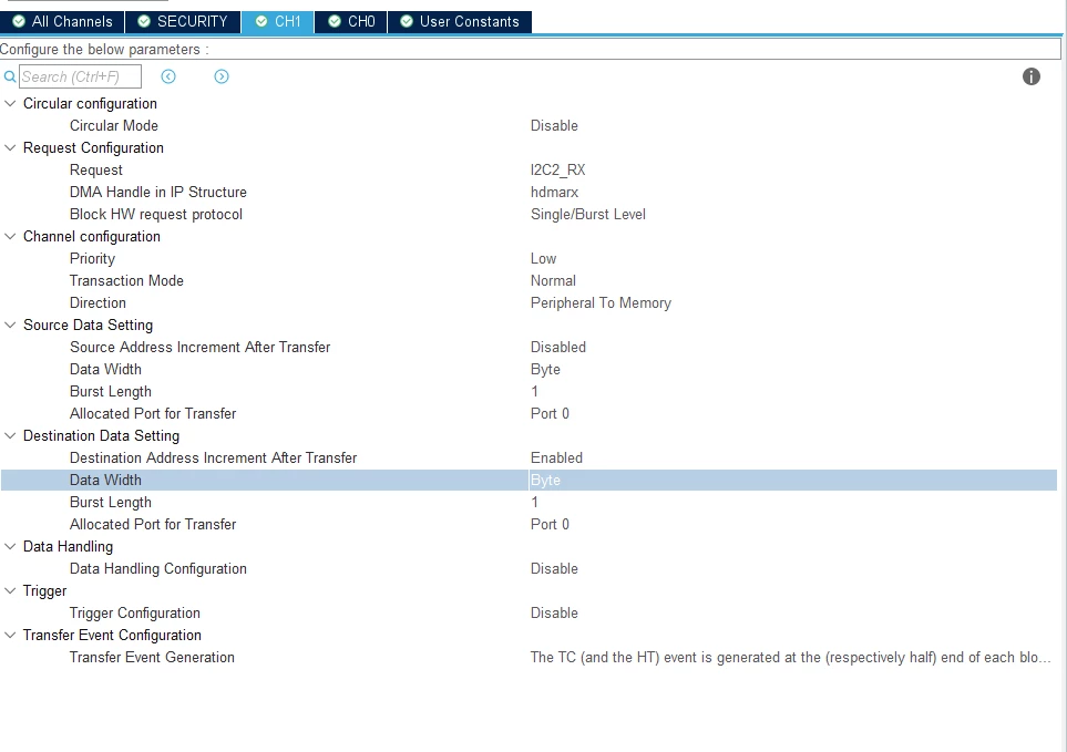

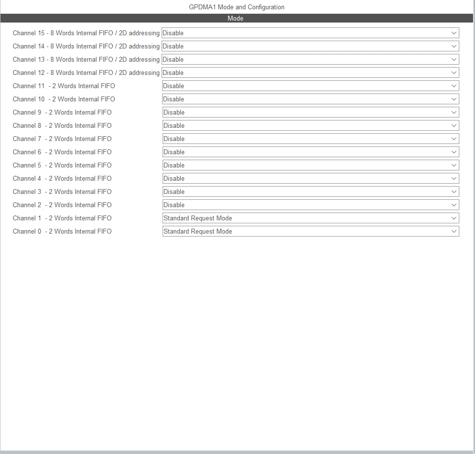

I've been playing with the U585 IOT dev board and really enjoying it, I've got I2C communicating with the sensors without DMA and now I would like to test out the GPDMA. However, there is a little more too this DAM controller then the DMA on the older STM32s which is what I'm used too.
I've done the bellow configuration in MX and I'm then calling HAL_I2C_Mem_Read_DMA, while HAL_I2C_Mem_Read works fine HAL_I2C_Mem_Read_DMA returns HAL ok but the data value, which should be 179 from the Who_Am_I reg of the LSP22HH, remains 0. I'm guessing my issuse is with my GPDMA config since I have not used it before.

Ok, so this is a bit embarssing but I'm going to leave it here for anyone who might have simlier issuses. I changed two things that got it working.
  1.  I made sure all of the interrupts were enabled, particully the I2C and UART event ones.
  2. The embarssing bit. I was not waiting for the DMA transfer to finish before checking the values, I was still treating it as if it were a blocking function even through being non-blocking and freeing up the cpu is the whole point of DMA. I still think that some of the issuse were realated to not having the correct interrupts since in theory on the next iteration of the loop the data should have updated.

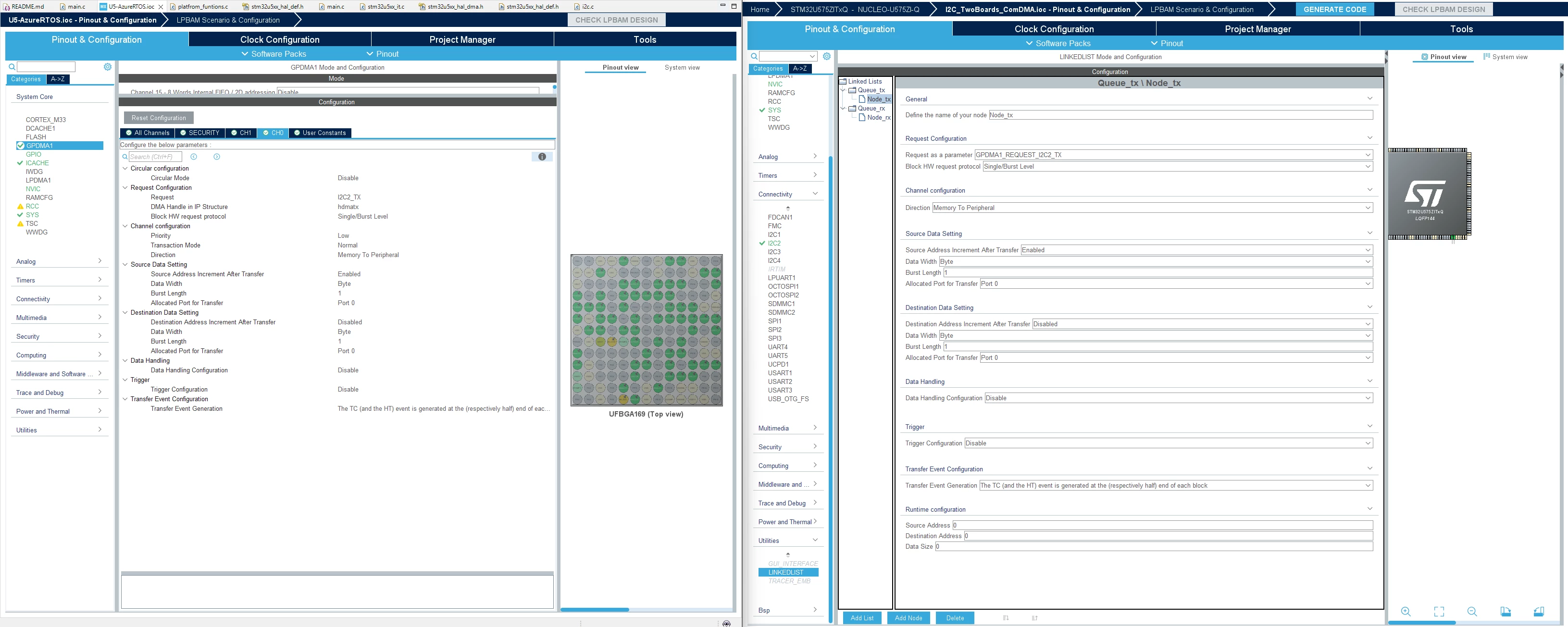

Feb 3, 2025 1:54 PM UTC
Hello @Saket_Om,

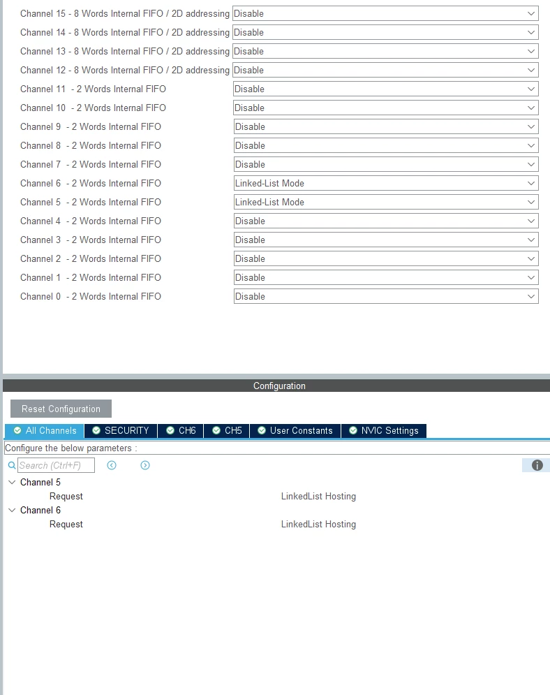

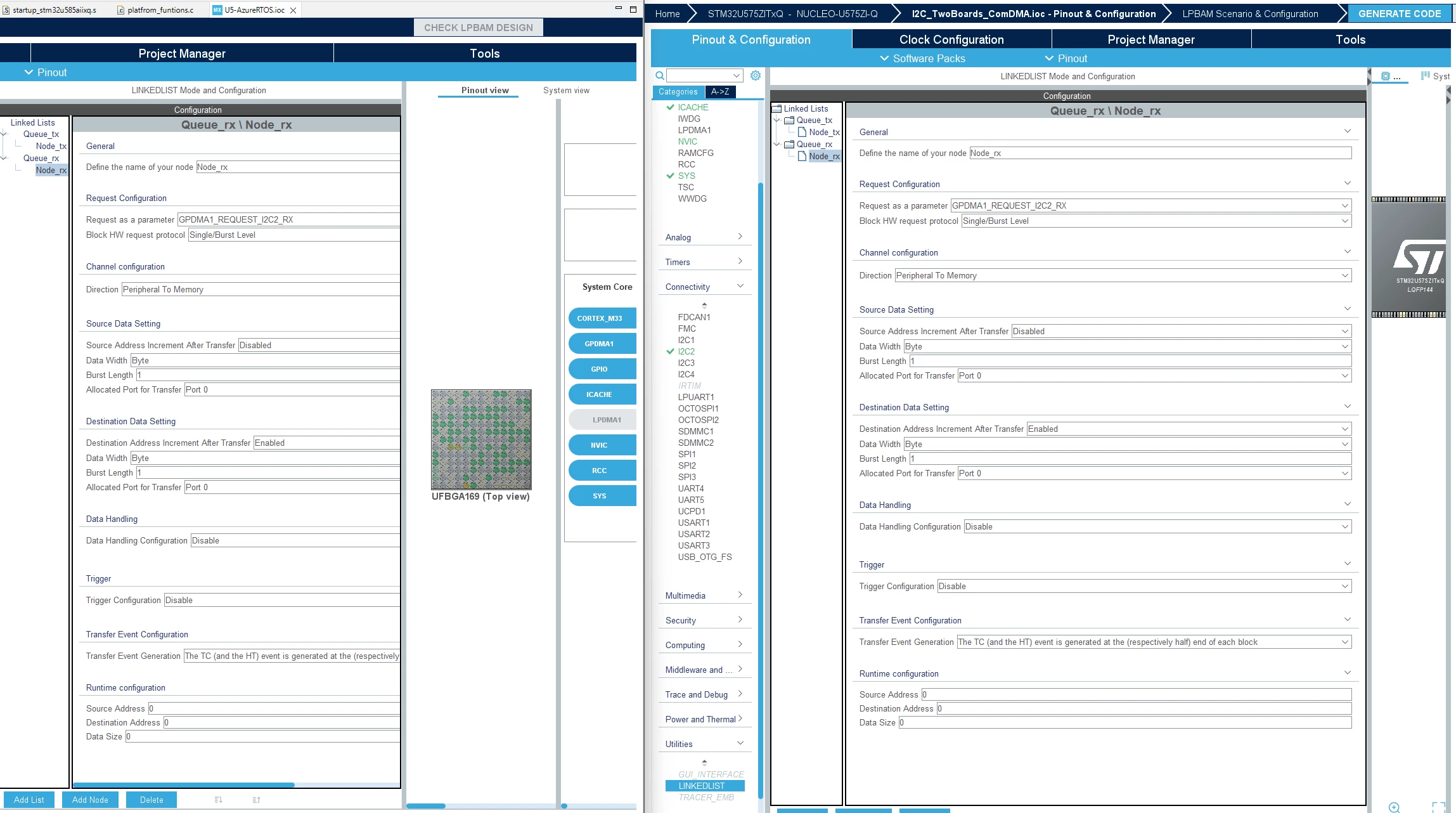

Thanks for your help, I appreciate you taking the time. I have had a look through the U575 example, good thinking, I had not considerd having a look at example from a different U5. The first thing I notice is the use of linked-lists, is this needed for I2C? I had a skim read through AN5593 (quite daunting but I guess you only take what you need)  and it does not seam to say if linked lists are strictly needed for I2C. Apart from the use of linked lists, my settings I have been using are identical (see Bellow). I did take note of the call to __HAL_LINKDMA in the example you provided and thought that might be my problem but I found that call in the HAL_I2C_MspInit function of my code.
I have also just tried using linked lists and I have not had any success there either, see my modifed test code and MX configs bellow.
 /* USER CODE BEGIN 2 */
 MX_Queue_tx_Config();
 HAL_DMAEx_List_LinkQ(&handle_GPDMA1_Channel6, &Queue_tx);
 __HAL_LINKDMA(&hi2c2, hdmatx, handle_GPDMA1_Channel6);
 MX_Queue_rx_Config();
 HAL_DMAEx_List_LinkQ(&handle_GPDMA1_Channel5, &Queue_rx);
 __HAL_LINKDMA(&hi2c2, hdmarx, handle_GPDMA1_Channel5);
 uint8_t data;
 volatile HAL_StatusTypeDef status = HAL_I2C_Mem_Read_DMA(&hi2c2, 0xBB, 0x0F, I2C_MEMADD_SIZE_8BIT, &data, 1);
 /* USER CODE END 2 */
My next step would be to start poking around the RAM and device registers to see if the DMA is actaully moving the values to the approprite place in the I2C controller, but that feels like a very difficult and extreme measure. Hopfully you have some more insite you can offer.

Feb 4, 2025 8:01 AM UTC
Hello @WrenchInTheWorks
The use of linked lists in DMA is not strictly required for I2C communication. Instead, it depends on the specific requirements and configuration of your DMA and I2C operations.
To use the DMA in standard mode with I2C, please refer to the article "How to configure the GPDMA". In this article, we describe the necessary steps to configure GPDMA in standard mode for UART transmission. You can adapt it to your I2C application.
You can also look at the example Projects/NUCLEO-H743ZI/Examples/I2C/I2C_TwoBoards_ComDMA, which uses DMA in standard mode for I2C communication.
If your issue didn't get solved, please consider sharing your entire project with us so we can support you more effectively.
To test if your DMA is transmitting the data, you can change the setting to "Memory to memory transmission" and then check if your data has moved to the destination.
