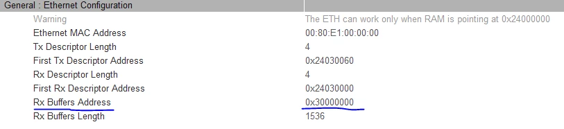

Hi @B.Montanari, @Lucas_Costa,
I'm following your tutorial and trying to implement a web server on an STM32H747IIT6.
In your post regarding the Ethernet settings, there is no field for setting the RX buffer address. Where should the RX buffer be placed?
My code is running, but my device never gets an IP address assigned. I also tested this on a Nucleo H755ZI with the same issue.
I'm using the latest version of CubeIDE (1.17) and the latest version of the middleware for the H7 series (Azure RTOS 3.3.0).
Best regards
Oskar P.

mbarg.1
Senior III
Feb 10, 2025 12:19 PM UTC
IP address and Rx buffer are 2 different questions.
Rx buffer is in app_azure_rtos.c:

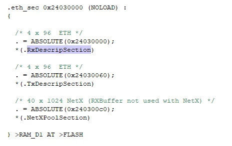

matt-crc
Senior III
Feb 13, 2025 1:13 AM UTC
Hi @OskarP
I thought RxBuffer was not used in NetXDuo...  this is what I have in my .id file:
seems to work for me on an H743
Matthew
