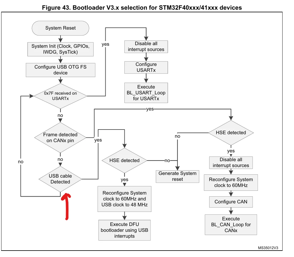

MM..1
Sep 15, 2026 2:34 PM UTC
DFU isnt so simple, but is implemeted in system memory bootloader, then you only require run it from app and read AN2606
Sep 15, 2026 2:40 PM UTC
Oh I didn’t see that app note. I’ll get to reading.
From what I understood, to update Boot0 will have to be high on restart or power up.
Would it matter it it came online at the same time as 3V3 were the MCU is powered from.
Kind regards,
William
Sep 15, 2026 2:44 PM UTC
An easier method is to jump to the system bootloader directly from user code when required, rather than setting BOOT0 and restarting. You will likely need to deinitialize USB before the jump.
Sep 15, 2026 5:27 PM UTC
Hi ​@William_RnD
You should provide more details about the STM32 device you are using, because some parts do not support USB DFU in the system bootloader. Also, please be careful if your application remaps pins, since the bootloader may not use the same pin routing. It is therefore important to check AN2606 for the exact bootloader support and pin requirements for your device. Providing more context about your application and board will help us give you a more accurate answer.
If there are no such constraints, then you may simply jump to the system memory bootloader directly from the application, as suggested by TDK.
To give better visibility on the answered topics, please click on "Best answer" on the reply which solved your issue or answered your question.Best regards,FBL

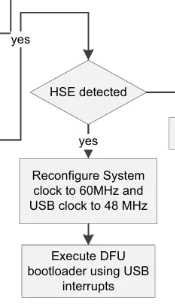

Sep 16, 2026 1:44 PM UTC
To use the USB DFU bootloader in system memory, you need to jump to the bootloader from an as-reset state. Nothing initialized. The bootloader detects the USB connection and will use it. You are looking at a flowchart for what the bootloader does.
Sep 16, 2026 1:59 PM UTC
