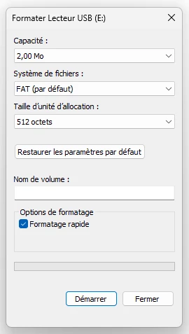

My problem: when I leave the USBD_STORAGE_Write and USBD_STORAGE_Read functions empty, Windows can see the size of my disk and offers to format it (without success):

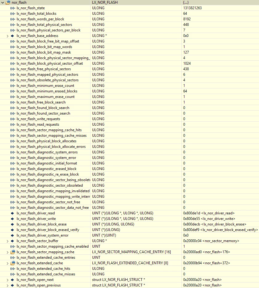

For your information, here is the information from my storage instance when I do:
lx_nor_flash_open(&nor_flash, "NOR_FLASH_DISK", lx_stm32_nor_custom_driver_initialize);

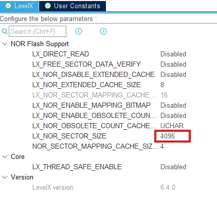

Does LX_NOR_SECTOR_SIZE correspond to the size of a physical sector?
Mine are 4096 bytes (or 1024 words). And will this value define the size of the logical sectors?
I have the impression that the logical sectors need to be 512 bytes.

I have checked that your flash has 4K sector so you should leave this too. The one more thing I may suppose is that you use LevelX functions but you check for FileX return codes (FX_SUCCESS). That may lead to a situation when your code always ends up in the error handler.
