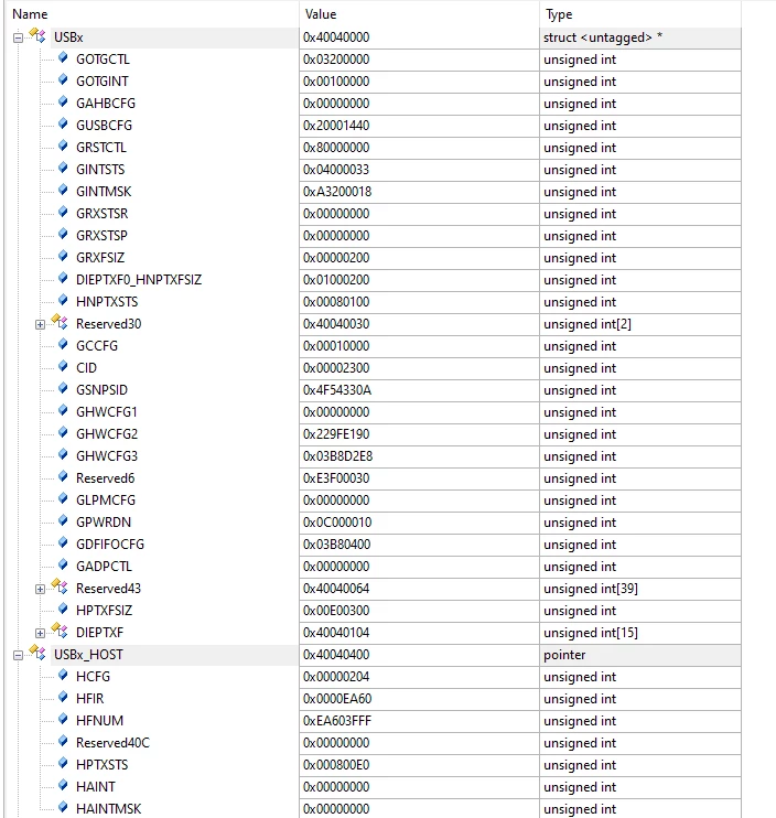

I am trying to add USB stick support to STM32H7B0VBT based board. I used STM32CubeMX to generate code relating to USB host, FatFs, and system clock. USB plugging in and unplugging can be recognized by the middleware (in usbh_core.c), but the return value is always USBH_BUSY from function USBH_HandleEnum(). So the operation on USB stick is not functional. I have a few questions here:
1. We use the USB port as USB OTG, the D+ and D- signal is connected to ground with 1.5 ohm pull-down resistor.  Anything else should we take care of regarding to the USB OTG interface.
2. As to system clock, what is the best way to configure for USB OTG with STM32CubeMX.
3. As to the register relating to USB host, what registers should be checked, and what are the correct values for each register.

Hi @Huiqi
1. According to datasheet, Table 122 footnote, No external termination series resistors are required on USB_DP (D+) and USB_DM (D-); the matching impedance is already included.
2. Which speed? USB core typically operates at 48MHz. AHB frequency should be higher than 30 MHz.
3. You can check in the reference manual, Global interrupt register section 62.14.20 Host-mode registers and  to be checked! Otherwise, I would recommend using debug logs for instance. In which case you are getting USBH_BUSY from function USBH_HandleEnum()

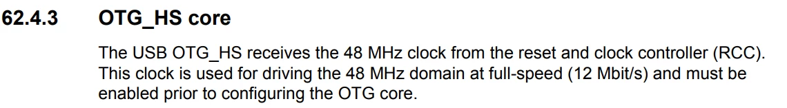

2. An external 8MHz oscillator is used in our application. As to the USB speed, I mean the value "To USB(MHz)" in STM32CubeMX software's Clock Configuration. Should it be 48MHz or 12MHz for FS mode?
3. I am checking the value of register section 62.14.20, but I am not quite sure the correct value (bit value) in each register. Can you let me know the value or bit value I need to check. The register values in my application are shown below.

Hi @Huiqi
I guess you didn't get my first point.
You mentioned "the D+ and D- signal is connected to ground with 1.5 ohm pull-down resistor. "
However, the datasheet says:
You should not add more resistors on DP and DM.
Second, USB clock source must be always 48MHz. The output depends on the operating speed FS or HS. Check the reference manual section 62.4.3 OTG_HS core
Finally try to increase USBD_DEBUG_LEVEL. It is simpler to have middleware logs to debug console than checking each register.
