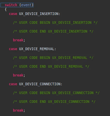

AScha.3
September 14, 2023
ok, i installed Azure rtos and enabled audio/host , on new H563-nucleo 144 board.
fine, compile, no errors. no work also. there is nothing, than set up , no enumeration, no functions are called, the name "audio host " is all.
looking at MS original Azure examples, this seems like a copy. But i didnt find a working example.
so how to find out, which functions to call, without  an example ?
Is there any working example from STM ?  i didnt find it. i might giving up now, to do any audio host with STM.

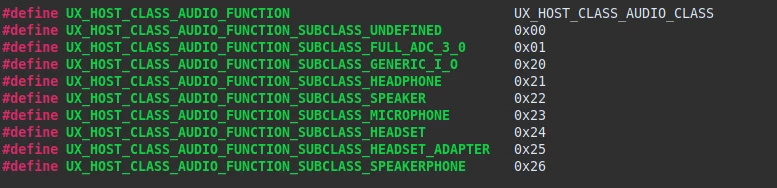

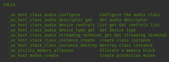

AScha.3
September 15, 2023
full consent.
what i found so far:
in STM audio host :
so (if i am right) this can only connect to a headset, as is a demo for the H7..dk board. thats it.
and in Azure audio host:
so this might connect to most "typical" audio devices...  if you get it running !
because the state machine (or however its called) is empty:
so maybe (!) with a lot of searching and try and error can find some useful things...like:
we will see. :)

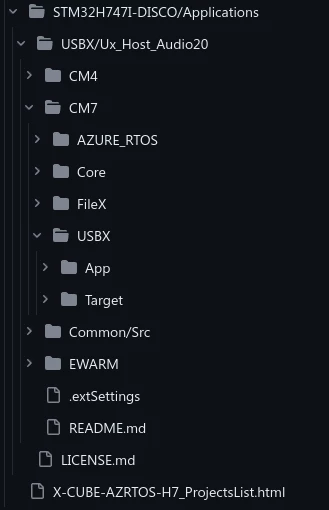

September 26, 2023
Hello, A USBX Host Audio 2.0 example alpha package is available now on GitHub: https://github.com/STMicroelectronics/x-cube-azrtos-h7/tree/dev/usbx/Projects/STM32H747I-DISCO/Applications/USBX/Ux_Host_Audio20 Kind Regards,
AScha.3
September 28, 2023
thx for info !
i tried import to cubeIDE...
but there is no IDE project with .ioc file, only for using IAR !
so : STM developers not using STM32CubeIDE ?? or why ..?
