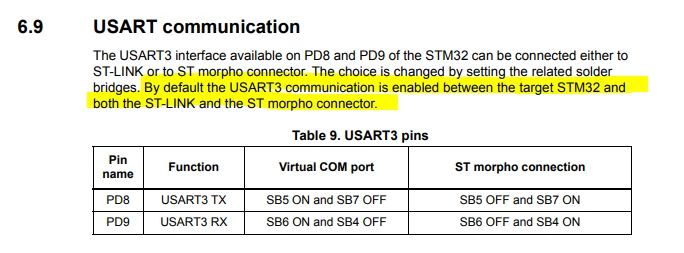

I have an older STM32 Nucleo-F746ZG and I want to try and send some serial over the ST-Link. I am in Ubuntu with VS Code. I have successfully built the project and it appears to be running in debug mode. However when I try to connect and read the serial output via Screen, Putty or even the Serial Monitor extension nothing is showing up on the serial port. I have found the ST-Link is at /dev/ttyACM0 and I have added my user to the dialout group, but nothing shows up.
I am using UART2 in Asynchronous mode, added interrupt and using VS Code in debug mode. I suspect that this is OS related, but wanted to know if anyone had any suggestions on where to look.

@hdferguson3 wrote:
I am using UART2
Is that USART the one connected to the ST-Link ?

How can I determine that?
Andrew Neil
Jan 13, 2025 6:25 PM UTC
From the board's User Manual and/or Schematics - as illustrated in the linked post/thread
Jan 13, 2025 6:31 PM UTC
Oops, let me swap to USART3 and try this again!!! I'll report back.

You said it's, "an older STM32 Nucleo-F746ZG" - does that mean it's previously been used by you and/or others?
If yes (especially if others have been using it), you'll need to check those solder bridges (SB4, SB5, SB6, SB7)
Jan 13, 2025 6:35 PM UTC
Boom! That was it. I knew I had overlooked something simple. I followed a tutorial and looking back that didn't overly make clear which USART they picked an why. So, make sure you know which USART to use and why.
