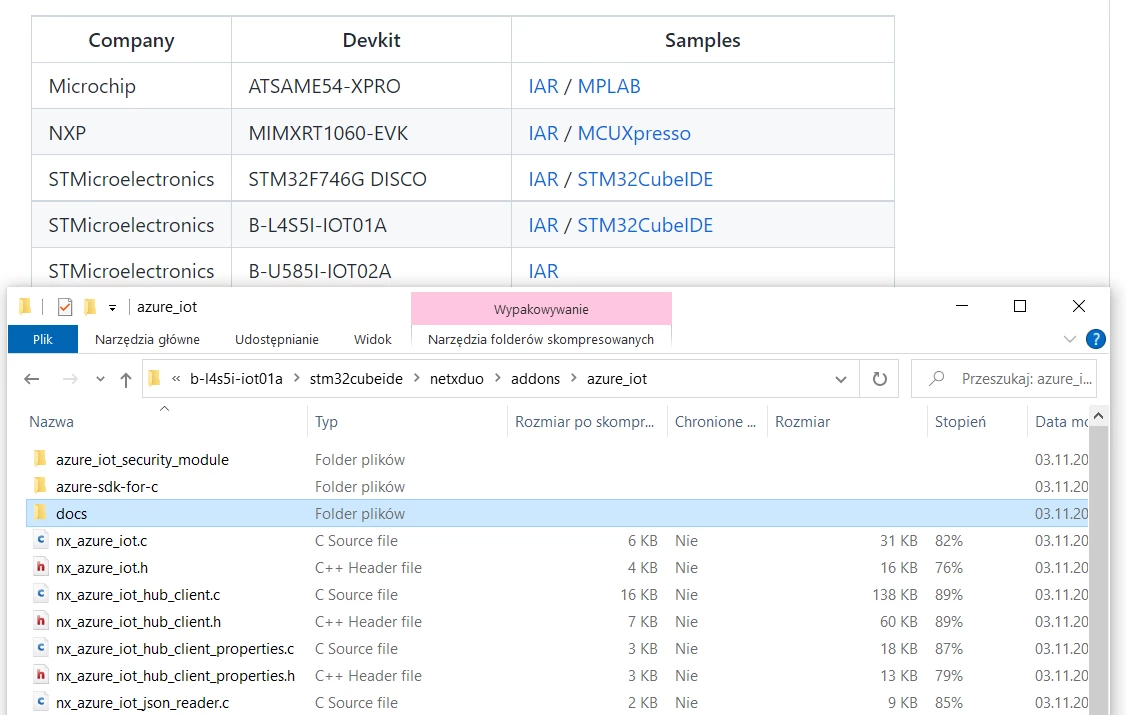

Trouble to implement Azure example for board B-L4S5I-IOT01A to Stm32CubeIDE
Recently I have been trying to implement an example from ST where data is sent telemetry to Azure. The problem is that Stm32CubeIDE did not generate Netxduo / addons / azure_iot. I am trying to manually add this folder but there are a lot of errors regarding includes and in the example I do not see these folders and files, although in some files they have #include "nx_azure_iot_json_reader.h" which is part of azure-sdk-for-c. If you have any ideas where you need to select somewhere in Stm32CubeIDE to generate this file, please give me advice.
Link to example: https://github.com/azure-rtos/getting-started/tree/master/STMicroelectronics/B-L4S5I-IOT01A
Stm32CubeIDE version: 1.8

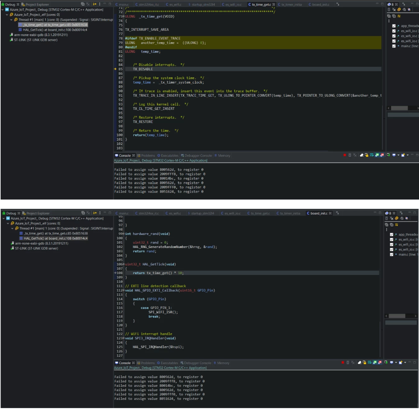

i copied files from this project: https://github.com/azure-rtos/getting-started/tree/master/STMicroelectronics/B-L4S5I-IOT01A so i trust that the project is without errors.
The problem seems to be related with SysTick.

Mar 30, 2022 8:03 AM UTC
Haithem Rahmani
Mar 30, 2022 1:01 PM UTC
First of all could you check that the WiFi module is correctly working, try the example below.
https://github.com/STMicroelectronics/STM32CubeL4/tree/master/Projects/B-L4S5I-IOT01A/Applications/WiFi

Mar 30, 2022 8:54 PM UTC
@Haithem Rahmani​
Okey so i fix it and now its working but i have problem with add extra charts with datas from different sensors because a little bit don't understand code. If you have some time to explain couple of things how to add extra chart, i will be thankful

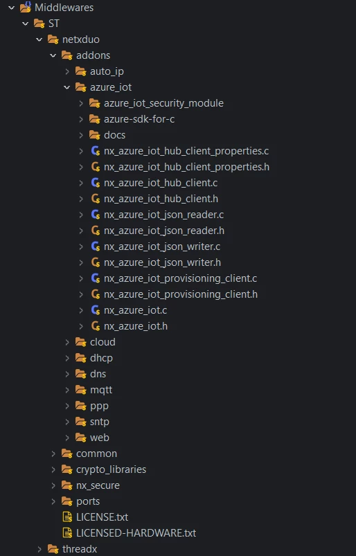

@umtkyck​
I had the same issue and I fixed that by adding manually this package. I had a lot of work but I recommend you download one of these package, choose a project to Stm32CubeIDE then find the folder where is azure_iot and finally copy it to your project and add a path to the linker. I believe that this file (azure_iot) is a general file for any microcontroller and you can copy that peacefully and configure on your own. I hope that it will help you
