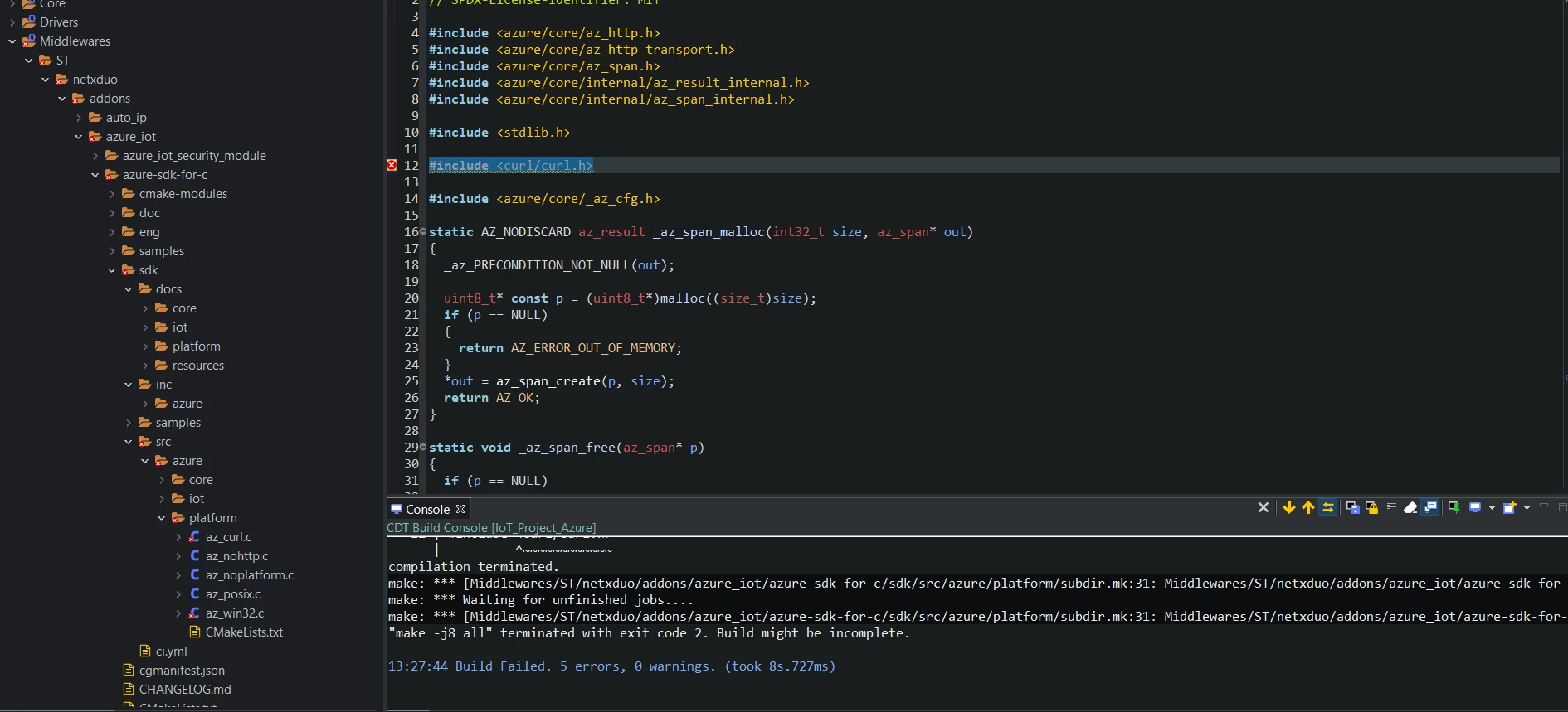

Recently I have been trying to implement an example from ST where data is sent telemetry to Azure. The problem is that Stm32CubeIDE did not generate Netxduo / addons / azure_iot. I am trying to manually add this folder but there are a lot of errors regarding includes and in the example I do not see these folders and files, although in some files they have #include "nx_azure_iot_json_reader.h" which is part of azure-sdk-for-c. If you have any ideas where you need to select somewhere in Stm32CubeIDE to generate this file, please give me advice.
Link to example: https://github.com/azure-rtos/getting-started/tree/master/STMicroelectronics/B-L4S5I-IOT01A
Stm32CubeIDE version: 1.8

0693W00000LvqLYQAZ.pngFor now i have problem with these two file which have:
#include <curl/curl.h>
#include <windows.h>
I don't know why Stm32CubeIDE don't generate azure_iot folder so i have to put it manually. if you have idea where i need to select in Stm32CubeIDE option which allows to generate this folder

Have a look at this microsoft package it offers applications the azure_iot for B-L4S5I-IOT01A board.
there your can notice the relevant files imported from the sdk_iot.
hope this helps.

Oo thanks it will be very helpful, tonight i will try something with this. if it will work properly i will annouce here

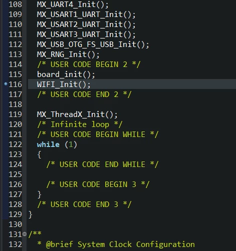

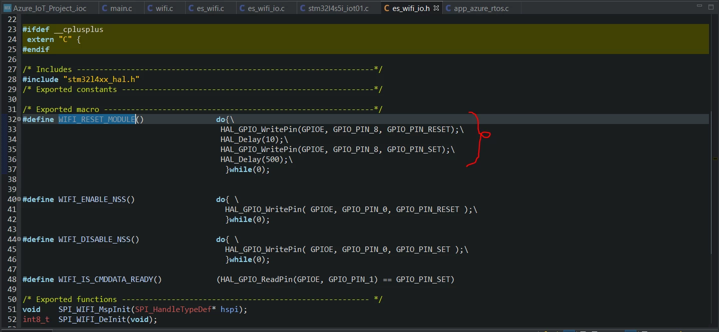

I got a problem with porting example project to my new. This problem is related with SysTick because program is going to infinite loop when i click step over before func HAL_Delay(value); I was trying to change SysTick timer to another timer but it given worse result. If you have some free time and you can help me with that i will really thankful. Below is screen with where is the problem and i attach zip file with my project.

there are 3 common use cases for this problem
  • the SysTick is being used by both RTOS & HAL IP driver
keep the Systick for the RTOS and select another timer for the HAL (TIM6)
  • The HAL_Delay is called in an interrupt context (WIFI_REST_MODULE() )
The HAL_Delay won't run because the SYSTICK_PRIORITY is usally less than the current interrupt no preamption is possible.
you'll need to call the "WIFI_REST_MODULE" outside the interrupt mode.

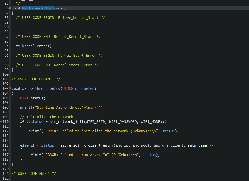

  • The WIFI_REST_MODULE() is called while the RTOS is not yet initialized
the THREADX is disabling the interrupts while initializing thus you'll need to call the WIFI_REST_MODULE either before the tx_kernel_start() or
in a thread entry function.
hope this helps.

Okey so i set SysTick on TIM6 and i tried wifi init before tx_kernel_start() and in thread entry function and this is not work. Do you have any ideas why? or Can you possibly debug the project which i sent in prev message?
