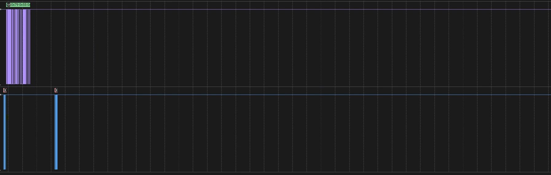

I am testing the System Memory UART protocol in STM32G070CB.

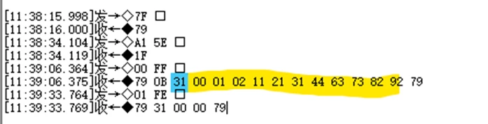

I tried the Get command, the Go command, and the Read Memory command standalone, all success.
However, when I try to execute the Read Memory command, which is successful, and then execute the Read Memory command, the ST does not send any response.

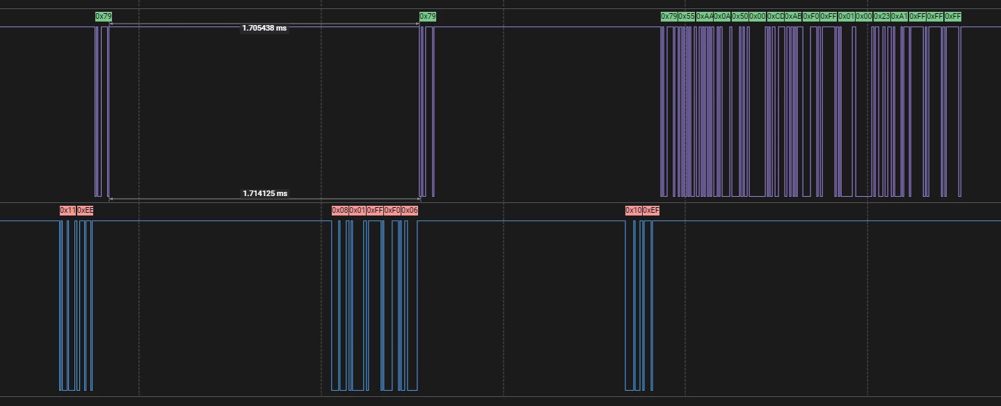

Full pattern:

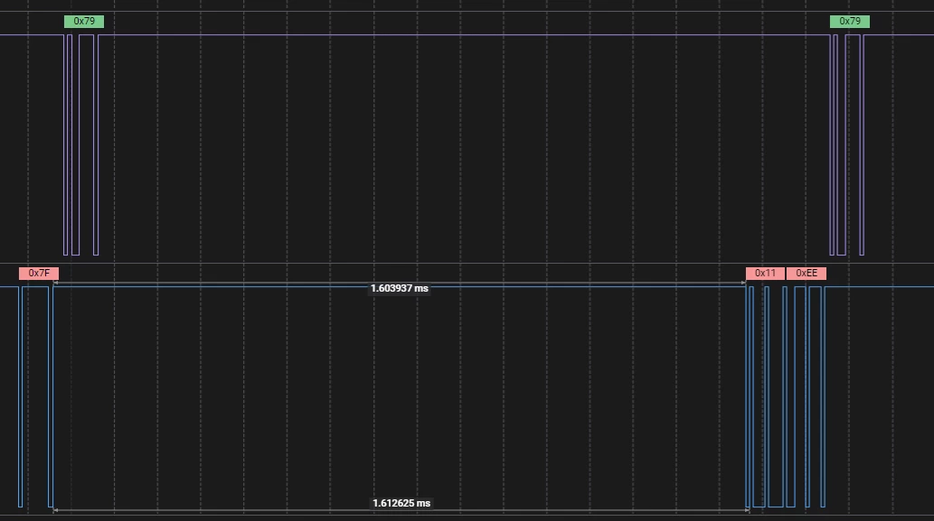

Successful Enter Boot Mode:

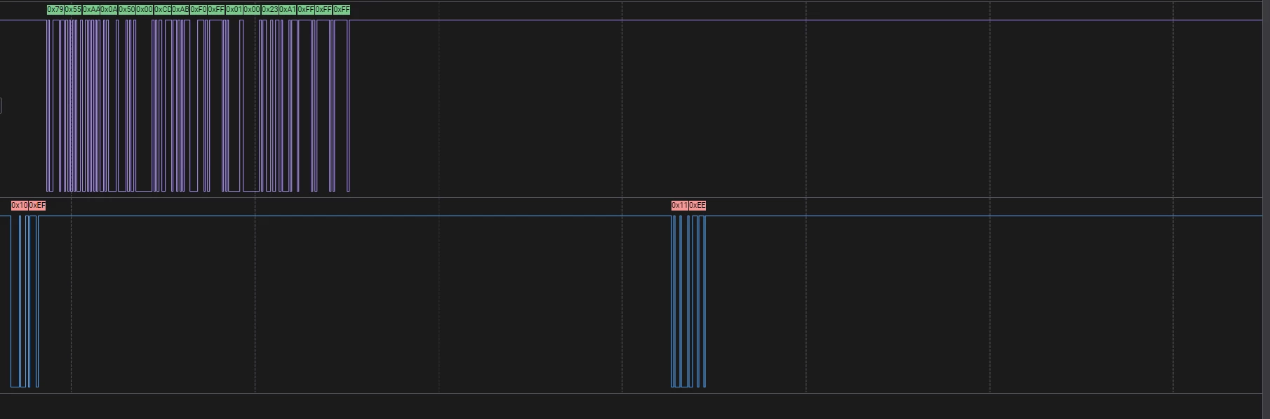

Read Memory CMD with Address = 0x0801FFF0 and read data size is 0x10
Try to execute the Read Memory CMD again but without ACK/NACK
As I know, the protocol is able to execute other CMD when the pervious CMD completed or Failed.
How could I execute CMD continuously?
Note: UART Protocol version of the MCU is V3.1

Yes, the fail case is reading the last 16 Bytes of Data of the Image (128K Bytes Flash, start address: 0x08000000, read Address: 0x0801FFF0)
I reviewed the issue caused by the WRONG data size. I tried to read 16 Bytes of the last of the image, but I input 0x10 instead of 0x0F (N-1).
Now, it could execute other commands when the Read Memory command is completed.
