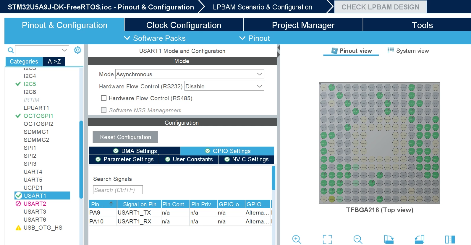

I am using the STM32U5A9J-DK for a UART communication test, and I expect to display the content sent from the computer's Serial port on the screen (textArea).
I'm using UART1, 115200 Baud rate, 8 data bits, 1 stop bits, and I've turned on the UART interrupt, but for some reason the text on the screen doesn't change.
There are not many examples that I can find, so I hope someone can help me to clear this up!
Here is my code

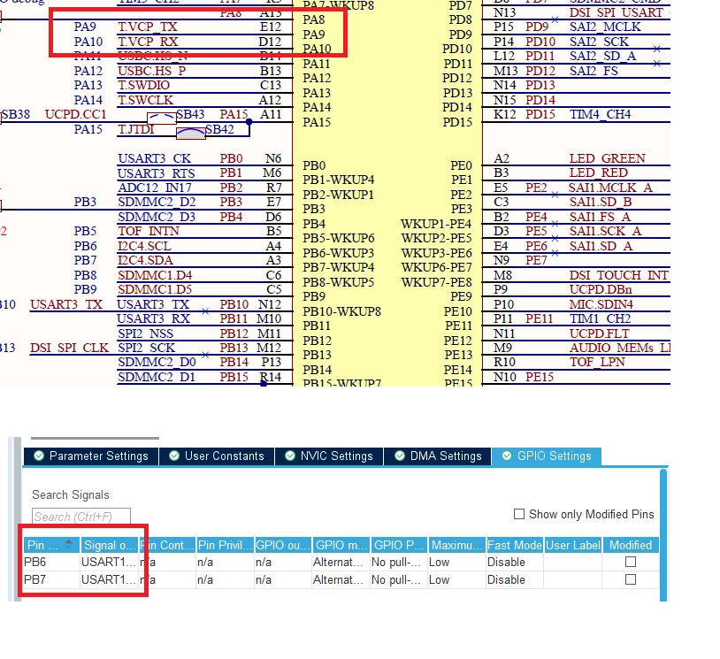

Hello @jessie_chiu ,
you are sharing the IOC file and it seems like you are not using the correct pins for UART communication . the UART instance connected to VCP (virtual com port)of STlink is UART1 on pins PA8 and PA9. check you configuration to make sure you are using the correct pins and if you are using printf to display the text make sure you are correctly surcharging it .

Thank you for your reply. I didn't notice the pin problem!!
But after I fixed the pin define, I still don't get the message.
Do you have any other suggestions?

As stated by @STea you're not assigning the correct IOs for UART1 to connect it to VCP:
So replace PB6 by PA9 and PB7 by PA10 in CubeMx.
