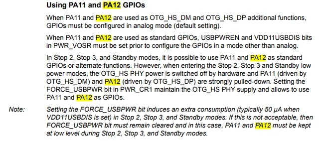

Hello @Yang Yang @Elatewendy
According to the part 10.7.12 of the RM0456, "When PA11 and PA12 are used as standard GPIOs, USBPWREN and VDD11USBDIS bits in PWR_VOSR must be set prior to configure the GPIOs in a mode other than analog".
Best Regards.
STTwo-32
Best Regards.
STTwo-32

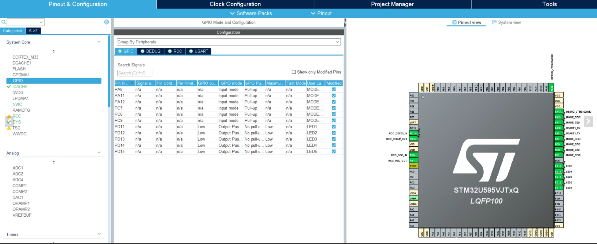

February 23, 2024
hello,@STTwo-32.
I asked the same question at https://community.st.com/t5/stm32-mcus-products/stm32u595-used-pa12-and-pa11-as-input-gpios-can-t-get-the-high/td-p/635837 .
I made a mini project to read the registers.The GPIOA register are ZERO...
The result like as:
HW VERSION 001001
reg_pwr_init = 0x7c000
reg_pwr = 0x2fc000
reg_gpioa = 0x6700
#define HW_BIT0 HAL_GPIO_ReadPin(GPIOC, GPIO_PIN_7)
#define HW_BIT1 HAL_GPIO_ReadPin(GPIOC, GPIO_PIN_8)
#define HW_BIT2 HAL_GPIO_ReadPin(GPIOC, GPIO_PIN_9)
#define HW_BIT3 HAL_GPIO_ReadPin(GPIOA, GPIO_PIN_8)
#define HW_BIT4 HAL_GPIO_ReadPin(GPIOA, GPIO_PIN_11)
#define HW_BIT5 HAL_GPIO_ReadPin(GPIOA, GPIO_PIN_12)

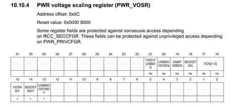

	reg_pwr_init = READ_REG(PWR->VOSR);
	SET_BIT(PWR->CR1 , PWR_CR1_FORCE_USBPWR);
	SET_BIT(PWR->VOSR, (PWR_VOSR_USBPWREN | PWR_VOSR_USBBOOSTEN));
	SET_BIT(PWR->VOSR, PWR_VOSR_VDD11USBDIS);

	reg_pwr = READ_REG(PWR->VOSR);

And the gpios configured like this:
