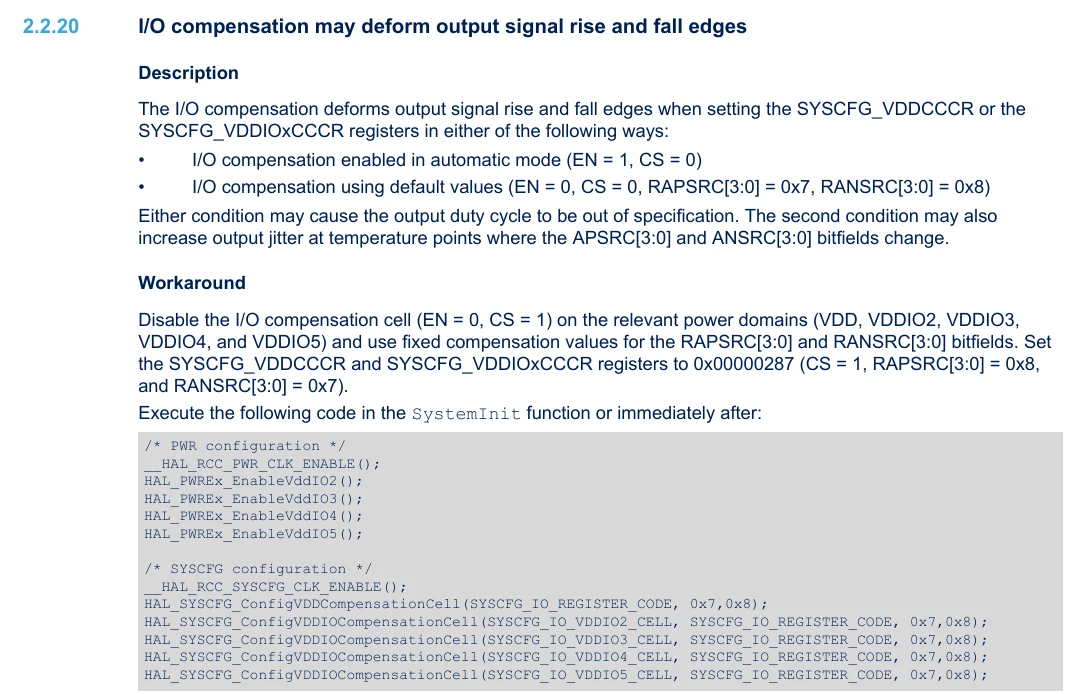

Sep 28, 2026 1:35 PM UTC
I managed to make it work.
So even that OPT124 was set at 0x00018000 (VDDIO2 and VDDIO3 at 1.8V), PWR->SVMCR3  register Bit 26 VDDIO3VRSEL and Bit 25 VDDIO2VRSEL were set at 0. After configuring them with:
PWR->SVMCR3 |= PWR_SVMCR3_VDDIO3VRSEL;
PWR->SVMCR3 |= PWR_SVMCR3_VDDIO2VRSEL;
200MHz started working.
Big help was this thread
Also, errata issue about I/O compensation, workaround is implemented in the latest N6 HAL lib.
Thank you for your engagement.

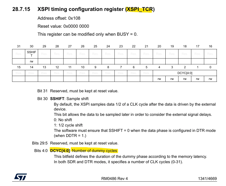

Hello ​@GoranDragovic ;
You can check the number of dummy cycles in XSPI_TCR register CCYC[4:0] bits.
Are you able to run these examples STM32CubeN6/Projects/NUCLEO-N657X0-Q/Examples/XSPI?
Thank you.

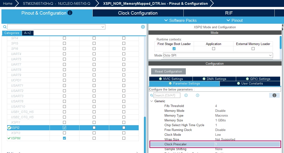

Sep 14, 2026 9:08 AM UTC
Okay, first of all, thank you for your engagement.
I ran XSPI_NOR_MemoryMapped_DTR example, and it is blinking GREEN, but weird part is CLK 200Mhz but Dummy Cycles set to 6, while the MX25 chip datasheet clearly says it should be 20. Also this RUNS code from RAM, it doesn’t to XIP as my code does.
After that I ran my code that uses EXT_MEM, and with 80Mhz, it sets Dummy cycles to 20 in FSBL, after jump to APPLI, it sets dummy cycles to 10.
Later I set it to 200Mhz, and Dummy are still at 20 but, it fails to jump from FSBL to APPLI.
So I think it’s probably something with XIP handoff.
KDJEM.1
Sep 21, 2026 10:58 AM UTC
Hello ​@GoranDragovic;
For XSPI_NOR_MemoryMapped_DTR example, the XSPI  clock is 100MHz not 200MHz.
The Clock Prescaler = 1 → The prescaler is used to divide the source clock of the XSPI peripheral (f_) to obtain a frequency compatible with the external flash.
The formula is: f_CLK = f_Kernel/Prescaler+1
Where:
  • f_CLK = frequency applied to the memory on the XSPI lines
  • f_ Kernel= clock frequency provided to the XSPI peripheral by the MCU
→ Could you please check the frequency and the dummy in XSPI registers and share values?
Thank you.
Kaouthar

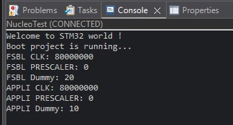

Sep 21, 2026 12:35 PM UTC
Okay, I will give you snippets.
This is the FSBL part of the code:
/* USER CODE BEGIN BSP */
/* -- Sample board code to send message over COM1 port ---- */
printf("Welcome to STM32 world !\n\rBoot project is running...\n\r");
/* -- Sample board code to switch on leds ---- */
BSP_LED_On(LED_BLUE);
BSP_LED_On(LED_RED);
BSP_LED_On(LED_GREEN);
CLK = HAL_RCCEx_GetPeriphCLKFreq(RCC_PERIPHCLK_XSPI2);
PRESCALER =
(XSPI2->DCR2 & XSPI_DCR2_PRESCALER_Msk)
>> XSPI_DCR2_PRESCALER_Pos;
printf("FSBL CLK: %lu \r\n", CLK);
printf("FSBL PRESCALER: %lu \r\n", PRESCALER);
printf("FSBL Dummy: %lu \r\n", XSPI2->TCR);
/* USER CODE END BSP */
/* Launch the application */
if (BOOT_OK != BOOT_Application())
Error_Handler();
/* Infinite loop */
/* USER CODE BEGIN WHILE */
while (1)
/* USER CODE END WHILE */
/* USER CODE BEGIN 3 */
/* USER CODE END 3 */
It’s similar with APPLI too and there is response in the picture attached at the bottom when CLK is 80 MHZ.
When I switch CLK to 200Mhz, it fails to jump to APPLI
KDJEM.1
Sep 25, 2026 3:51 PM UTC
Hello ​@GoranDragovic ,
I’m waiting for registers values.
Also could you please look at the errata sheet and try to disable the I/O compensation cell (EN = 0, CS = 1) on the relevant power domains (VDD, VDDIO2, VDDIO3, VDDIO4, and VDDIO5) and to use fixed compensation values for the RAPSRC[3:0] and RANSRC[3:0] bitfields.
Thank you.
Kaouthar
Sep 25, 2026 5:42 PM UTC
Values are in the attachment from the answer above. This is the values that are displayed.
PRESCALER = (XSPI2->DCR2 & XSPI_DCR2_PRESCALER_Msk) >> XSPI_DCR2_PRESCALER_Pos;
