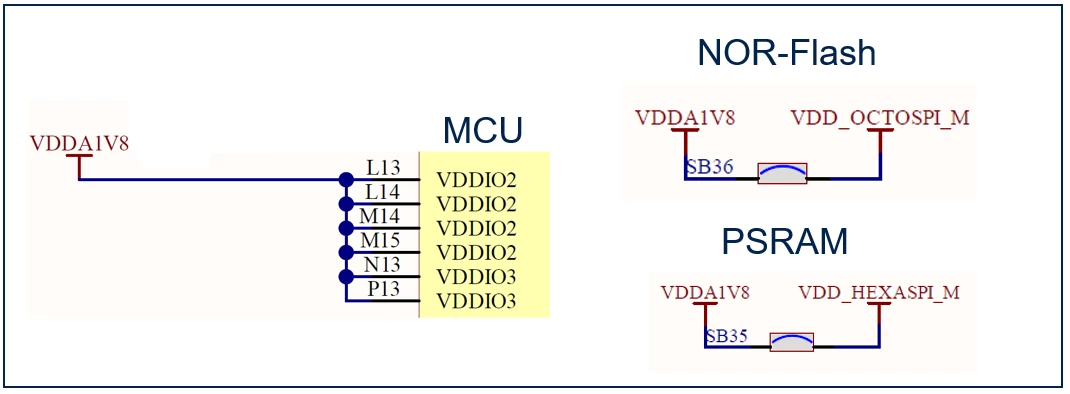

The STM32N6570-DK uses external memories at 1.8 V voltage and relevant I/Os should be configured from the 3.3 V default using firmware or software and OTP to get nominal speed.
Be aware that setting HSLV_VDDIOx and VDDIOxVRSEL bits while VDDIOx is in the 3.3 V range damages the device.
The relevant power supply connection on the discovery kit hardware is shown below:
This means that:
  • XSPIM_P2 NOR-Flash (8-bit) → VDDIO3
  • XSPIM_P1 PSRAM (16-bit) → VDDIO2

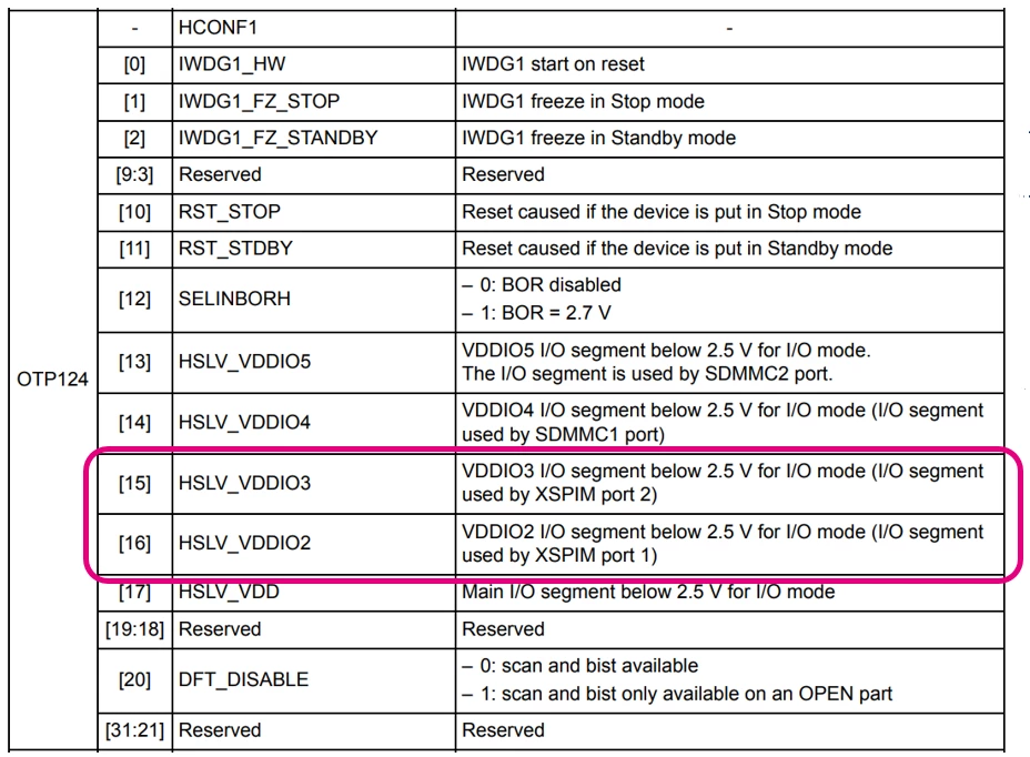

The OTP124 bits reflect the I/O domains voltage levels, as shown in the reference manual’s table:

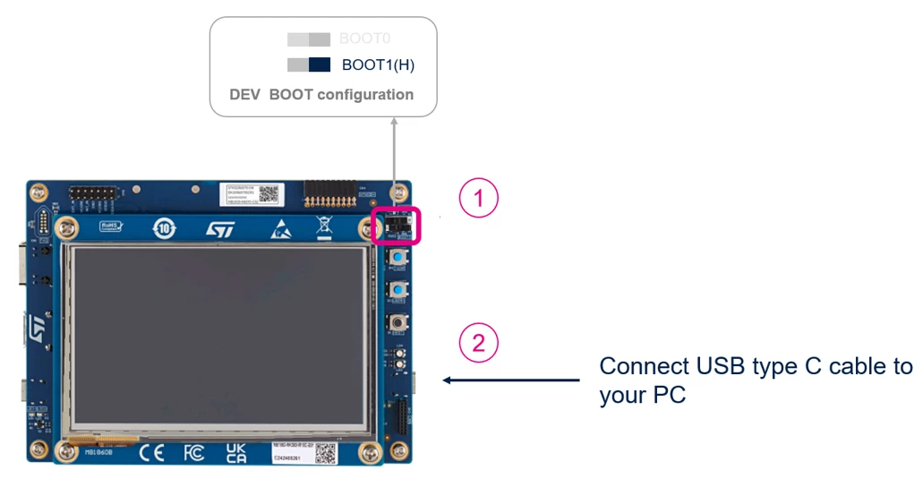

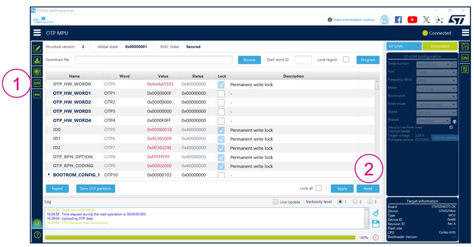

The board should be in Dev Mode to allow it to connect to the STM32CubeProgrammer and program the board. To ensure that the board is in Dev Mode, follow these steps:
  1. Set the BOOT configuration to DEV BOOT by setting BOOT0 to LOW and BOOT1 to HIGH.
  2. Connect the USB Type-C® cable to your PC.

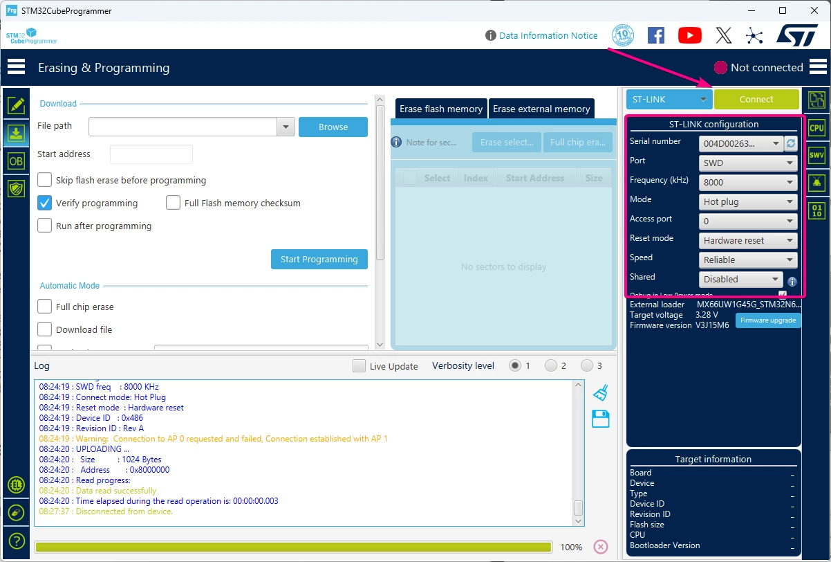

Once connected to the USB, open STM32CubeProgrammer and click [Connect]:

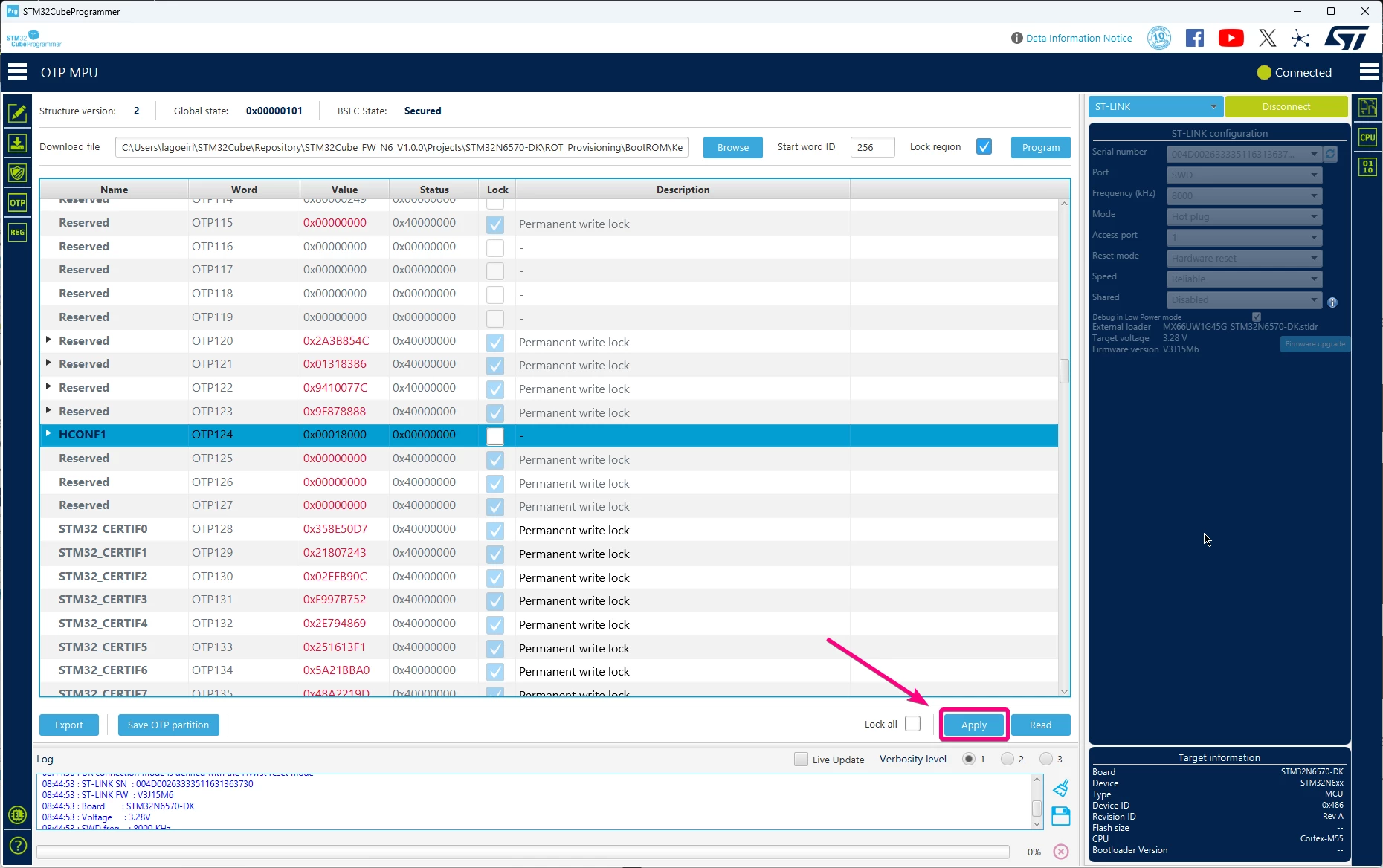

Now, go to the OTP tab and click on the [Read] button to refresh all values.
After that, edit the OTP124 (HCONF1) to be 0x0001 8000, setting the HSLV_VDDIO3 (bit 15) and HSLV_VDDIO2 (bit 16) to 1.
Click on [Apply] to update the OTPs modification.

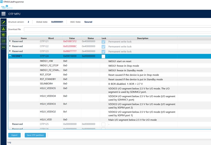

That concludes our example for STM32CubeProgrammer portion. Now, you can read again the OTPs to verify if the OTP124 has changed.

Slightly confusing because on my DK the HSLV_VDDIO2 and 3 OTP bits are already set. Fancy graphics demo that was on board must have used external PSRAM and Flash at high speeds also.
Will_Robertson
Jan 8, 2026 3:10 PM UTC
Hi @Mikk Leini ,
Thank you very much - that's a good point - just checked them on my board and HSLV_VDIO3 and HSLV_VDIO2 are both set to 0x1 there as well - it looks like you're right - the demo that comes with the board or the STM32N6-GettingStarted-ObjectDetection example must set them. The STM32N6-GettingStarted-ObjectDetection certainly makes use of a large double buffer in PSRAM for the foreground and I'd guess that the demo that comes with the board also makes heavy use of PSRAM.

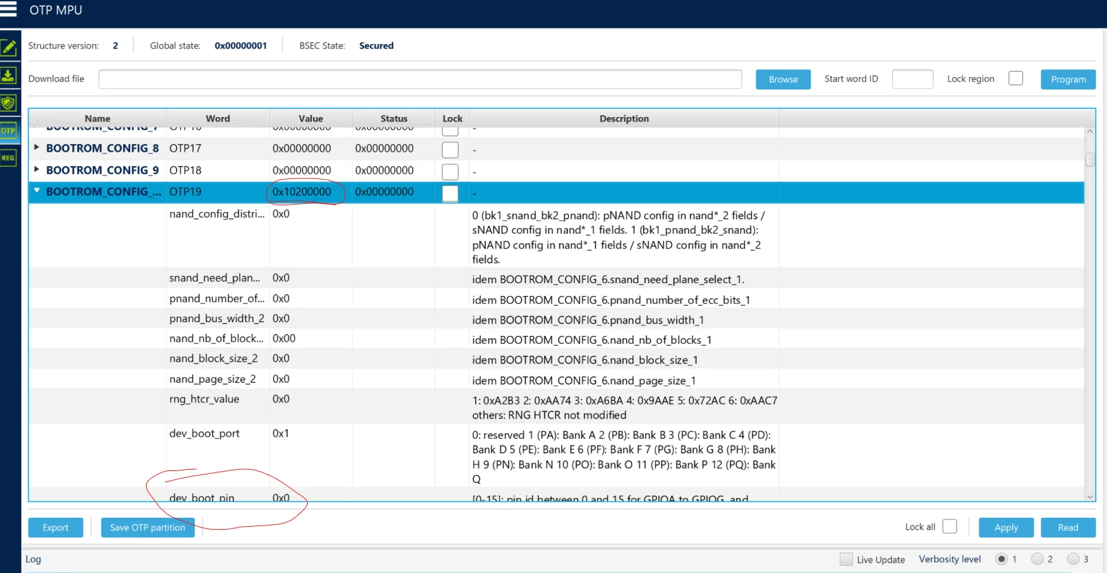

Visitor II
Jan 12, 2026 2:34 AM UTC

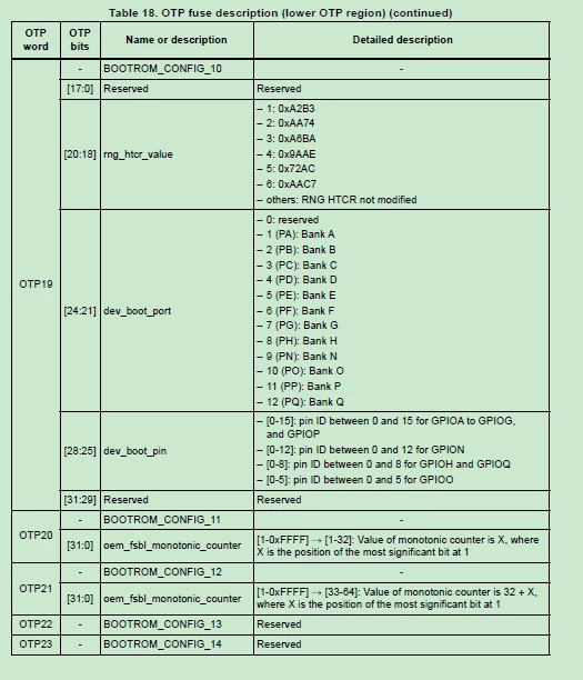

Hi B.Montanari,
Thanks for your detail description about OTP operation. On our own PCBA , we use STM32N657L0. Now I try to modfiy OTP19 to config PA8 as BOOT1 pin , becasuse PA6 (default pin) used as SPI6_MISO,I use STM32cubeProgrammer to operate OTP19.
According to spec as below: i calculate OPT19   0x1020 0000
Bit Field (Bits) Name Value Remarks
[17: 0]Reserved All reserved bits must be written as 0
[20:18]mg_hicr_value0You did not specify a value. Using the default "others", meaning "RNG HTCR not modified".
[24:21]dev_boot_port11 corresponds to PA (Bank A).
[28:25]dev_boot_pin8For GPIOA, Pin ID 8 directly corresponds to the numerical value 8.
[31:29] Reserved0All reserved bits must be written as 0
but i read OTP19 via STM32cubeProgrammer after configuring OPT19 to 0x10200000, the field dev_boot_pin is still 0 (display). anything wrong ?
Sep 17, 2026 7:44 AM UTC
We were also facing the slimier issue when try to chnage the boot1 pin to PN10
