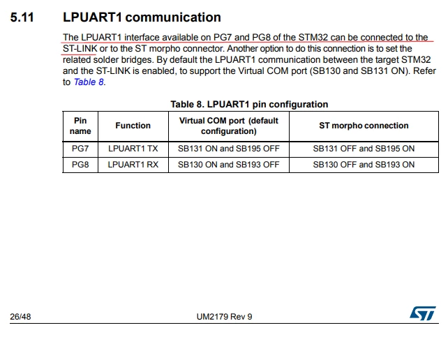

@RiccardoMilici wrote:
3. In Pinout & Configuration I go to Connectivity -> USART2 -> Mode Asynchronous and leave the default values.
User manual says it's LPUART1 connected to the VCP:
https://www.st.com/resource/en/user_manual/um2179-stm32-nucleo144-boards-mb1312-stmicroelectronics.pdf#page=26

@Imen.D wrote:
Check your pins configuration and the USART2 alternate functions on which pins are mapped.
It's LPUART1 - not USART2

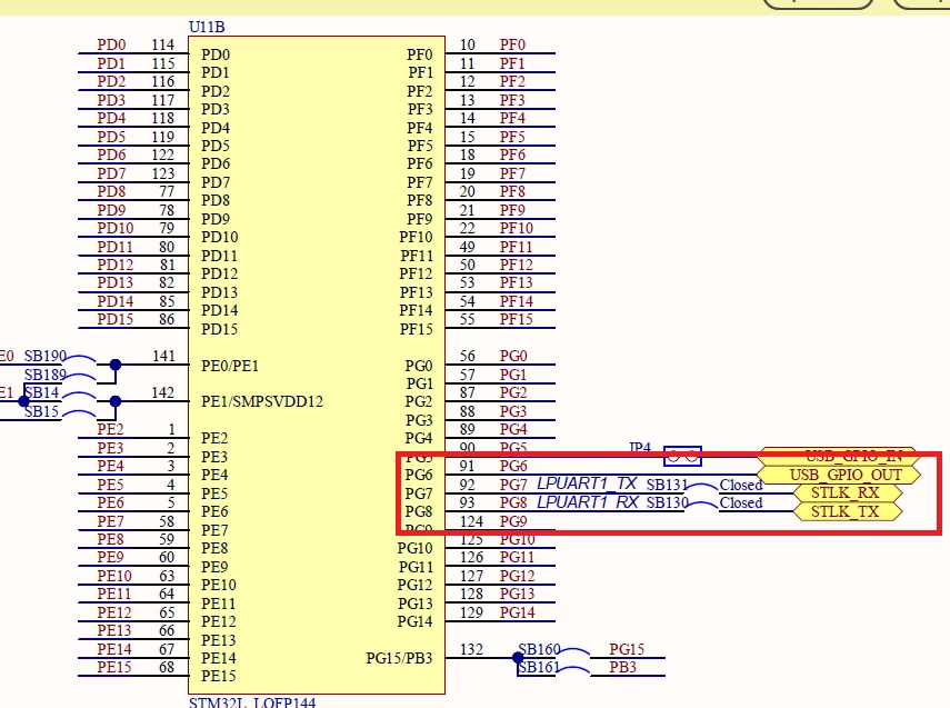

mƎALLEm
Nov 20, 2024 11:53 AM UTC
Simply because USART2 is not connected to STLINK virtual comport on NUCLEO-L496ZG-P board.
Based on the board schematics, you need to use LPUART1 instead:
