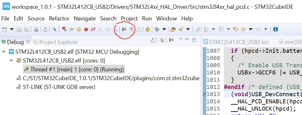

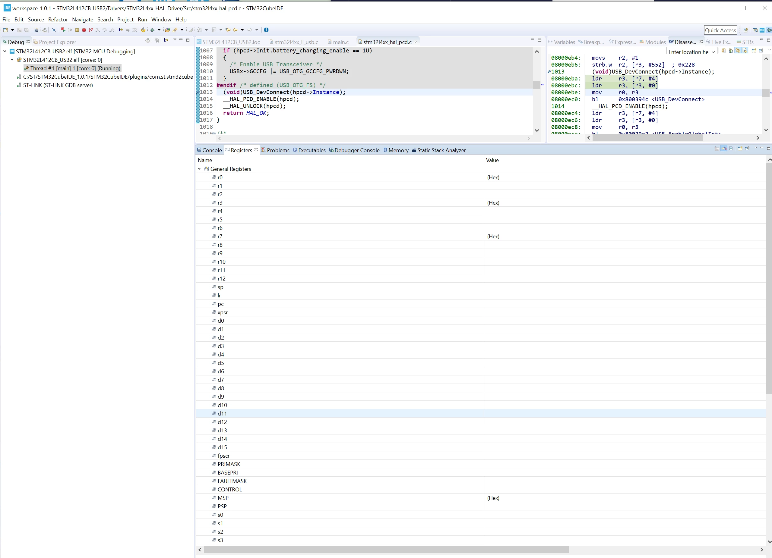

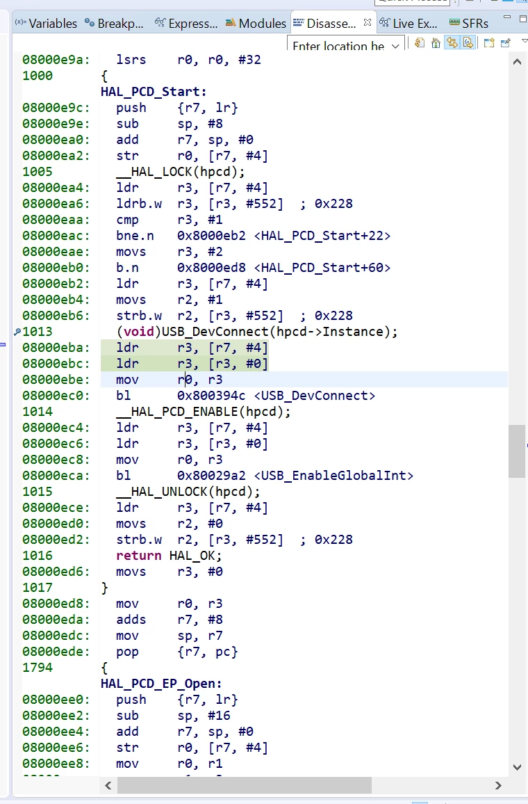

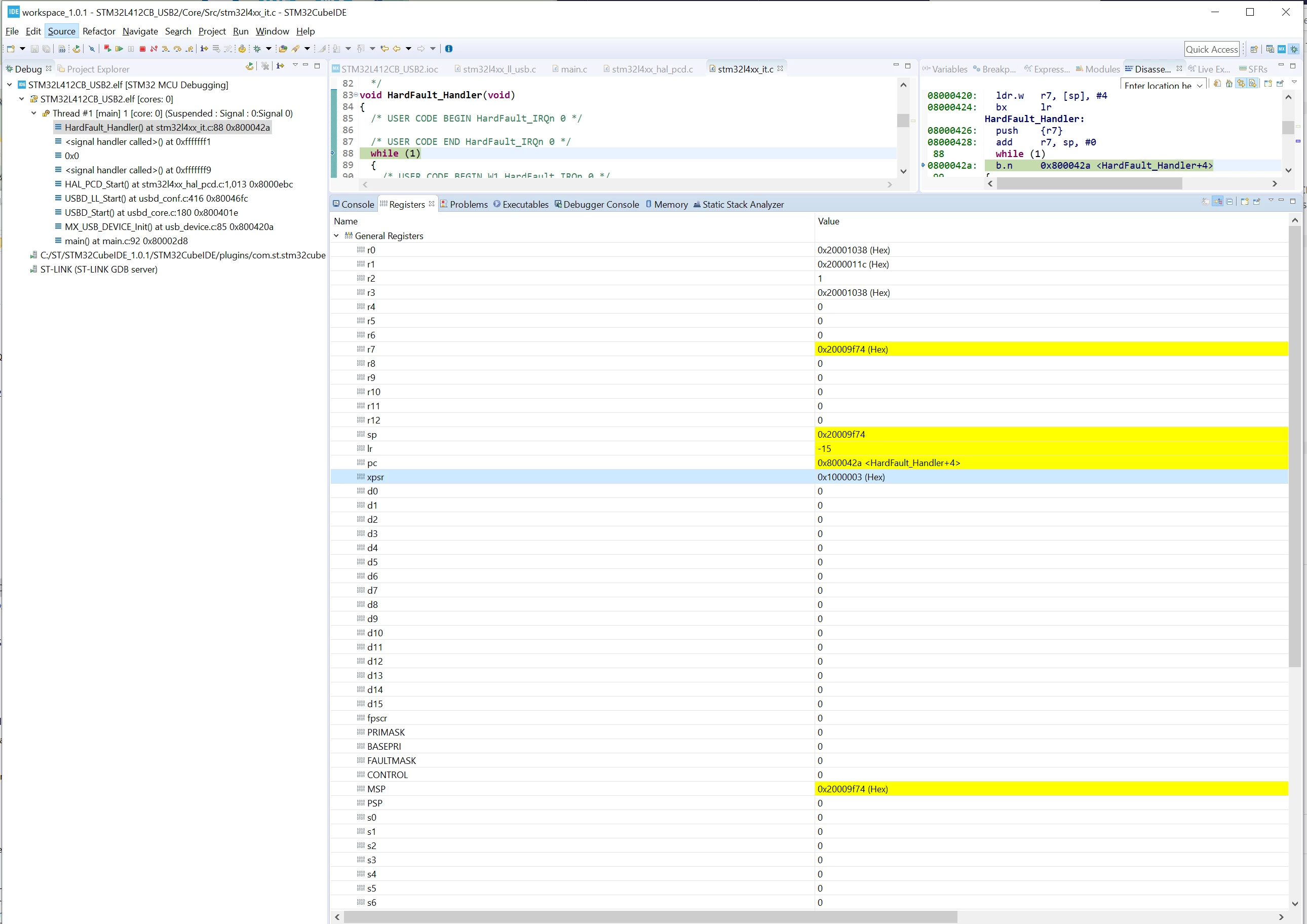

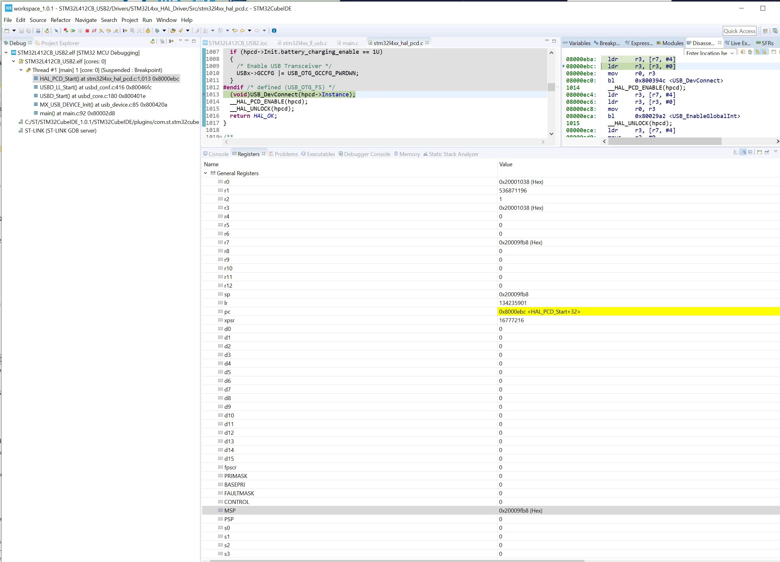

lizerd
Jul 20, 2019 7:48 PM UTC
Hi.
I do not have any way to print the printf output right now.
So I checked with TrueStudio (Stm32CubeIDE)
I have tested this with both Truestudio 9.3 and Stm32CubeIDE with the same result.
I set the breakpoint at the position before the error accrue, and each picture is an step in assembly.
next
next
next
next
Hard fault
and assembly code at the error
0690X000009YwiZQAS.png I do not know ow to follow this, becuas from my perspective it looks well and fine before the error hits.
Hope there is a way to solve this.
btw, Thanks Clive for all your help, indirect (others post) and direct :)
waclawek.jan
Jul 20, 2019 7:59 PM UTC
I'd say, you used "step over" rather than "step into" (I don't use eclipsoids so I don't know exactly which key does what). In other words, IMO you run the USB_DevConnect routine, and failed somewhere there.
Learn how to "step into" and step until the fault occurs.

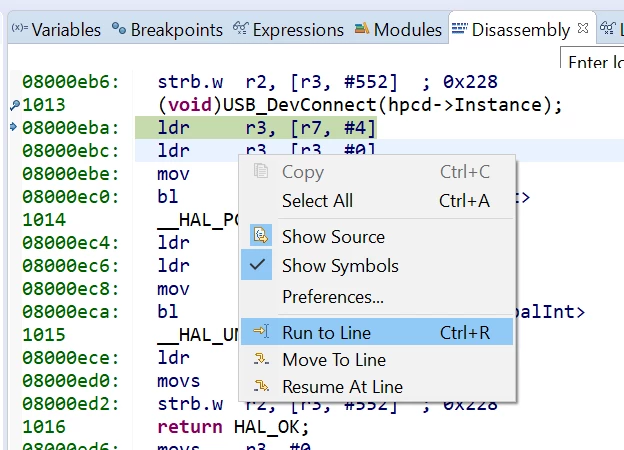

lizerd
Jul 20, 2019 8:53 PM UTC
Hi JW.
I am not a eclips guy my self, so I am no expert.
But I used "run to line" for each "step"
I culd not find another way to do it (Assembly step).

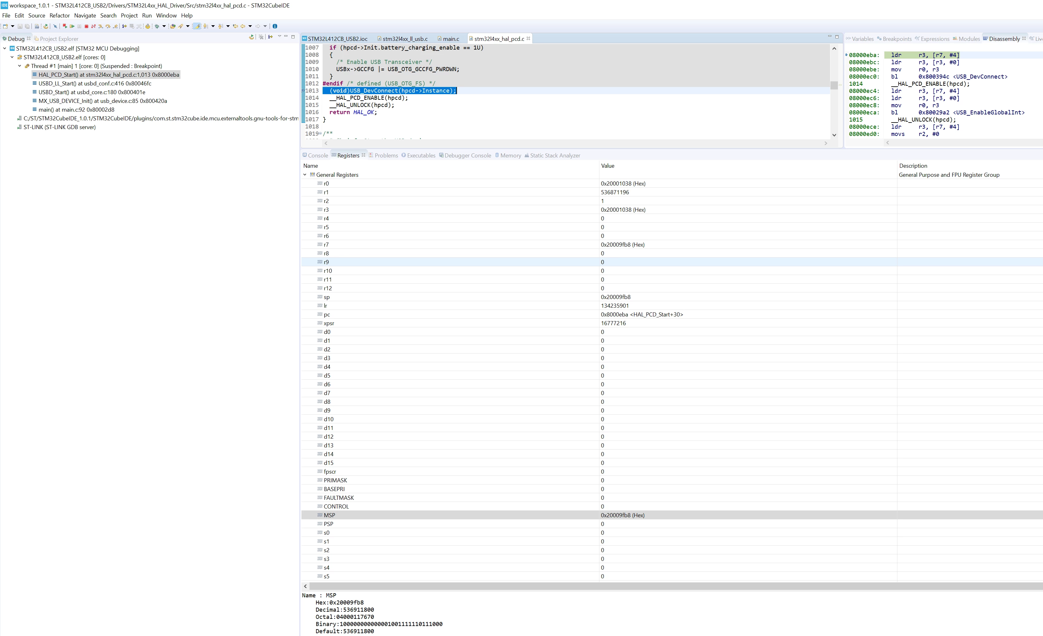

lizerd
Jul 21, 2019 9:43 PM UTC
hi all.
thanks for the hint Jan, but when I do singel step, it works fine until I push resume.
So I can single step trough the whole thing and it is fine, but when I let the processor run freely again it ends up in HardFault.
So I am not any wiser from that unfortunately.
I have really been trying to figure this out, and solve how to implement clive's HardFault data.
What I can not figure out is how to make the compiler/MCU the added HardFualt addition in startup.s

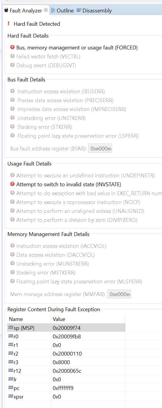

what I found in Truestudio was the problem window.
It reports an hard fault and gives some info, unfortunately I do not understand what it means.
The wired thing is, I downloaded the tryout of Crossworks and it works with the board if I create an MDK-ARM V5 project in CubeMX and import it into crossworks and just run. It works. So there is no problem with the MCU or the board.
