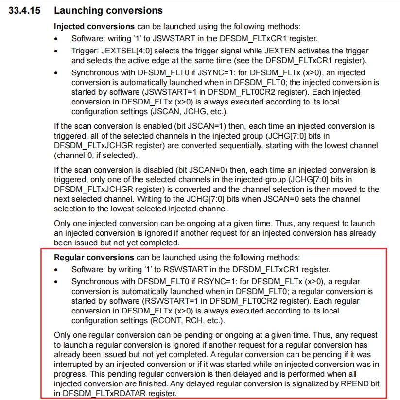

Previously, I used the HAL_DFSDM_FilterRegularStart_DMA method to enable each of the eight filters one by one. The result was a 2.4Mhz clock output, exactly as configured in CubeMX.
Now, to achieve high sync between 8 filters, i referred to the synchronization content in the reference manual(RM0455):
i followed the instruction and programmed as below:

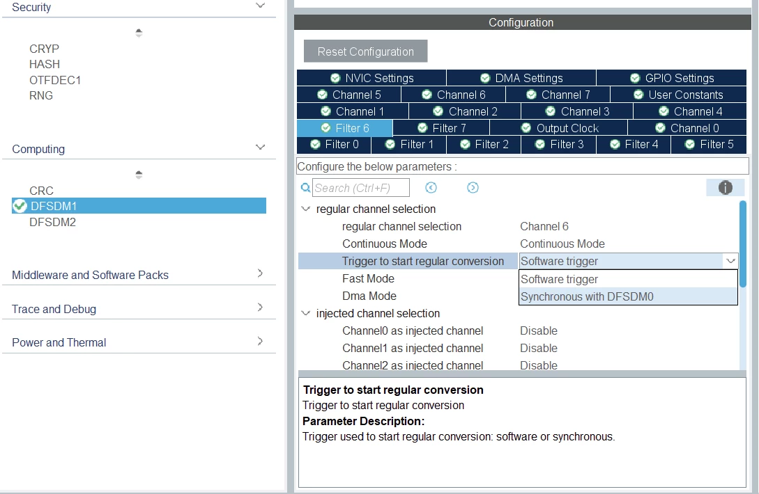

 // Set all 7 RSYNC (let alone filter0)
 hdfsdm1_filter1.Instance->FLTCR1 |= DFSDM_FLTCR1_RSYNC;
 hdfsdm1_filter2.Instance->FLTCR1 |= DFSDM_FLTCR1_RSYNC;
 hdfsdm1_filter3.Instance->FLTCR1 |= DFSDM_FLTCR1_RSYNC;
 hdfsdm1_filter4.Instance->FLTCR1 |= DFSDM_FLTCR1_RSYNC;
 hdfsdm1_filter5.Instance->FLTCR1 |= DFSDM_FLTCR1_RSYNC;
 hdfsdm1_filter6.Instance->FLTCR1 |= DFSDM_FLTCR1_RSYNC;
 hdfsdm1_filter7.Instance->FLTCR1 |= DFSDM_FLTCR1_RSYNC;

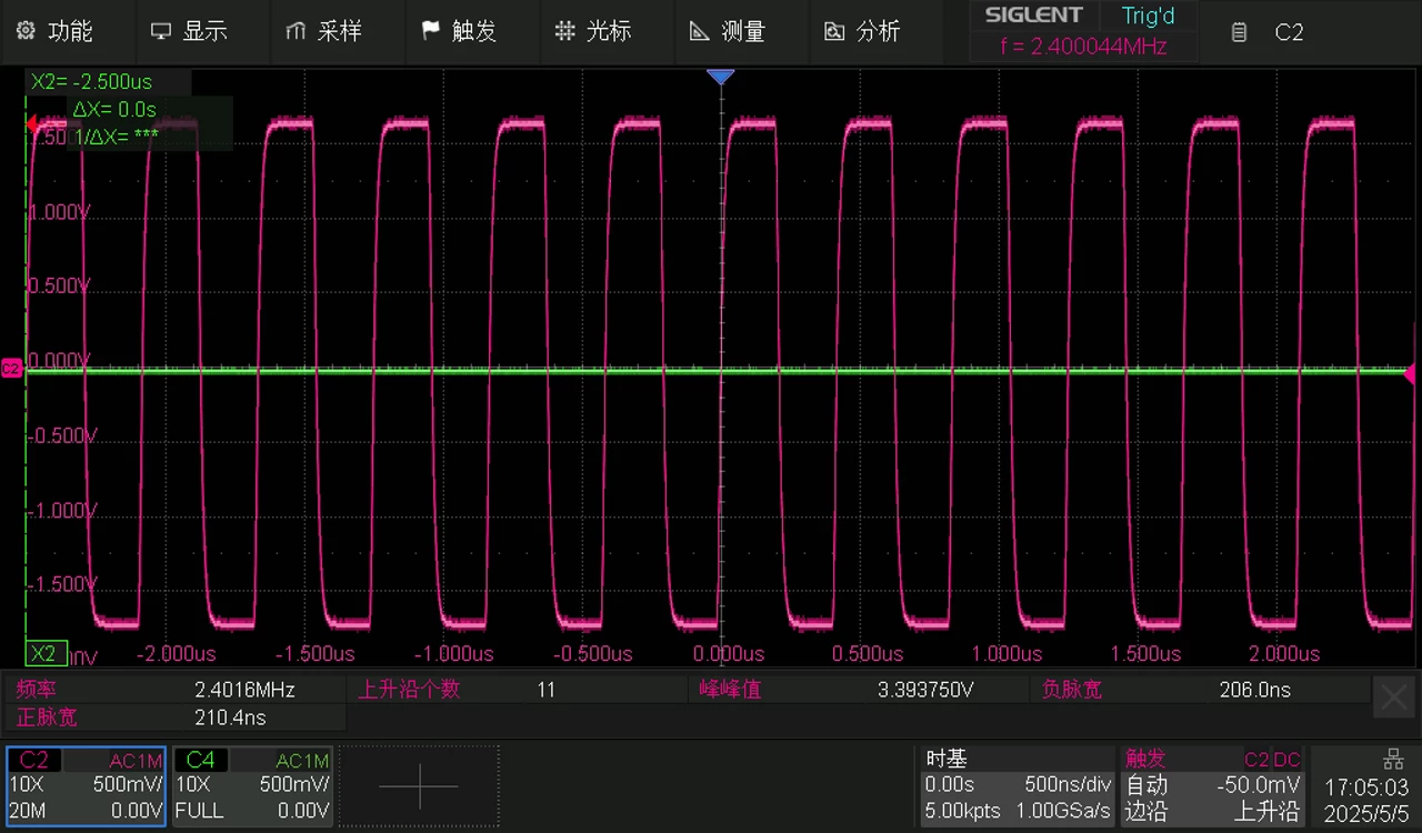

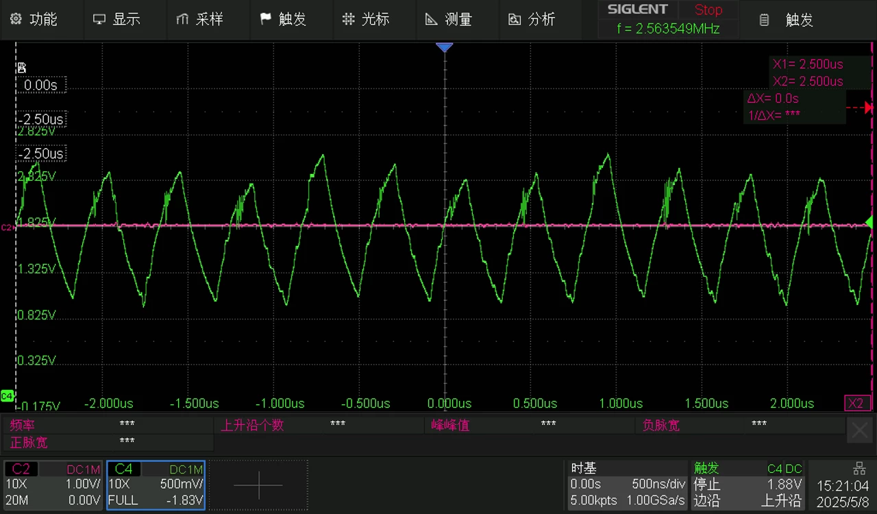

However, when I checked the CLK output, I found that the clock frequency changed to about 3Mhz, varying from 2.6Mhz to 3.0Mhz. See below:
So I tried to debug. When the program ran through DFSDM1_Init(), the 3Mhz clock output emerged, but the waveform was abnormal. Also, after the program ran through WJ_DFSDM_FilterSyncConfig(), WJ_DFSDM_FilterSyncStart(), and hdfsdm1_filter0.Instance->FLTCR1 |= DFSDM_FLTCR1_RSWSTART, the CLK output did not change.
Although it can normally enter the DMA transfer interrupt, this abnormal CLK output indicates a problem. I want to know how to correctly configure the registers to achieve the synchronization of DFSDM1 filter1 - 7 with filter0 as described in the reference manual. Why does the current configuration lead to an abnormal clock waveform? Are there any overlooked details or configurations?

I have implemented the synchronous configuration as your suggested, and it now works properly. However, I discovered an issue with CubeMX during this process:
I used CubeMX to change DFSDM_FILTER_SYNC_TRIGGER to DFSDM_FILTER_SW_TRIGGER , but it seems that CubeMX UI mistaken Filter0 to DFSDM0, it should be " Synchronous with Filter0 ", instead of " Synchronous with DFSDM0 ", as STM32H7B0 doesn't embed a DFSDM0, and " DFSDM0 " was not mentioned in reference manual (RM0455) as well.
Have you encountered similar discrepancies in CubeMX's DFSDM configuration for H7 series devices? It would be helpful to confirm whether this is a known issue or requires a firmware update.
