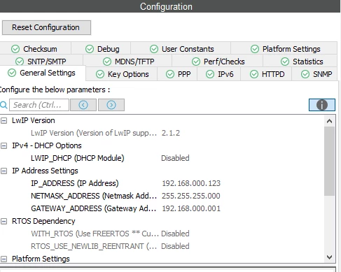

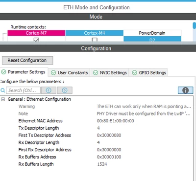

I configured a new project for STM32H745XIH3 with ETH & Lwip
Linker file section related to lwip
.lwip_sec (NOLOAD) : {
. = ABSOLUTE(0x30000000);
*(.RxDecripSection)
. = ABSOLUTE(0x30000080);
*(.TxDecripSection)
. = ABSOLUTE(0x30000100);
*(.Rx_PoolSection)
} >RAM_D2
