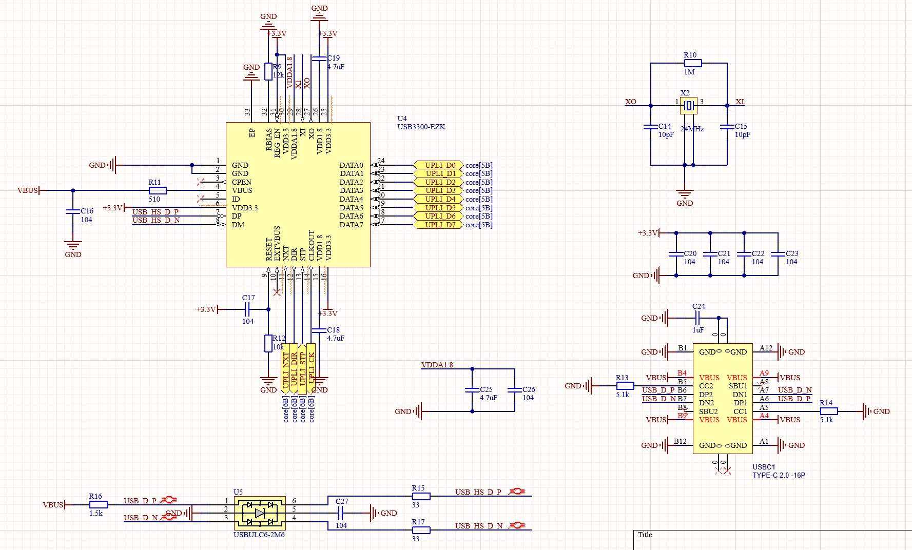

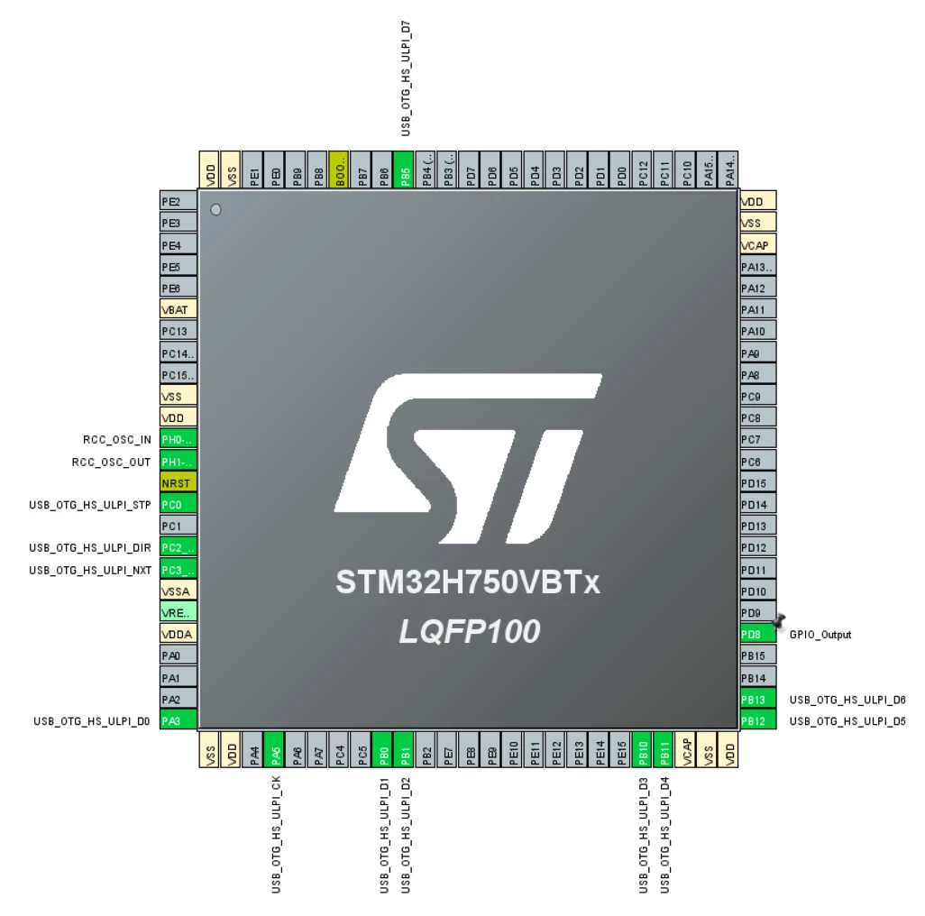

I am using STM32H743VIT6 with USB3300 to develop a HS USB Device.
But the program is always trapped in USB_CoreReset() at
  do
    count++;
    if (count > HAL_USB_TIMEOUT)
      return HAL_TIMEOUT;
  } while ((USBx->GRSTCTL & USB_OTG_GRSTCTL_CSRST) == USB_OTG_GRSTCTL_CSRST);

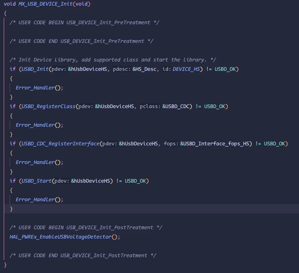

I am using a VCP example generated by CubeMX for testing without any other code.

Hello @sin1111yi  and welcome to STcommunity!
First, you mentioned STM32H743 in the thread title, but the pinout view shows STM32H750. Can you clarify which STM32H7 device you are using?

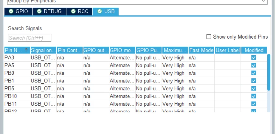

Can you verify that the ULPI pins output speed are configured to very high speed in your .ioc file?
BR

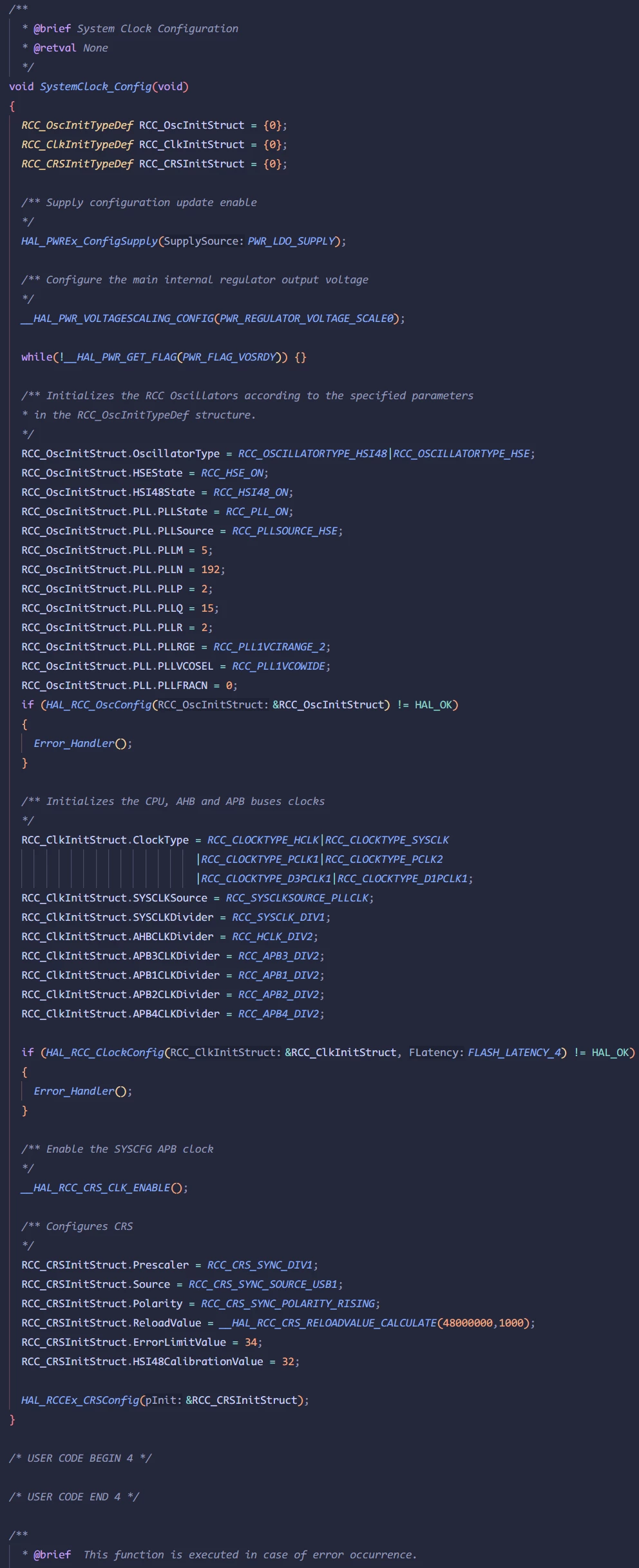

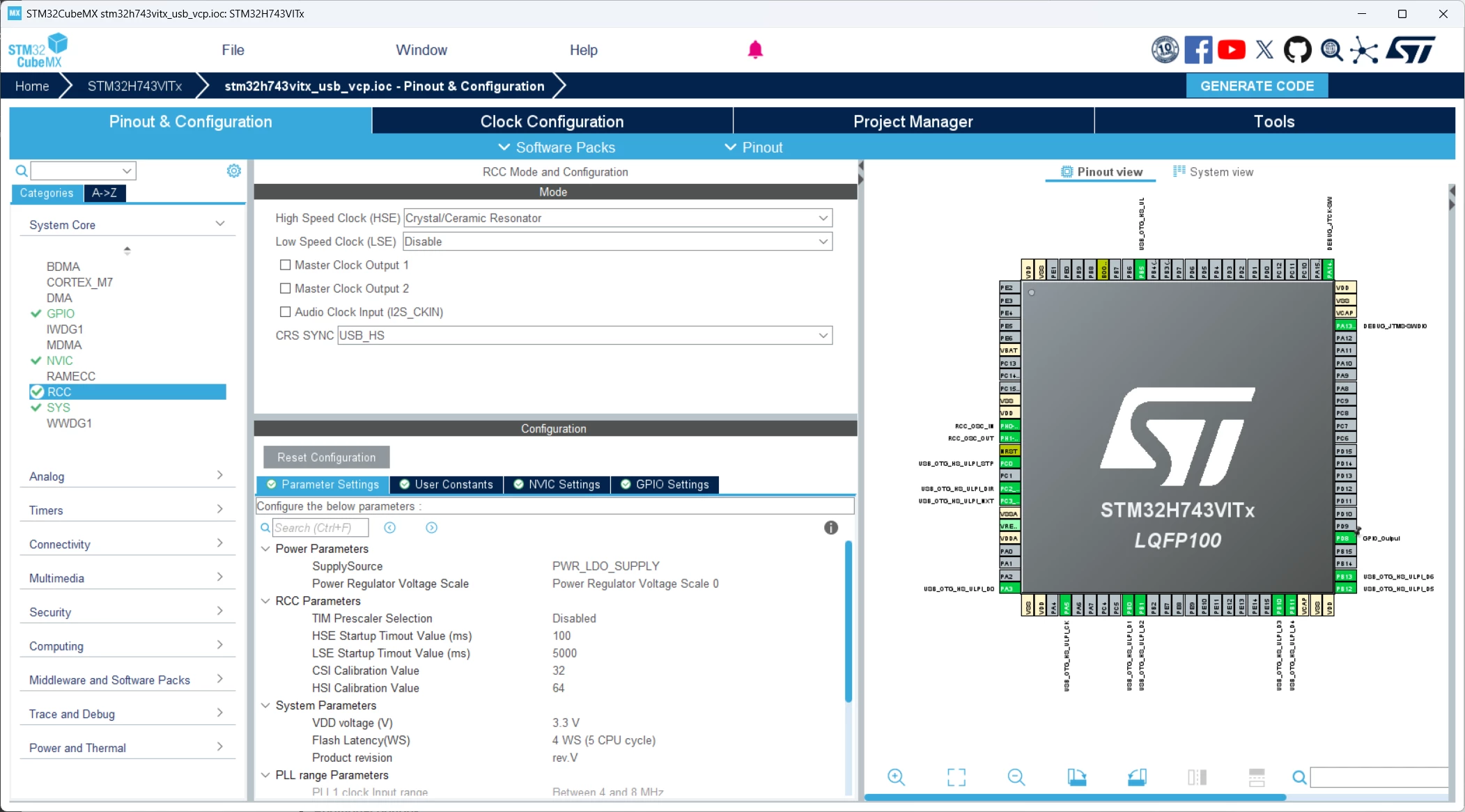

sin1111yiAuthor
Feb 6, 2026 13:36 UTC
Thanks for your relay!
I have already checked my configurations and then corrected device selection, set all USB GPIOs speed to very high speed and set CRS SYNC source to USB HS. But the problem is still existed.

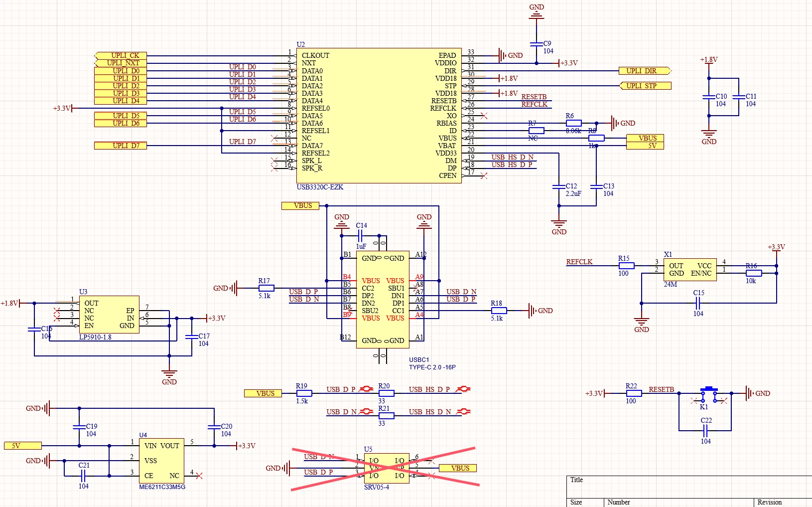

I tried to use USB3320 like STM32H7xxI-Eva before, which have the same problem.
My USB HS related code is all generated by STM32CubeMX and nothing changed, just like the USB HS Device + ULPI examples.

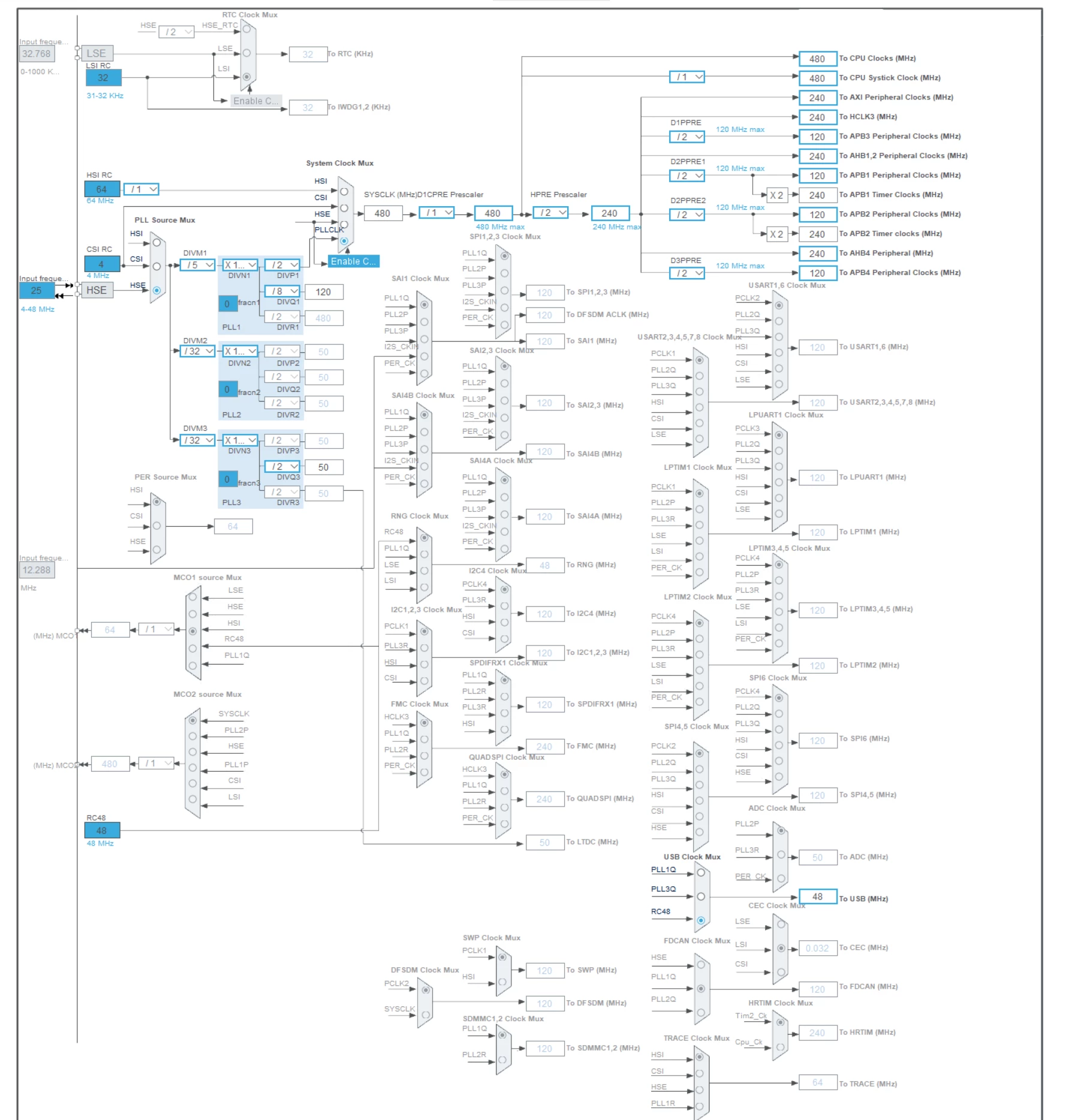

Here's my clock configuration, generated by STM32CubeMX.
sin1111yiAuthor
Apr 9, 2026 09:33 UTC
All problem are disappeared after I made the ULPI data cable of equal length. Besides, I use PLLQ 60MHz for HS USB.
