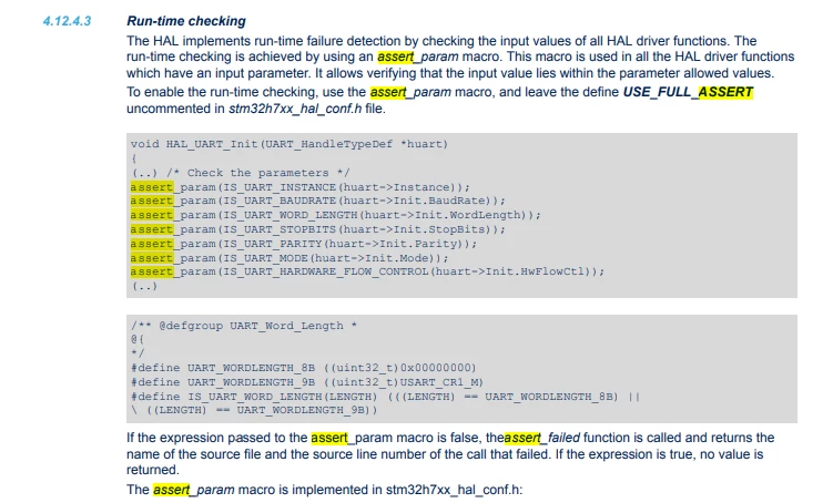

Feb 13, 2025 1:24 PM UTC
Hello @Danish1
>> But it now gives wrong results for RCC->D1CFGR fields D1CPRE and HPRE as used by HAL_RCC_GetHCLKFreq for values 0100 to 0111 which should all be divided by 1.
The values "0100 to 0111" are not allowed when using the HAL RCC driver.
In fact, the fields D1CPRE and HPRE are written in HAL_RCC_ClockConfig() using assert-protected user inputs for  RCC_ClkInitStruct->SYSCLKDivider and RCC_ClkInitStruct->AHBCLKDivider.
Predefined macros should be used to write these fields and are listed in stm32h7xx_hal_rcc.h, for example:
RCC_D1CFGR_HPRE_DIV1 = 0x0
RCC_D1CFGR_HPRE_DIV2 = 0x8
Please activate the flag USE_FULL_ASSERT to be able to check the input for peripheral configuration.
In order to give better visibility on the answered topics, please click on 'Best answer' on the reply which solved your issue or answered your question. Saket_Om

Feb 13, 2025 2:33 PM UTC
Hello @Danish1
Please refer to user manual UM2217 for better use of the HAL drive.
The full assert functionality detects invalid input values. Therefore, if you don't use input values from the HAL driver, it is important to activate the USE_FULL_ASSERT flag.
