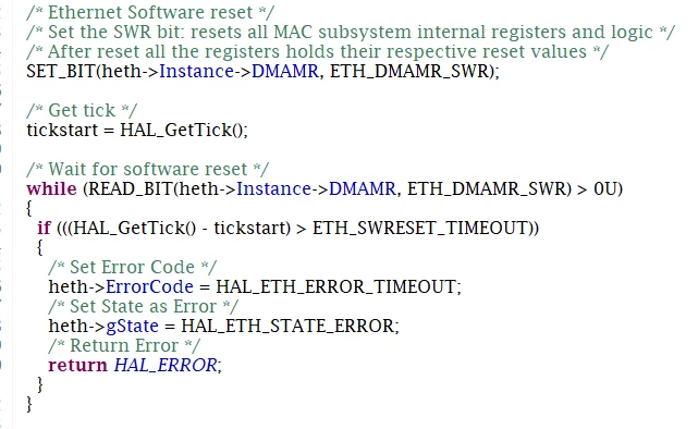

I am using STM32H573 and trying to enable ethernet. I have used the below article for it:
https://community.st.com/t5/stm32-mcus/how-to-use-the-lwip-ethernet-middleware-on-the-stm32h5-series/ta-p/691100
But ethernet is not being initialized. The HAL_ETH_Init is returning error which is resulting in error handler.
This is the condition being checked in MX_ETH_Init function. As even after using the steps mentioned in the article mentioned above the ethernet is not working.
- Do we have to add RX and TX descriptors specific addresses in the linker file?
Best answer by jowakar122
After multiple tries I check on the hardware side and the problem was there. After proper connections on the hardware the problem was solved.
I appreciate all for helping me out

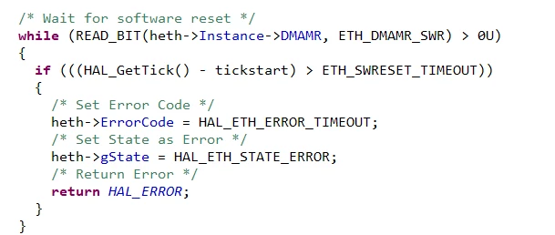

@mbarg.1 I have tried that but still it is not working.
This where it is getting error inside the HAL_ETH_Init function. Moreover, there are no LWIP examples on STM32H573.

As I have mentioned above the issue lies due to wrong configuration of clock. Due to which the ETH_DMAMR_SWR is always SET.
Does anybody have any idea regarding this issue.

 heth.Instance = ETH;
 MACAddr[0] = 0x00;
 MACAddr[1] = 0x80;
 MACAddr[2] = 0xE1;
 MACAddr[3] = 0x00;
 MACAddr[4] = 0x00;
 MACAddr[5] = 0x00;
 heth.Init.MACAddr = &MACAddr[0];
 heth.Init.MediaInterface = HAL_ETH_RMII_MODE;
 heth.Init.TxDesc = DMATxDscrTab;
 heth.Init.RxDesc = DMARxDscrTab;
 heth.Init.RxBuffLen = 1524;
 /* USER CODE BEGIN MACADDRESS */
 /* USER CODE END MACADDRESS */
 if (HAL_ETH_Init(&heth) != HAL_OK)
 Error_Handler();

Senior
May 20, 2025
@Andrew Neil In HAL_ETH_Init: From here HAL_ERROR is returned.
The ETH_DMAMR_SWR is always set.

Principal II
May 20, 2025
Are you using "pure HAL ETH", or did you modify it?
As you are using your own hardware, have you checked that all external clocks are available?
See NOTE in code:
/* SoftWare Reset */
	/* set SWR bit: resets all MAC subsystem internal registers and logic
	 * 	NOTE: the SWR is not performed if the ETH_RX_CLK or the ETH_TX_CLK are
	 *			not available -> check external PHY or IO configuration
	ETH->DMAMR |= ETH_DMAMR_SWR;
