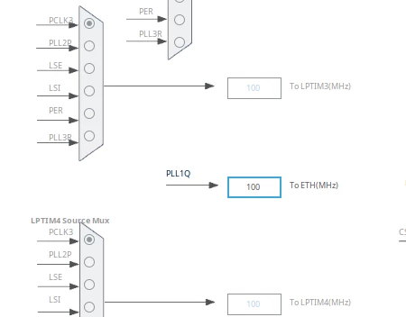

From what I've read on this forum, the ETH somehow needs an external clock input from the transceiver. However, ETH_REF_CLK is only defined in RMII mode, but I want MII mode with RX and TX clocks. Does it still need permanently running clock? ETH_RX_CLK is currently served from the transceiver with 2.5 MHz (in 10 Mbps mode), the ETH module itself is clocked 100 MHz from PLL1Q:
I even tried rising the timeout threshold, but even 50 s is failing. Any ideas on how to get the initialization through?

ETH_REF_CLK is for RMII. ETH_RX_CLK and ETH_TX_CLK are for MII.
I observed HAL_ETH_Init failing similarly for the STM32H7S78-DK last year and posted that and a fix at https://community.st.com/t5/stm32cubemx-mcus/bugs-caveats-misc-fixes-stm32h7s-cube/td-p/710992. For clarity, the peripheral clock's fix in HAL_ETH_MspInit was:
 PeriphClkInit.PeriphClockSelection = RCC_PERIPHCLK_ETH1REF;
 PeriphClkInit.Eth1RefClockSelection = RCC_ETH1REFCLKSOURCE_PHY;
Feb 4, 2025 1:50 AM UTC

Feb 4, 2025 2:32 PM UTC
I am using STM32H573, not STM32H7 series.
STM32CubeMX version: 6.13.0
Firmware package version: STM32Cube FW_H5 V1.4.0
It is a custom board. I use DP83826 as Ethernet transceiver and 25 MHz oscillator. However, afaik it should be independent of the transceiver in MII mode for the reset.
I tried figuring it out and adding the missing code myself, but there are no such RCC_PERIPHCLK_ETH... macros in the entire HAL. I also just tried to initialize a blank project with just ETH enabled without success.
