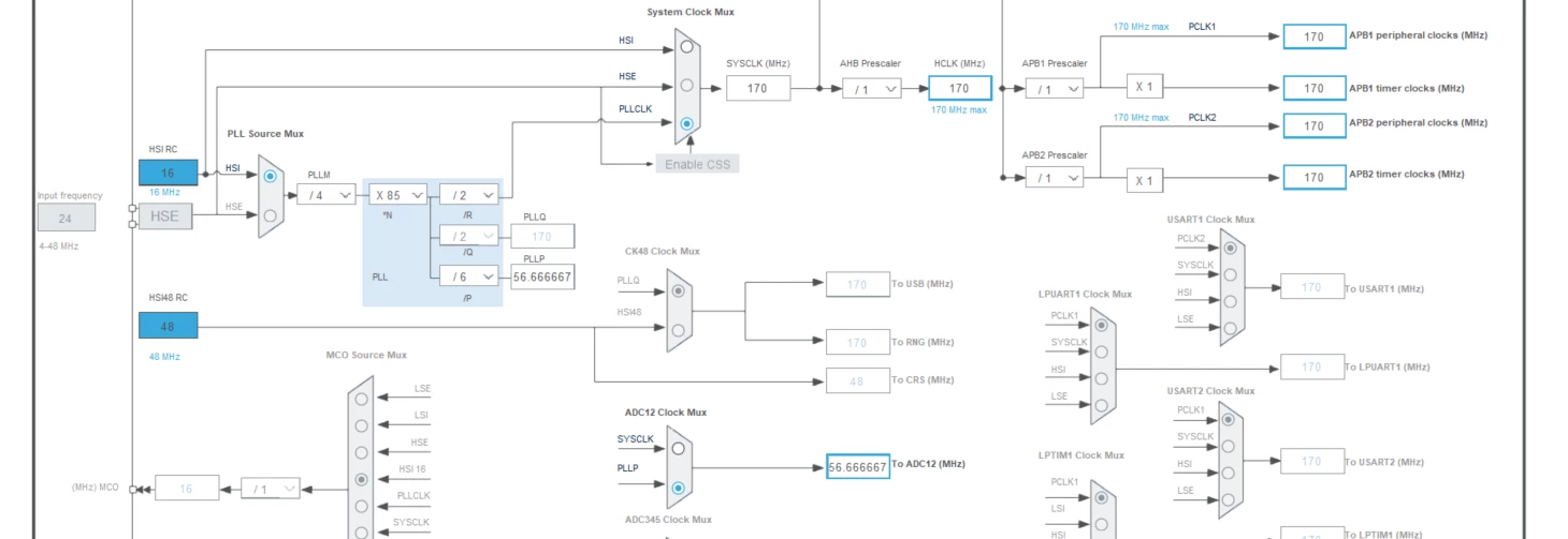

Main clock is HSI + PLL (170MHz) for TIM and ADC is configured at 56.66MHz, so a single ADC input should be done in less than 10us (1/100kHz).

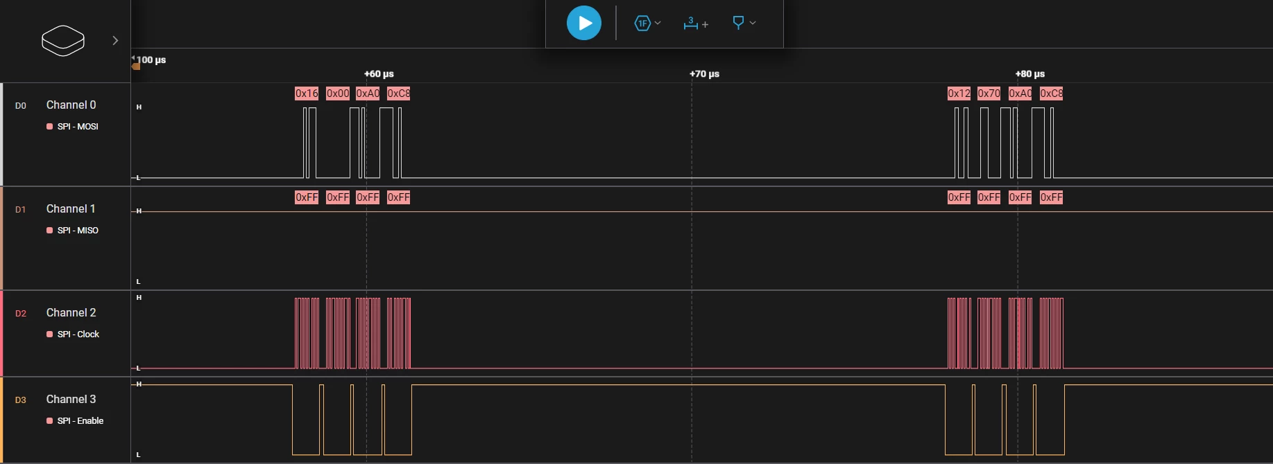

What I achieve is a 50kHz sampling (20us between SPI transfers). If I increase TIM1 ARR over 3.399 (value for 50kHz) the sampling rate starts to decrease from 50kHz. I can sample at exact 20kHz, 30kHz, 40kHz... but under ARR=3.399 I can't see any sampling increase over 50kHz. Could it be because AN5497 is based on CRM SRAM memory instead of flash? Could it be because they use DMA+FMAC instead of DMA register reading? Could it be because I use HAL library and LL is more optimised for register programming?
In next figure I represent 50kHz ADC sampling and SPI sending (20us between SPI send) sending 4 bytes.
When I RUN the code (no matter if Debug or Release version) it samples just once, and in ADC I can measure a decreasing value from original value. In numbers:
ADC input is 0V, that with right alignment corresponds to around 17000 ADC value (12 bits). In SPI (hex coded) I can see around 10-20 samples starting from 17000 and ending at 0. Could it be the ADC SAR capacities discharging? (as If I only sample once)

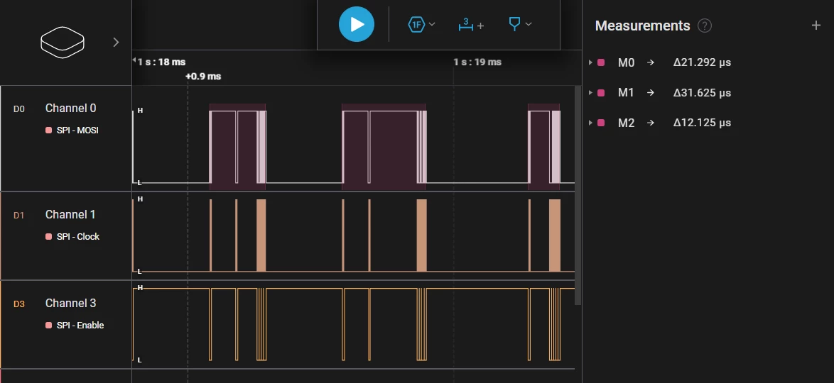

Cons: Difficulty to reduce non-deterministic transfer time and baud rate for SPI. Here I show how data transfer at 20kbauds (desired 50us between data package) could result in a conversion time from 12us (24% of real time) to 31us (62%). I will consider reducing SPI clock to 10Mbps and reduce baud rate to 1kHz or even 100Hz as it is only for external datalogging.
Thank you all for your tips and support!
