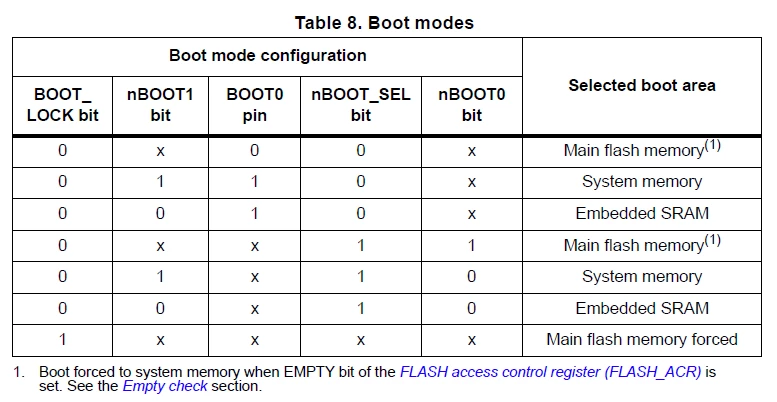

nBOOT1=1, nBOOT0=1, nBOOT_SEL=1. That means I was in the fourth line scenario, it attempted to boot from Main Flash and only booted from bootloader when it was empty regardless of BOOT0 pin state
To fulfill the requirements of the project, I needed to set the first and second lines scenario, so it would boot from Main Flash when BOOT0 pin was low and boorloader when high. To do that, I changed the option bit nBOOT_SEL from 1 to 0
Now, with nBOOT1=1, nBOOT0=1, nBOOT_SEL=0, I was able to flash from bootloader every time that BOOT was high, which is what I wanted. The issue was that when I tried to connect from SWD to develop the rest of the project, I found that I was unable to connect from SWD. I tried everything: connect from under reset, power down, core, software and hardware reset and it was impossible.
I could still flash the memory through bootloader, so I tried to erase it completely and succeded but still could not connect through SWD, so finally I decided to change back the option bits to nBOOT1=1, nBOOT0=1, nBOOT_SEL=1. From then on, I have been unable to connect through both bootloader and SWD. I understand that nBOOT_SEL=1 caused to enter Main Flash regardless of BOOT pin level, but that does not explain why SWD became unresponsive

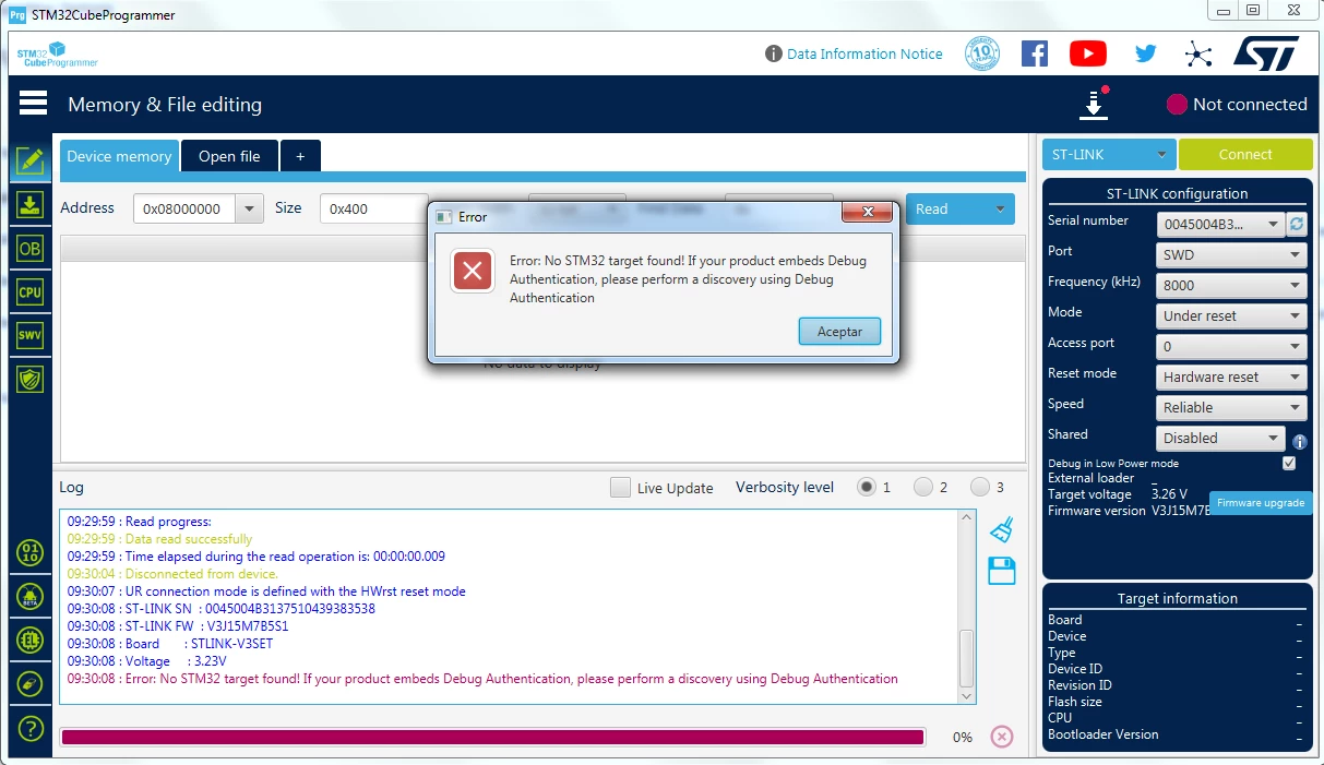

Why can't you connect with SWD? What happens when you try? Unless you are erasing/programming flash, reassigning SWD pins, or otherwise, the connection will work. If the chip is in the bootloader, you can connect with SWD. No way to disable SWD apart from setting RDP level 2.

When I try with STM32CubeProgrammer, it shows this:
Before changing nBOOT_SEL to 0 and flashing, I was able to connect normally. I have not changed the RDP level at any point
