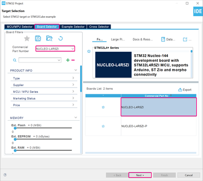

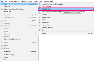

Opening the software, click on File > New > STM32 Project

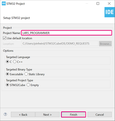

In the "Board Selector" tab, search for NUCLEO-L4R5ZI as the commercial part number, select it on the list, then click next.
Give a name to the project, all other points can be left as default, then click finish.

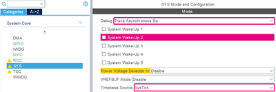

First, go to the System Core category and set “Trace Asynchronous Sw” as “Debug”. Select System Wake-Up 2 and “SysTick” as the “Timebase Source.”

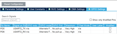

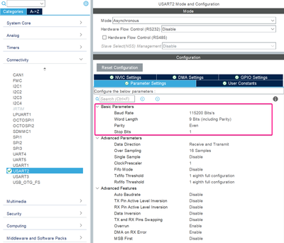

Going to the Connectivity category, set the USART2 configuration for our communication with the target board.
In the “Parameter Settings” tab, set the Baud Rate, Word Length, Parity and Stop Bits, according to the AN3155:

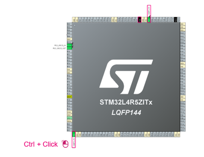

Pressing and Hold “Ctrl + left Click” on the PA2 and PA3 pins, with this we can drag and drop the pin to remap them to different GPIO location. Reallocate them as follows:
PA2 → PD5
PA3 → PD6
The GPIO Settings tab should be as follows:

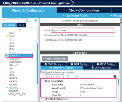

Add the LPUART peripheral to print the debug messages. The configuration is shown in the image below:
Remapping the GPIO Pins of the LPUART Peripheral to PG7 and PG8, we can use the embedded STLINK’s VCOM Port to transmit the debug messages:

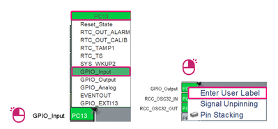

Add the User Button B1 so we can control when our application starts programming the target device:
Click in the PC13 pin > Select GPIO_Input
Right-click over the pins and rename them to control these pins later in the code. Rename the pin to “USER BUTTON”:

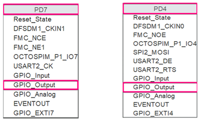

Now, add 2 pins to control the target’s BOOT0 and NRST pins:
For that, click in the PD7 pin and select “GPIO_Output,” it is our BOOT0 Control pin. For the reset control pin, do the same for the PD4.
Rename PD7 as BOOT_CTRL_PIN and PD4 as NRST_CTRL_PIN.

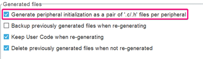

In the Project Manager Tab, go to Code Generator and mark the checkbox to generate the peripheral initialization functions separately as a pair of ‘.c/.h’:
 To finish the project settings, generate the code pressing alt + K or clicking on the gear icon:

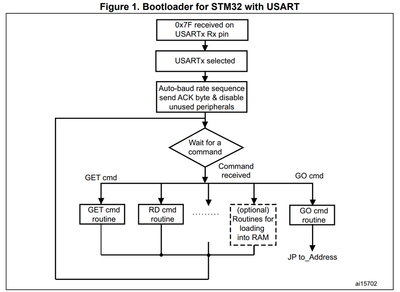

To implement our code, we will refer to the AN3155’s flowchart regarding the bootloader code sequence via the USART protocol:
AN3155, page 5AN3155, page 5
This is helpful for us to understand the needed order of commands to start and keep a proper communication between target and host (programmer).

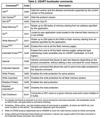

Additionally, the AN3155 also lists and describes the supported commands to be used for the bootloader through the USART protocol:
AN3155, page 7AN3155, page 7

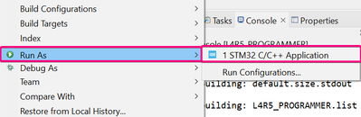

To load our application project into the programmer board, we have to build the project to verify errors and warnings, and then run the application!

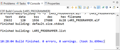

To build the project, press “Ctrl + b” or click in the hammer icon:
Verify that it returned 0 errors and 0 warnings:
To run the application, right-click in the Project Name > Run As > 1 STM32 C/C++ Application.

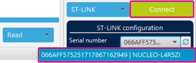

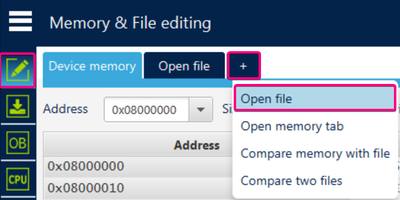

With all set, we must add a binary to be programmed in our target board. Connect the NUCLEO-L4R5ZI board to the computer,  open the STM32CubeProgrammer, select its serial number and press connect.
In the “Memory & File editing” section, click the “+” button. Select Open file and load the binary file to be programmed into the target board.
Select the download address. It must be the same as previously defined in the IMAGE_ADDRESS define.
Great! All the first programming part is correctly set!

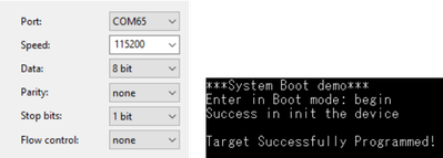

With both STM32 boards powered up and connected as specified above, press the User Button B1 of the NUCLEO-L4R5ZI and the code is programmed! You can debug the messages via Tera Term. To show that the program is working properly or verify error messages, you can also open a VCOM Terminal and verify the debug messages received by the host, to check command errors, NACKs received, etc.
With the STM32CubeProgrammer, you can connect to the target board and click the “+” icon. Select “Compare Memory with file” and check if the target memory content matches with the binary file downloaded.
The application should work successfully.
