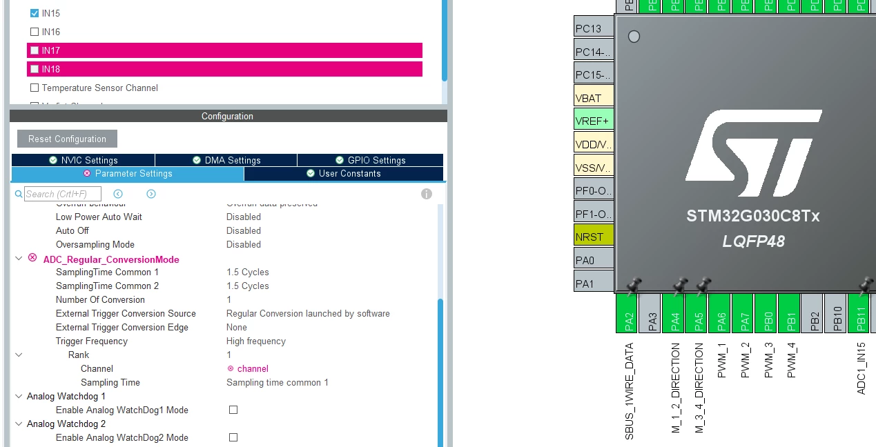

STM32G030C8TX ADC Issue on PB11 and PB12 Pins
I am currently working with the STM32G030C8TX microcontroller and I have encountered an issue while reading analog values through the ADC.
When I attempt to read ADC values from the PB11 and PB12 pins, the measured values are incorrect or unstable. However, when I use other ADC-capable pins on the same microcontroller, the readings appear to be correct and stable.
Because of this behavior, I am unsure whether:
  • PB11 and PB12 pins support ADC functionality on this device/package
  • There is a configuration issue on my side
  • Or there might be a silicon/production-related issue with the chip
I would appreciate it if you could clarify whether these pins are valid ADC inputs on the STM32G030C8TX and if there are any known limitations or special configurations required.

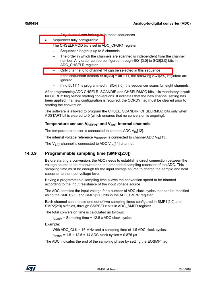

Oh, so you probably attempt to use the fully configurable sequencer mode (I don't know how is it called in Cube/CubeMX, I don't use Cube). That has this limitation, as documented in the RM (and CubeMX attempted to prevent you from going against it):

EGurd.1
EGurd.1Author
Apr 1, 2026 12:18 UTC
As you see on CUBEMX, it can not determine channel number only if PB11 or PB12 is choosen.
Even though CUBEMX cant determine channel number, I rewrite sconfig.channel as for channel 15 (PB11) and channel 16 (PB12).
/** Configure Regular Channel
 sConfig.Channel = ADC_CHANNEL_16;
 sConfig.Rank = ADC_REGULAR_RANK_1;
 sConfig.SamplingTime = ADC_SAMPLINGTIME_COMMON_1;
 if (HAL_ADC_ConfigChannel(&hadc1, &sConfig) != HAL_OK) {
 Error_Handler();
 I tried ADC poll for conversion for channel 10,11,15 and 16 seperately with this code. And the result was: channel 10 and 11 works perfectly. Even though channel 15 (PB11) is always 460 (12 bit adc max 4095) and channel 16 (PB12) is always 55. I already see voltage changes with ossiloscope on these pins, i can't see on debug.
HAL_ADC_Start(&hadc1);
 while (1) {
 if (HAL_ADC_PollForConversion(&hadc1, 100) == HAL_OK) {
 adcValues[0] = HAL_ADC_GetValue(&hadc1);

waclawek.jan
waclawek.janBest answer
Apr 2, 2026 09:01 UTC
