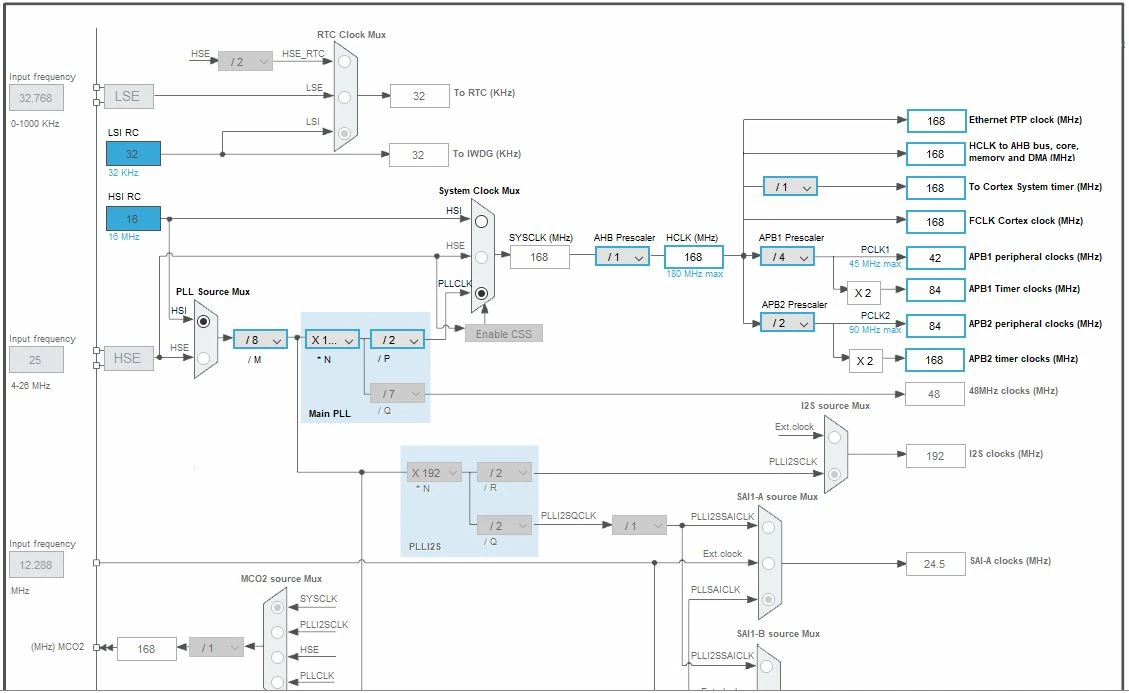

STM32F429IET6 Ethernet SW Reset Timeout
I have a custom designed board using a STM32F429IET6 and LAN8742A.
While attempting to bring-up ethernet and LWIP (fails w/o LWIP at the same spot) the code continuously fails in stm32f4xx_hal_eth.c in `HAL_ETH_Init` while waiting for the SW reset to complete after setting the SR bit in the DMABMR register.
I've attempted copying as closely as possible the development board design (Nucleo-F429ZI) in software. The only differences that I can see are:
- We use PG14 for RMII TXD0 instead of PB13.
- We are using a 25MHZ external clock instead of the 8MHZ the Nucleo-F429ZI uses, but both running the board HCLK @ 168MHZ.
- We use a dedicated reset line from the MCU PA6 to the nRST line on the LAN8742.
- The Nucleo has the RXER pin going through a 10k then to GND. We also have a 10k to GND but it also ties to PB10. Currently, we have the PB10 pin not setup.
This is where the timeout is happening in stm32f4xx_hal_eth.c (see line 15 of this snippet):

 Below is a screenshot of the clock configuration:
When we probe the ETH_REF_CLK we see the line go high, clock for a small amount of time at the wrong frequency (~1.25khz) and then remain high afterwards.

Hello @CLake.2 ,
This is most probably an issue with the Hardware design meaning your PCB design is not in line with the LAN8742 requirements.
You can refer to the following article to give you some insights and debugging tips Debugging tips when working with an Ethernet perip... - STMicroelectronics Community
if you can share with us your schematics maybe we will be able to cross-reference it with the design on the Nucleo board to help us understand the cause of this issue.
