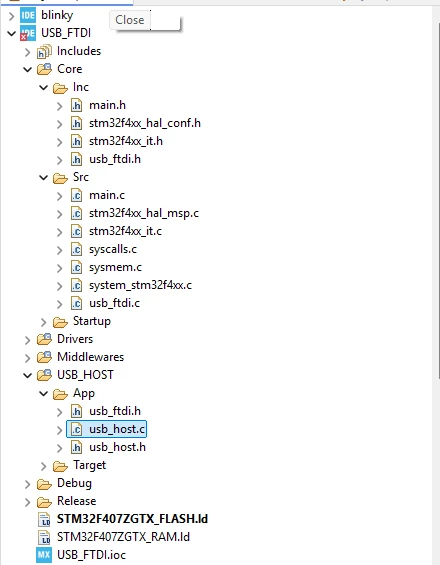

SohamCAuthor
September 25, 2025
I tried writing custom driver for the ftdi chip since its not available in the usb host library. I tried including the .h file in usb_host.c and main src as well for compilation. But the error symbol on the project logo is still there, I am not able to understand the problem. I think its because of linker. Can someone help me including the driver correctly.
Andrew Neil
September 25, 2025
If it's a build error (or errors), it/they will appear in the Console window when you do the build.
That will tell you exactly what the issue(s) is/are.
You can Copy and paste that output here - as text.
SohamCAuthor
September 25, 2025
The console window does not open and hence am not able to see the errors.
