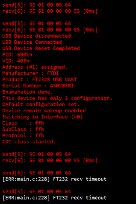

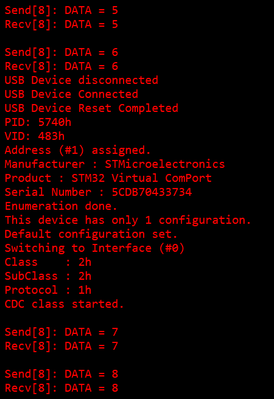

After some tries, I can use the STM32F429 to communicate with the FT232. (Refer to the source code in the attachment)
However, there are some bugs in the code:
1. There are always 2 more bytes to be received at the beginning of the data frame. (I ignore the first 2 bytes now)
2. Some frames can be received more than once. (I compare the continuously received frames and ignore the same ones.)
3. After re-plugging the FT232 device, the device can't work. (How to support the hot plug)
(And I already tried the STM32F1 Device CDC example with the same HOST code; all the above problems do not exist.)
Below are the LOG for the STM32F1 Device(left) and the FT232 Device(right):
I don't know the reason why the FT232 can't support the hot plug function.

See this recent thread: STM32F407 USB Host config for FT232RL.
As noted there by @waclawek.jan, the FT232 is not a standard CDC class device - so you'll have to look at its descriptors and you would need a custom driver for it.
As already noted, the FT232 is not a standard CDC device - so that's to be expected.
It's not the FT232 - that certainly copes with hot-plugging on other systems - so it must be something missing/wrong in your code...
