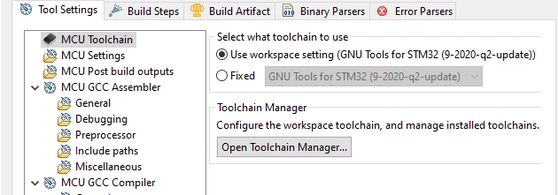

When I try compiling, I get the following error. ../USB_DEVICE/App/usbd_desc.c:186:3: error: initializer element is not constant
It seems that I cannot replace that USBD_PID_FS with a variable.
How best can I modify this PID value on boot?
Doing a search on "initializer element is not constant" resulted in finding the following page.
https://stackoverflow.com/questions/3025050/error-initializer-element-is-not-constant-when-trying-to-initialize-variable-w
In this thread there is a note about STM32. I am using the STM32 Cube IDE with I believe the compiler recommended. See attached image.
