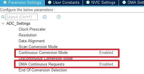

mƎALLEm
mƎALLEmBest answer
Apr 4, 2024 2:13 PM UTC
I've created a project based on STM32F407-DISCO board on which the ADC is triggered by TIM1-CC1 event. DMA has been used in circular mode to transfer the converted data to the memory.
The converted channel is the internal Temperature sensor.
Hope it helps.

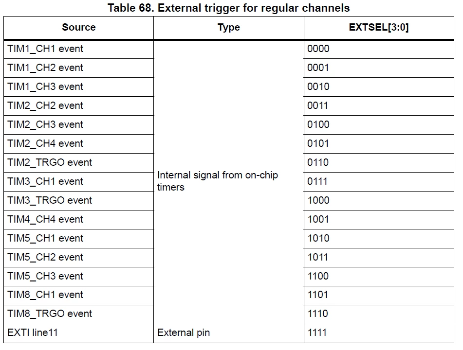

Parmin Nayani
Apr 4, 2024 11:50 AM UTC
Hello Sarra and SofLit,
Thank you for your replies. I did a check on the ADC_CR2 bits by reading them. I found the value after all the initializations, to be 0x400. Just the EOCS bit is set. So I did a brute force setting of the EXTEN bits by
ADC1->CR2 |= 0x30000000;   How to set these bits through the HAL call?
After this to start one set of conversions I called -> HAL_ADC_Start_DMA (&hadc1, (uint32_t *)adc_buf,ADC_BUF_LEN);  This seems to convert. TIM1_CH1 event value is 0000 so left it as it is. Sharing the project is no issue but the entire code is in a mess. I have several unused functions etc. I am posting the ADC init code. Here is the timer code

mƎALLEm
Apr 4, 2024 10:49 AM UTC
  • Which STM32F4 part number you're using?
  • You need to enable continuous mode on ADC and DMA :
  • This is the list of ADC internal triggers for regular channel conversion (from RM0090:(
