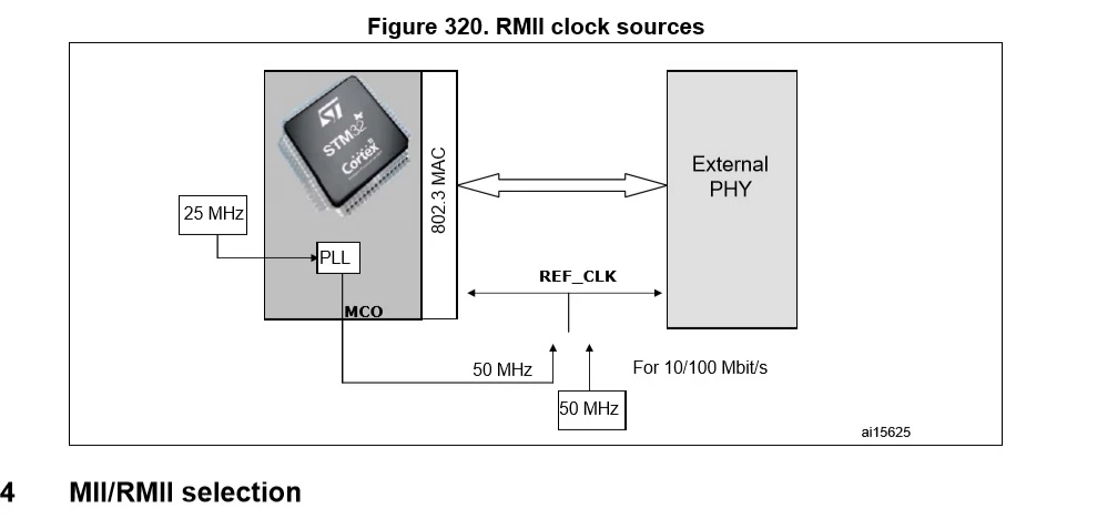

0690X00000DA2dHQAT.jpgJust checked the hardware components.
Quartz frequency between XTAL1 and XTAL2 is at 25MHz, frequency RMII-REF-CLK between PHY and µC is at 50MHz. These values are the same if I meassure them right after start or after flashing the code. I just checked with the reference manuals of the LAN8742 and of the STM32F207 that these should be the required values. Under 28.4.4(page 849/1378) of the µC manual is mentioned, that HCLK should be greater than 25 MHz. I have that checked with 120 MHz.
The only thing I am missing on my layout is shown in the picture. I don´t use the STM´s PLL and MCO-Output to generate the frequency. But as I understand it I can work with the way I do. Giving the MAC the 50MHz reference frequency with the RMII-REF-CLK and Setting HCLK over 25MHz. Maybe I am wrong with that?
Since there is no change in the frequencys measured before and after flashing on the peripheral it seems I have to look deeper into what happens when I flash the controller. @Piranha​ Seems your first assumption was right. Thanks again for the information but I wanted to check the easier solutions first.
