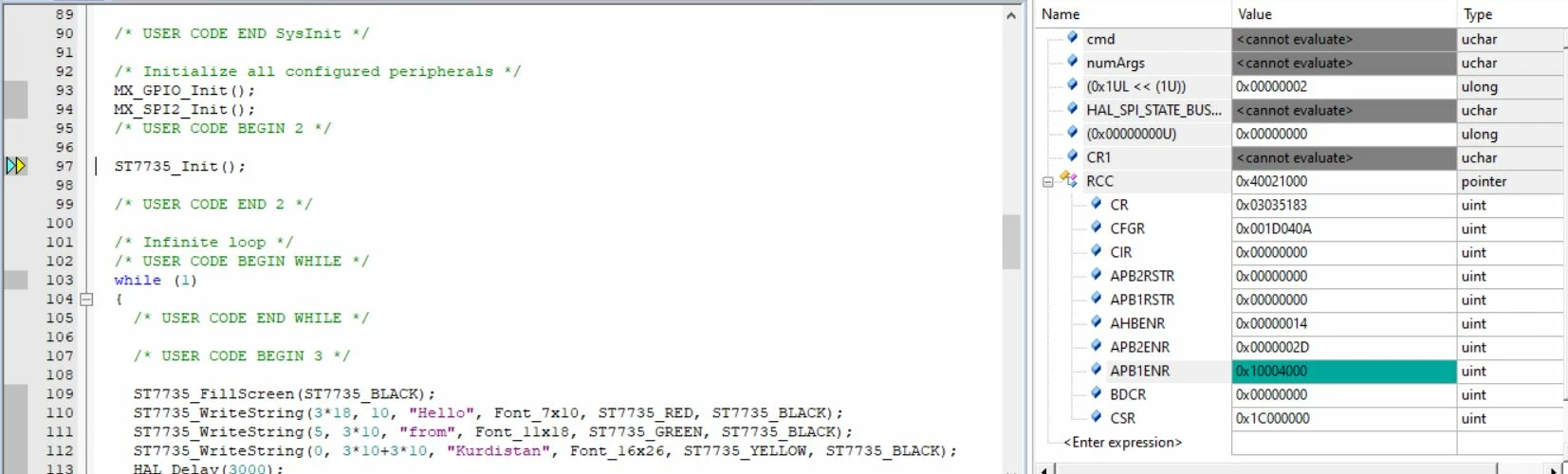

I have debugged RCC -> APB1ENR:
Bit 14 in RCC is set -> SPI2 is enabled
