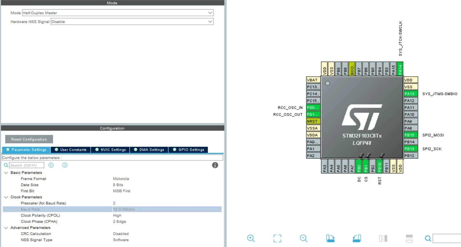

STM32F103C8 using SPI2
i am trying to interface 1.8 inch SPI TFT Display 128 x 160 to the STM32F103C8 using SPI2.
https://www.az-delivery.de/products/1-8-zoll-spi-tft-display
SPI1 is used for LoRa, i thought to connect TFT too to SPI1 using addresses but i am affraid to influence the
LoRa.
The library which i am using is from this website:
https://controllerstech.com/st7735-1-8-tft-display-with-stm32/
A year earlier i tried to interface LoRa to STM32F103C8 using SPI2 but without success.
Is it a general problem in STM32F103C8 using SPI2?
Any help is appreciated.
hamoBest answer
Mar 19, 2024 6:17 AM UTC
The problem was with the hardware.
Finally i could get the SPI2 work together with SPI1 on the same Board.
Many Bluepills are just not good this days.
Anyway thank you all for being helpful.
Best regards
Mohamad

@AScha.3  i have just tried this settings and compiled the code and uploaded, it stills not working for me.
I used the logic analyzer -> all the pins (SPI2) are not toggling.
AScha.3
Feb 13, 2024 8:04 PM UTC
What you write, to send on SPI ?
hamoAuthor
Feb 13, 2024 8:25 PM UTC
Here is my main code:

#define ST7735_SPI_PORT hspi2
extern SPI_HandleTypeDef ST7735_SPI_PORT;
#define ST7735_RES_Pin GPIO_PIN_10
#define ST7735_RES_GPIO_Port GPIOB
#define ST7735_CS_Pin GPIO_PIN_1
#define ST7735_CS_GPIO_Port GPIOB
#define ST7735_DC_Pin GPIO_PIN_0
#define ST7735_DC_GPIO_Port GPIOB

After changing the code and uploading it on the bluepill, i use logic analyzer to see if it works.
There is no clock on the pin PB13 -> not toggling at all.
AScha.3
Feb 15, 2024 1:26 PM UTC
Cannot be ... :flushed_face:
Show what you set in Cube to SPI2 .  we looked already.
Try debug - on  HAL_SPI_Transmit(...) : what it doing ???
hamoAuthor
Feb 15, 2024 7:40 PM UTC
I ahve done it.
after initialiying it tries to send the data and waits for the TXE flag to be set so it can send data.
But it keeps wait then goes to timeout.
With the help of logic analzyer i see there is no clock.
AScha.3
Feb 15, 2024 7:57 PM UTC
ok - just : you use cubeIDE - right ? nothing special doing .... ?
Because i set it in CubeMX, then generate code, then write to spi (HAL_... ) -- and it works.
So you must do something different...but i have no idea, what it could be.
ed
maybe i seen..
you set : half duplex master .
try:
waclawek.jan

hamoAuthor
Feb 16, 2024 7:25 PM UTC
Ok, and how?
waclawek.jan
Feb 17, 2024 9:19 AM UTC
>> Read out and check/post content of SPI and relevant GPIO/AFIO registers.
> Ok, and how?
Read out in debugger, in the same way as you've did it with RCC registers (there should also be some "peripheral view" window in your IDE somewhere, I don't use IDEs). Do that just before the moment you intend to start to transmit (i.e. place a breakpoint there).
(Using debugger is the most convenient way, even if there are some caveats. You could also read them out in program and output them in any way e.g. using UART).
Check by comparing registers content to the expected content, referring to respective chapters in Reference Manual.
