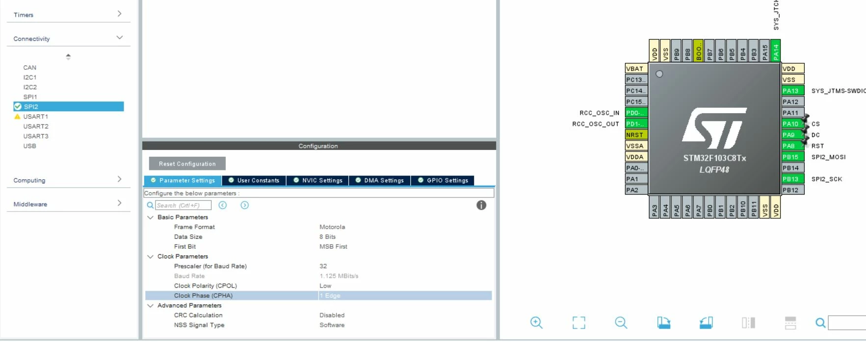

Here is how i configured the stm32f103 usnig STM32CubeMX:

My clock frequenz is max 72MHz and i looked at block diagram of blue pill and saw that SPI2 is on APB1 which has max 36MHz, so shall i change the cinfiguration in any way different than SPI1?

But, yes - getting the clock configurations correct is essential to everything!
You say you're using STM32CubeMX - the 'Clock Configuration' tab there will flag any clock setting issues ...

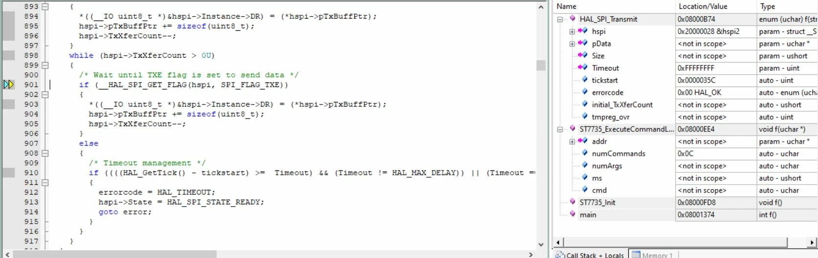

i have debugged it and found out that when goes into hal_spi_transmit() it initilaize every thing correct and when it try to transmit the data it chosses to transmit data in 8 bit mode (which is correct) it waits till TXE flag is set to send data, but goes to time out which means that TXE flag is not set (i think).
It keeps stuck there. I have tried to change RESET, CS and DC pins but without success.SPI2_debugging_1.JPG

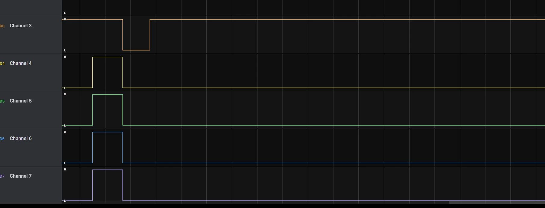

hamoAuthor
February 13, 2024
Hello @waclawek.jan
i have used logic analyzer and figured out that there is no clock.
Here is a capture of the SPI2:
The only toggle is when i reset the bluepill.

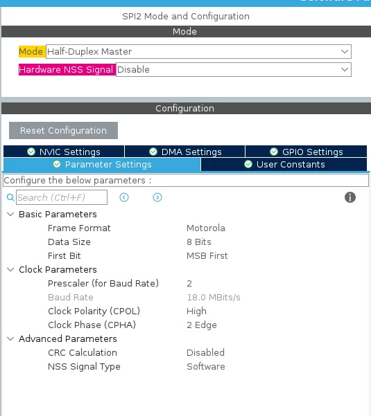

AScha.3
February 13, 2024
My spi2 setting:  (+ pin speed: high )
hamoAuthor
February 13, 2024
@AScha.3
and which pins do you use for CS, RESET and DC?
Are you clocking at max 72 MHz?
AScha.3
February 13, 2024
Yes , core at 72 M.
CS.. are just any I/O pins, that are close (for wiring...i hate, to have a wire cross the board. :) )
