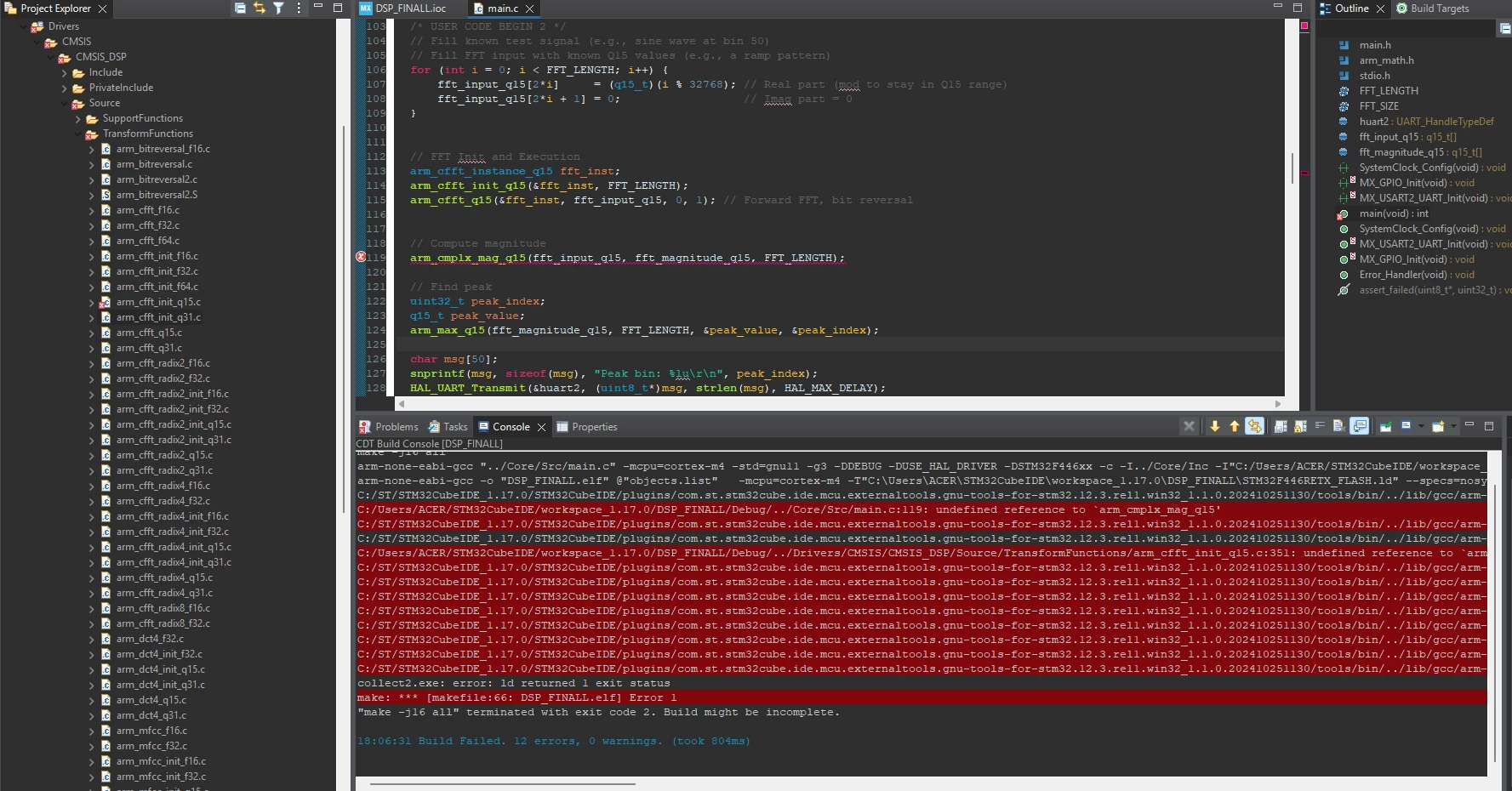

I need to do a 1024 point FFT on the STM32F446RE Eval Board. I try to integrate the CMSIS-DSP Libraries as mentioned in the forum and it creates errors only and I can't even run the program. I need to do a q15 FFT ,but it is not working. Help me to to integrate CMSIS DSP Library with the STM Cube IDE.
This is a simple issue and some ones guidance can help me a lot.

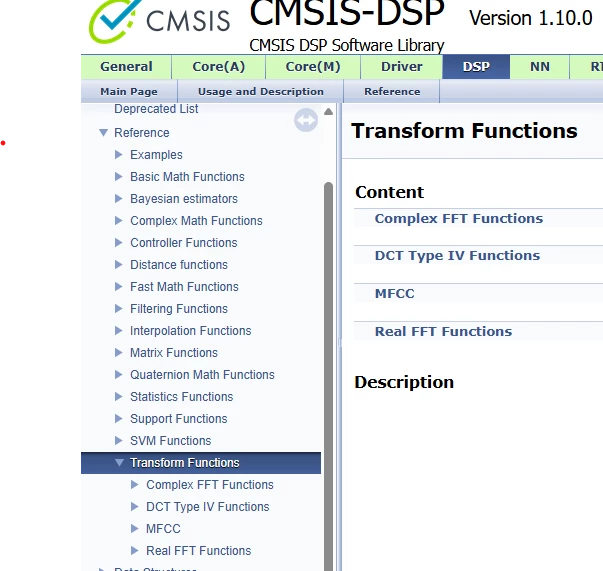

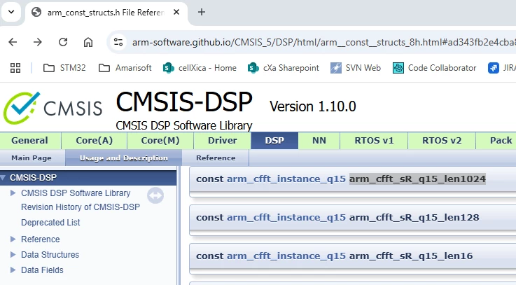

arm_cfft_sR_q15_len1024 is a C structure definition, it's documented here:
However, the place that you need to be starting to read is here: https://arm-software.github.io/CMSIS_5/DSP/html/group__groupTransforms.html
You need to decide whether you want a complex or real FFT, then it's easy to find the relevant function.

Hi @Imen.D and @bramble I actually CMSIS Version 5.9.0 so there there i don't have a precompiled library,so I followed the instructuin in second link you provided and actually that works.But the issue arises when I need to do the FFT ,I also need the transform function from the source ,so I added it along with support functions and also commented the 'C' files in the respective files in Transform Function folder. The error I got was somethinf like arm_cfft_sR_q15.c is not there. I think there is no such file.So I cant understand the errors.
@bramble I couldn't find the notes added by you.
Also to a 1024 point real time fft what all source functions we needed?
