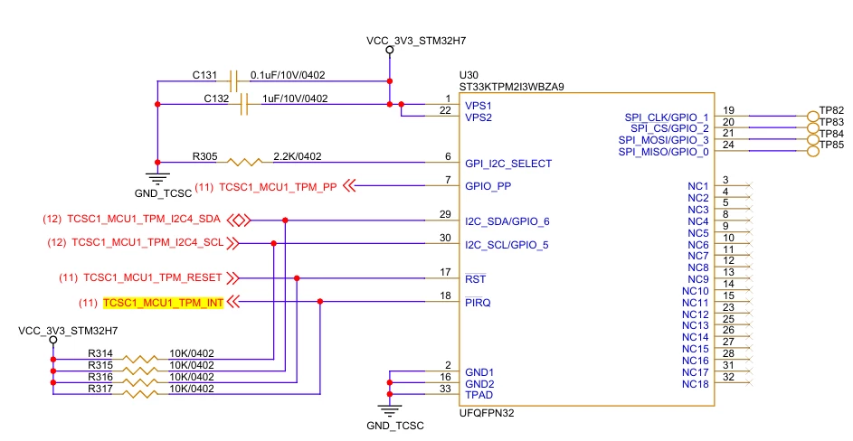

We are trying  to interface ST33KTPM2I3WBZA9 with STM32H735IGT3 using I2C communication.We have used following commands and logic for communication.
#define TPM_I2C_ADDRESS 0x2e << 1
#define TPM_REG_ADDR_COMMAND 0x00
uint8_t command_data = 0x80;
uint8_t read_data1;
uint8_t TPM_WriteReadTest(void) {
if (HAL_I2C_Mem_Write(&hi2c4, TPM_I2C_ADDRESS, TPM_REG_ADDR_COMMAND, I2C_MEMADD_SIZE_8BIT, &command_data, sizeof(command_data), HAL_MAX_DELAY) == HAL_OK) {
//HAL_Delay(10);
} else {
return TEST_FAIL;
if (HAL_I2C_Mem_Read(&hi2c4, TPM_I2C_ADDRESS, TPM_REG_ADDR_COMMAND, I2C_MEMADD_SIZE_8BIT, &read_data1, sizeof(read_data1), HAL_MAX_DELAY) == HAL_OK) {
if (read_data1 == command_data) {
return TEST_PASS;
} else {
return TEST_FAIL;
} else {
return TEST_FAIL;
Here when initially tested the "HAL_I2C_Mem_Write" function gets passed for around 2 minutes of power on,after that function fails.With further evaluation the "HAL_I2C_Mem_Write" fails in "I2C_RequestMemoryWrite" function in the API below.

 What may be the reason,how can we debug it?
Please show your schematics of how you've done that.
The first thing is to discover what's actually going wrong:
  • What, exactly, did you expect your code to do?
  • What, exactly, is your code to actually doing?
As you're using an external hardware interface, the first thing is to use an oscilloscope or logic analyser to see what's actually happening on the wires.
Then use the software debugger and/or add instrumentation to see what the code is doing internally.
Some things to look at:
  • Your code returns TEST_FAIL in many places - you need to identify which test, exactly, is failing.
  • Rather than just test the HAL return codes for != HAL_OK, examine what the actual code returned is; look into why that code is returned
Some general debugging tips here:
https://community.st.com/t5/community-guidelines/how-to-write-your-question-to-maximize-your-chances-to-find-a/tac-p/706966/highlight/true#M49

SSAIL2023Author
Jan 16, 2025 11:45 AM UTC
Hi please find below the schematics for the TPM device. Here it is connected to I2C4 of STM32H735IGT3 and presence pin and interrupt are connected as  GPIO input to STM32H735IGT3 and we are reading presence as always high and interrupt pin always low.
