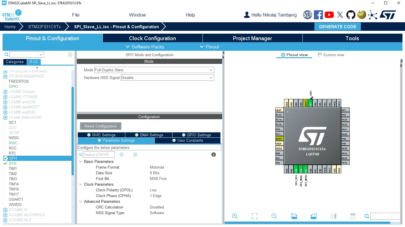

Setup:
SetupSetup

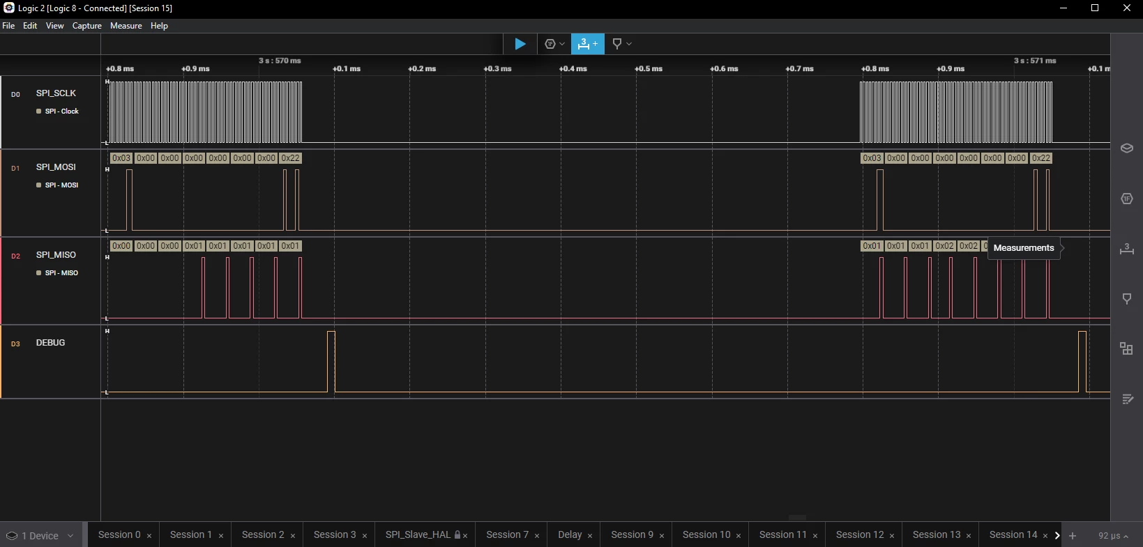

Jun 18, 2024 8:05 AM UTC
The flag msgReceived should avoid the buffer being changed in the main function if not a new message is received.
In the following I have set a debug gpio when the ISR finishes and reset the same gpio when the main function has processed the TxBuffer. From this it is clear that the new Txbuffer ready when a new transaction begins.

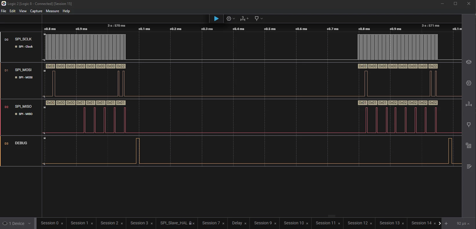

Jun 18, 2024 8:56 AM UTC
Adding a flag (answerPending) resolves the problem, but introduces an additional response delay.
Msg1: Master sends request
Msg2: ... (TxBuffer not updated jet)
Msg3: Slave response to master

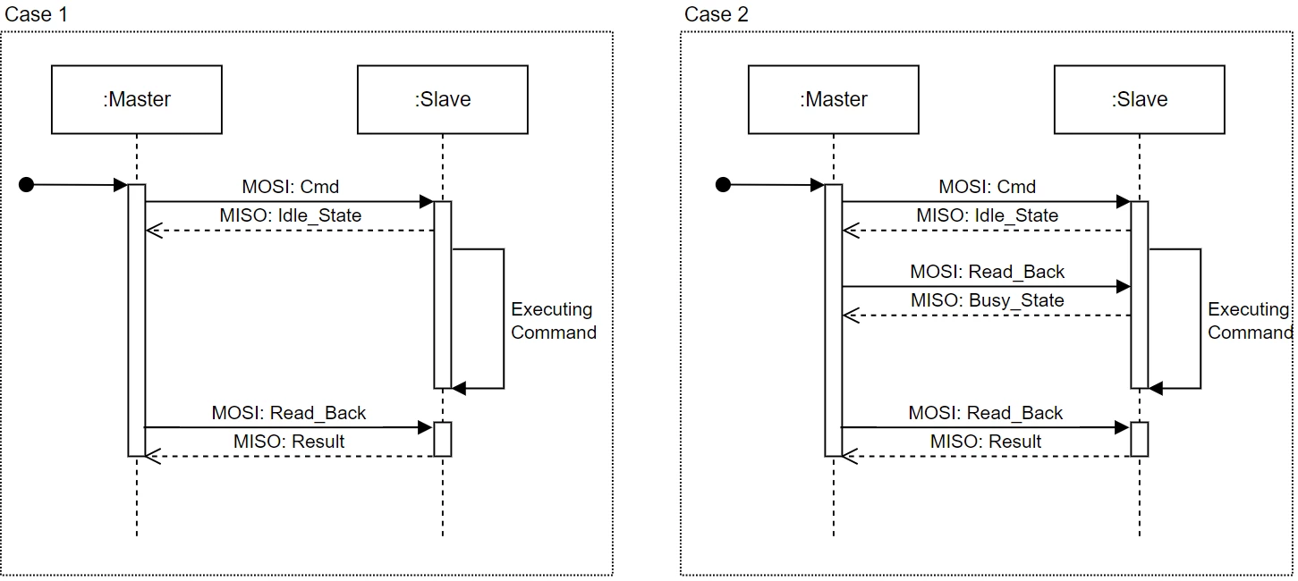

Jun 19, 2024 7:29 AM UTC
Thank you for the response @PPopo.1  and @BarryWhit,
I have been working on implementing the double buffering setup, but haven't been able to achieve the desired functionality. How would you implement the double buffering or the atomic operations?
I have sketched a sequence diagram which illustrates the desired functionality, which I hope to achieve from solving the problem which I have stated.
Sequence DiagramSequence Diagram
OBS: The two cases show how the slave should respond when the slave is busy and when it is done executing.
