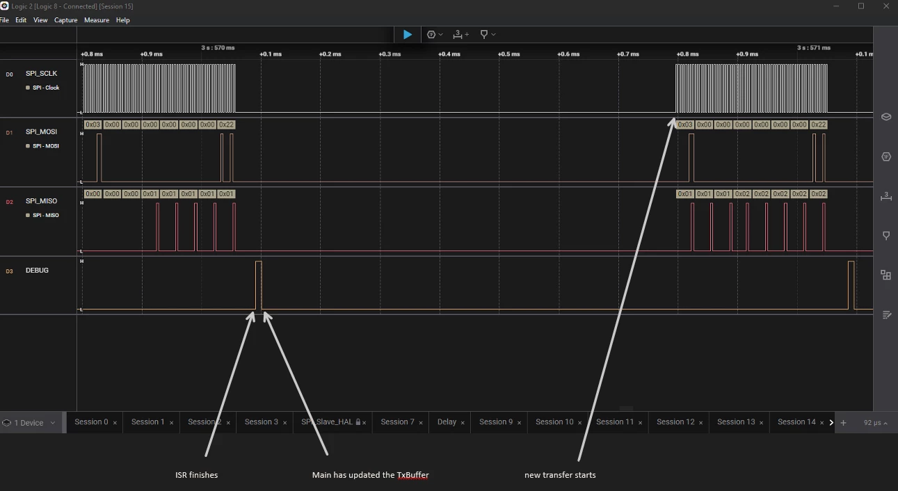

Hello ST Community,
I have setup a SPI master and a SPI slave, both use DMA in Normal mode. The word size is 8-bits and the data size is 8-bytes. The problem is that the slave transmits messages which contains old data.

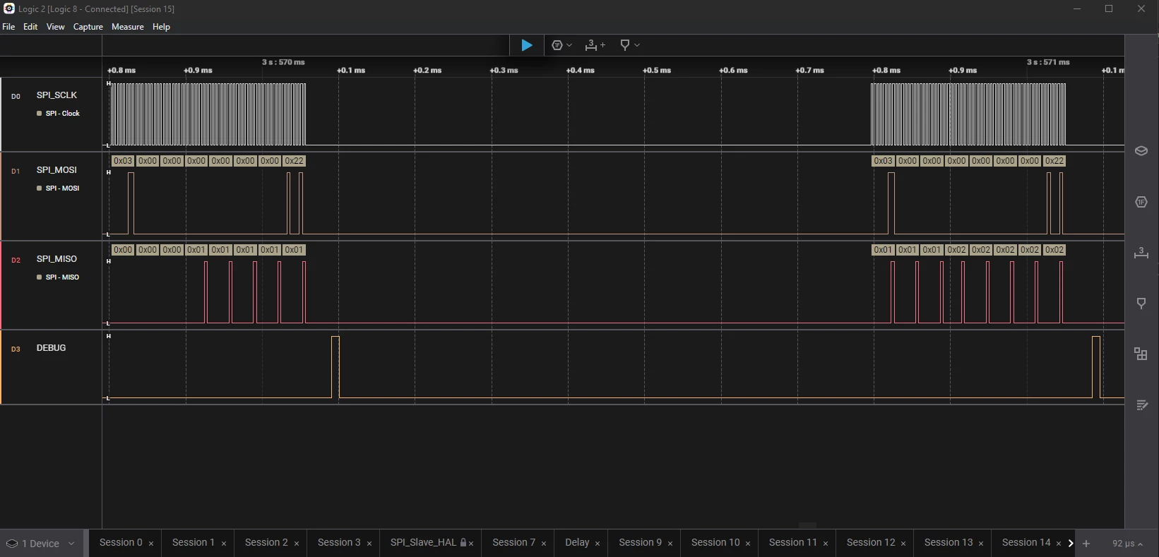

When it should send:
MISO: { 0x01, 0x01, 0x01, 0x01, 0x01, 0x01, 0x01, 0x01 }
it sends:
MISO: { 0x00, 0x00, 0x00, 0x01, 0x01, 0x01, 0x01, 0x01 }
MISO: { 0x02, 0x02, 0x02, 0x02, 0x02, 0x02, 0x02, 0x02 }
it sends:
MISO: { 0x01, 0x01, 0x01, 0x02, 0x02, 0x02, 0x02, 0x02 }
OBS: The debug gpio is toggled when the ISR finishes and when theTxBuffer is edited in main.
This pattern continues for every transfer it contains 3 old bytes.

Jun 19, 2024 1:46 PM UTC
If the TxBuffer is modified while a DMA transfer is still ongoing, you may end up with partial or stale data being sent. This often happens if the buffer update timing overlaps with DMA operations.
You are starting new DMA transfers from both the main loop and the HAL_SPI_TxRxCpltCallback. This can cause overlapping DMA requests, resulting in inconsistent buffer states.
You start the first DMA with a length of 8 but subsequently use BUFFERSIZE for the next transactions. Ensure consistency in buffer sizes to avoid partial data transmissions.
Updating TxBuffer while DMA might be using it can cause race conditions, leading to old or corrupted data being sent.

Jun 19, 2024 12:56 PM UTC
Ideally I would implement sequential first and then concurrently.
The first screenshot i posted from the logic analyser it showed that the TxBuffer was processed way before the next transation began. How can it be that I still see old data in the firste 3-bytes of the transfer?Logic AnalyserLogic Analyser

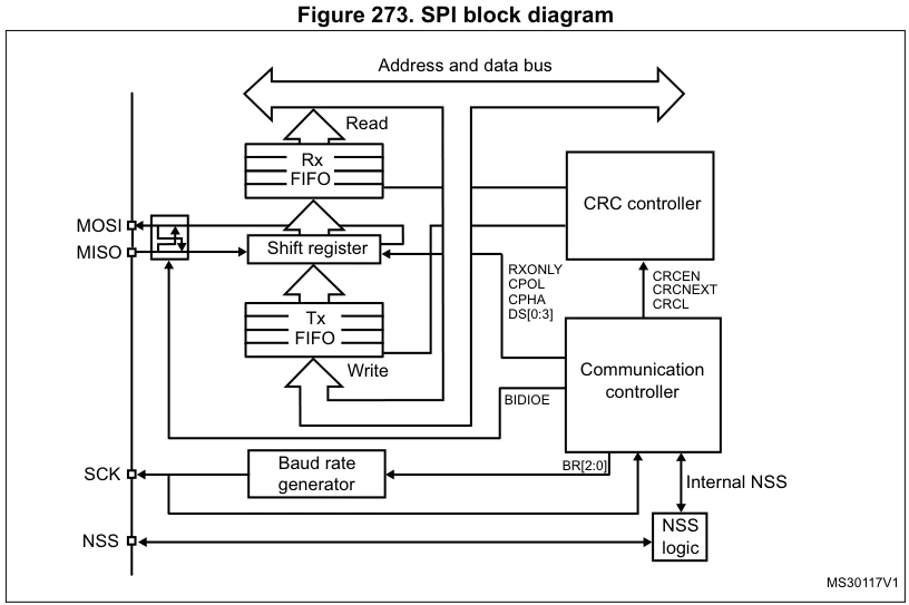

The reference manual (for STM32F031, rm0091) states that the SPI Tx Buffer can contain 3-bytes. When DMA is initiated it bumps the DMA_CNDTRx register from 8-bytes to 5-bytes likely because it transfers the first three bytes to the SPI TxBuffer which is illustrated in the block diagram below.
When I try to update the TxBuffer by setting up a new transfer I think that it is this FIFO that doesn't get cleared properly from the previous transfer. I am having a hard time debugging this as I haven't found any register or flash address for the TxFIFO & RxFIFO.
>   do you have suggestions any insights on the SPI TxBuffer, that might not be cleared properly?
You can certainly check the silicon errata for you chip, but if there isn't something there assume this is not the issue.

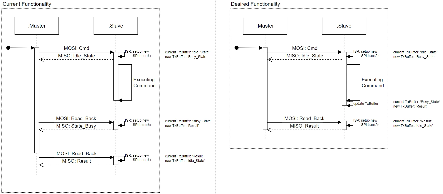

Jun 20, 2024 6:20 AM UTC
Thank you for your replies.
@BarryWhit I do want to understand why the current setup isn't working. I am well aware that if I only call the HAL_SPI_TransmitReceive_DMA in the main loop (or in the ISR) it would work as expected.
I have setup this code example to simplify my problem as much as possible. Really I am working on a motor control project with two chips a dedicated motor controller and a main chip that handles bluetooth and so on. The main chip should always be able to ping the motor controller, even if it has requested it to carry out a command. Secondly the motor controller should respons the main controller when it has executed a command and is ready for a new. If the main chip cannot ping the motor controller it should kill the motor controller (turn off the power).
The diagram depicts the current functionality and the desired functionality.
Currently the transfer is handled using synchronization flags, this introduces a delay. Although the slave has finished its task and has a result ready it transfers 'Busy_State', because a transfer only can be setup in the ISR.
Double Buffering has the same problem it still has a response delay.

The only purpose of the DEBUG pin is to show that there is plenty of time between the TxBuffer is updated in main until a new transfer starts.
I know that I should monitor whether a SPI transfer is ongoing before I update the TxBuffer. I will handle this after I have resolved my main problem, which is that I cannot update the TxBuffer after I have initiated a SPI transfer.
I see the same behaviour as in the Screenshot if I only update the TxBuffer in the main loop and omits calling HAL_SPI_TransmitReceive_DMA
So, you do understand you can't start a DMA while one is ongoing, but you don't understand why your code, which does just that, is corrupting data? I don't follow.
Your original post asked why you're seeing data corruption, and you got an answer.
You also cannot touch the buffer while a transfer is ongoing (not in code, not by restarting DMA). You're not going to "resolve" that.
are you trying to say that you need a way to interrupt an ongoing transfer? because that's completely unrelated to the issue we've been trying to help you with. If you've resolved the data corruption issue, I suggest you accept the solution  @PPopo.1 provided and start a new thread.
