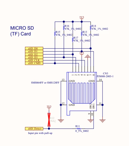

Thanks a lot  for you answer. Yes i know what you mean , but for me is difficult to understand that something so difficult lo learn , does’t have a path from trhe vendors company to learn. I know the basis from diferent website courses.  But for example, i am dealing with sd card connection to stm32f411 and it is really sad to have to learnm from people that you don’t know they are expert in the matter . You know what i mean?
As I said there are some “How to ...” provided by ST either as article/wiki or on the youtube channel.
For example for SD card:
Refer to this article: How to create a file system on an SD card using STM32CubeIDE
and this video: STM32 – Creating a File System on a SD card
They are using STM32F7 MCU but the SD configuration is almost the same.
For the hardware, you need to refer to the board schematic provided in the video: 32F746GDISCOVERY schematic. especially this part:
You can also refer to the STM32CubeF4 package examples, especially the ones using FatFs.
Example this example: https://github.com/STMicroelectronics/STM32CubeF4/tree/master/Projects/STM32F412G-Discovery/Applications/FatFs/FatFs_uSD
Hope that gives you the hint on how to start on this topic.
Sep 8, 2026 11:35 AM UTC
Awesome, im gonna see all the material you’ve send me , it is reassuring to have this support. I am really grateful . THANKS A LOT
