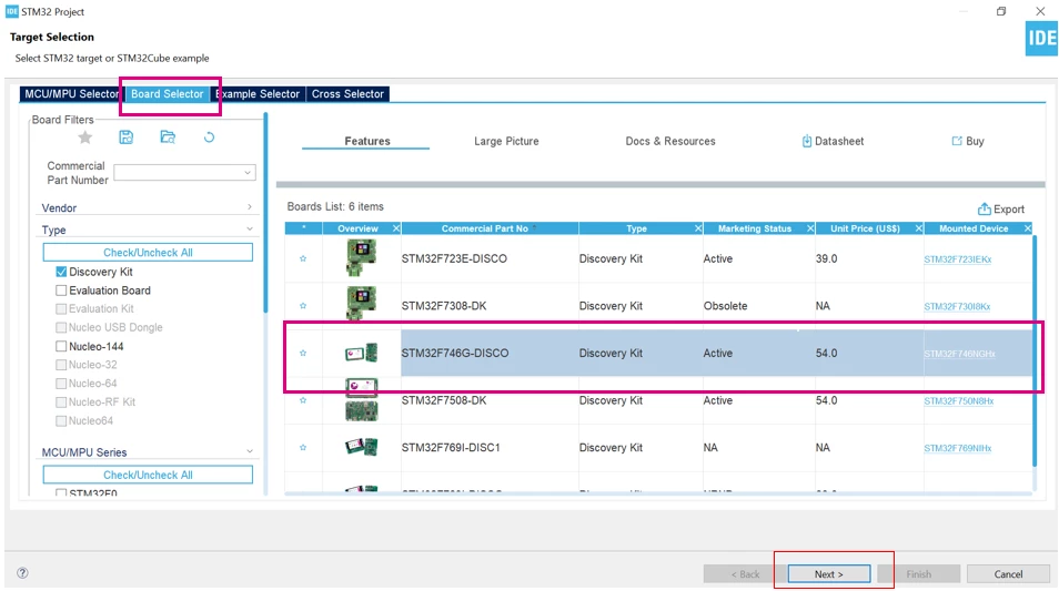

  1. Open STM32CubeIDE, and create a new STM32 project, selecting the STM32F746G-DISCO template.pepfof_2-1755096131183.png

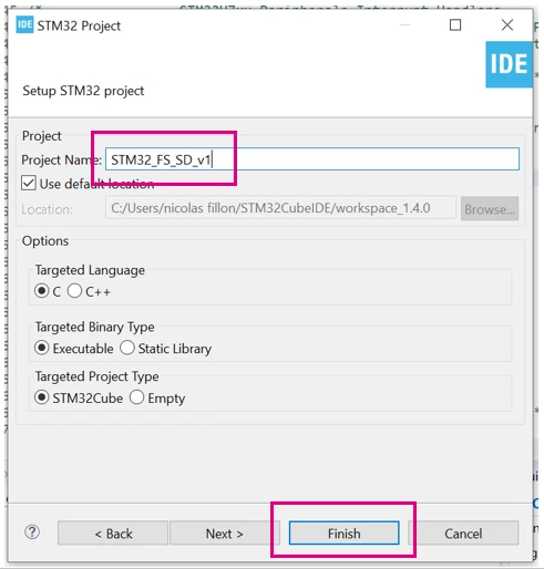

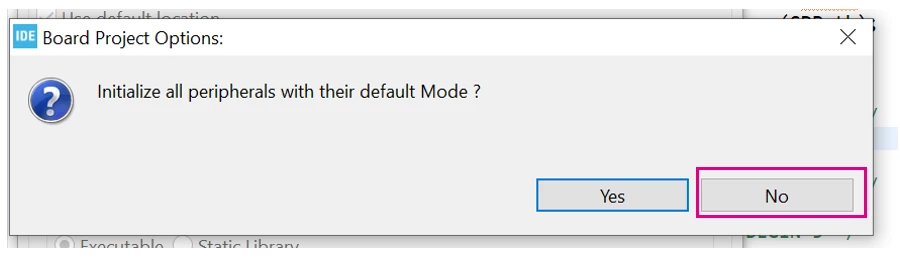

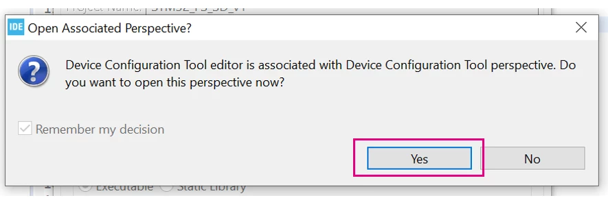

After this is done, the device configuration tool view is open in STM32CubeIDE. From here on, we can configure the MCU to be able to utilize the board's SD card slot.

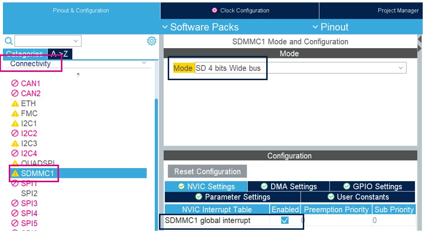

2. SDMMC configuration

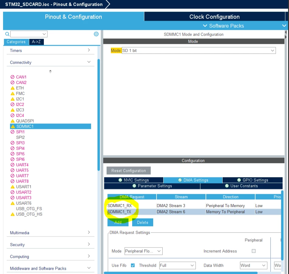

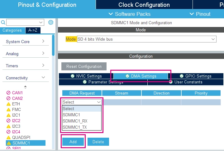

STM32 MCUs use the SDMMC peripheral to interface to an SD card, we need to configure it before we can write code that uses it. In this article, we also configure DMA access to the SDMMC peripheral to maximize performance.
  1. In the Device Configuration Tool view, for the “SDMMC1” peripheral, which is located in the “Connectivity” category, set the "Mode" parameter to "SD 4 bits Wide bus".1786.png

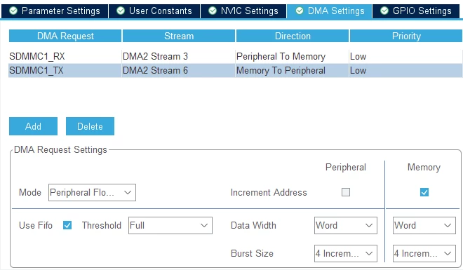

  2. In the DMA Settings panel, add DMA requests for SDMMC1_TX and SDMMC1_RX with their default settings.pepfof_0-1755095525756.png
    After adding these requests, the DMA settings panel should look like this:

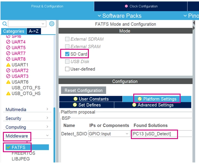

FatFs is an open-source file system middleware integrated in STM32Cube libraries. It is able to directly utilize the SDMMC peripheral to act as a disk device for the FAT file system. This is also configured through the Device Configuration Tool view.
  1. In the "Middleware" category, for the FATFS middleware, enable the "SD card" option. In the "Platform Settings" panel, select "PC13 [uSD_Detect]" as a solution for "Detect_SDIO".1788.png

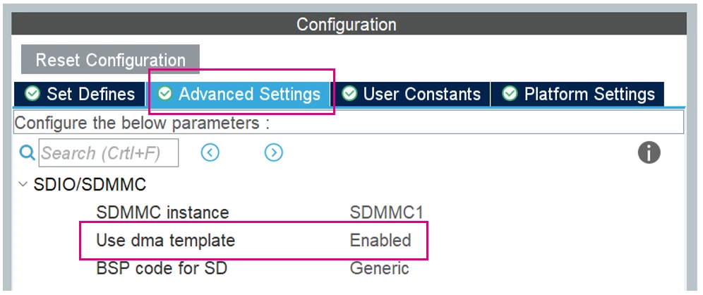

  2. As we are using DMA to access the SDMMC peripheral, in the "Advanced Settings" panel, enable the "Use dma template" option.pepfof_3-1755096797869.png

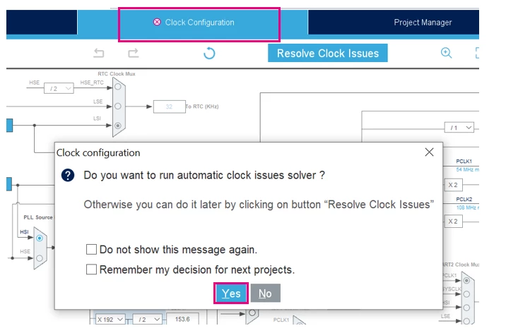

  1. The default clock configuration for this MCU presents an issue with the clock input to the SDMMC controller. This needs to be resolved, and can be done easily by going to the "Clock Configuration" tab and selecting [Yes] when asked to automatically resolve clock issues.1790.png

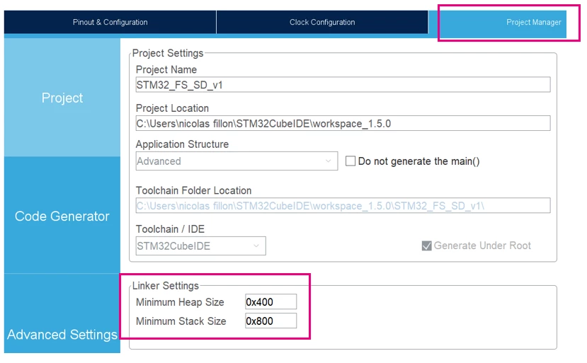

  2. Lastly, the FatFs middleware requires additional memory for the Heap and the Stack. In the Project Manager tab, set the "Minimum Heap Size" and "Minimum Stack Size" parameters for the Linker Settings to "0x400" and "0x800" respectively.1791.png

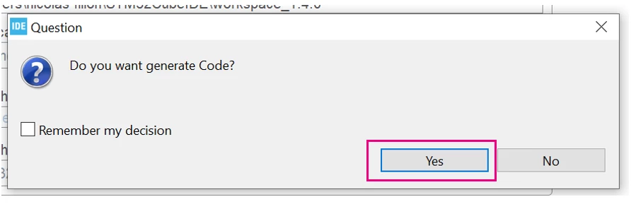

  3. When you save the project, the IDE presents you with an option to generate code according to your Device Configuration Tool setup. Select [Yes] when asked to generate the code.1792.png

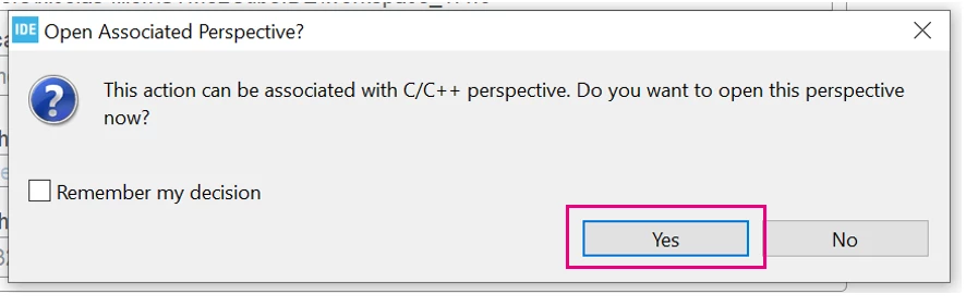

  4. Select [Yes] when asked to Open Associated Perspective. This will take you to your project's generated main source file.1793.png

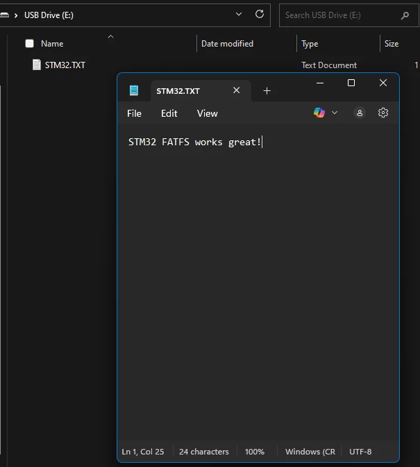

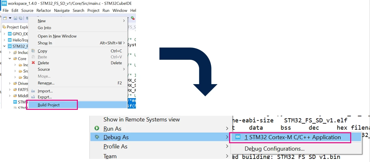

6. Build and flash the code
Finally, you may build the project and run it on the device by starting a debug session.
pepfof_0-1755098006776.pngWhen the code is executed, the SD card is formatted and the text file is written to it. Inserting the SD card into a host PC, you may read the file, as presented in the screenshot to the right.

Like others it failed at f_mkfs.  I watched the video for this guide...
https://www.youtube.com/watch?v=I9KDN1o6924
...and there is a step missing from this written guide.  The missing step, as shown in the video, is to add the DMA Rx and Tx..
Since adding the dma rx/tx and changing the SD mode from 4 bit wide to 1 bit, it now works.
For some reason it does not work in SD mode 4 bit wide
