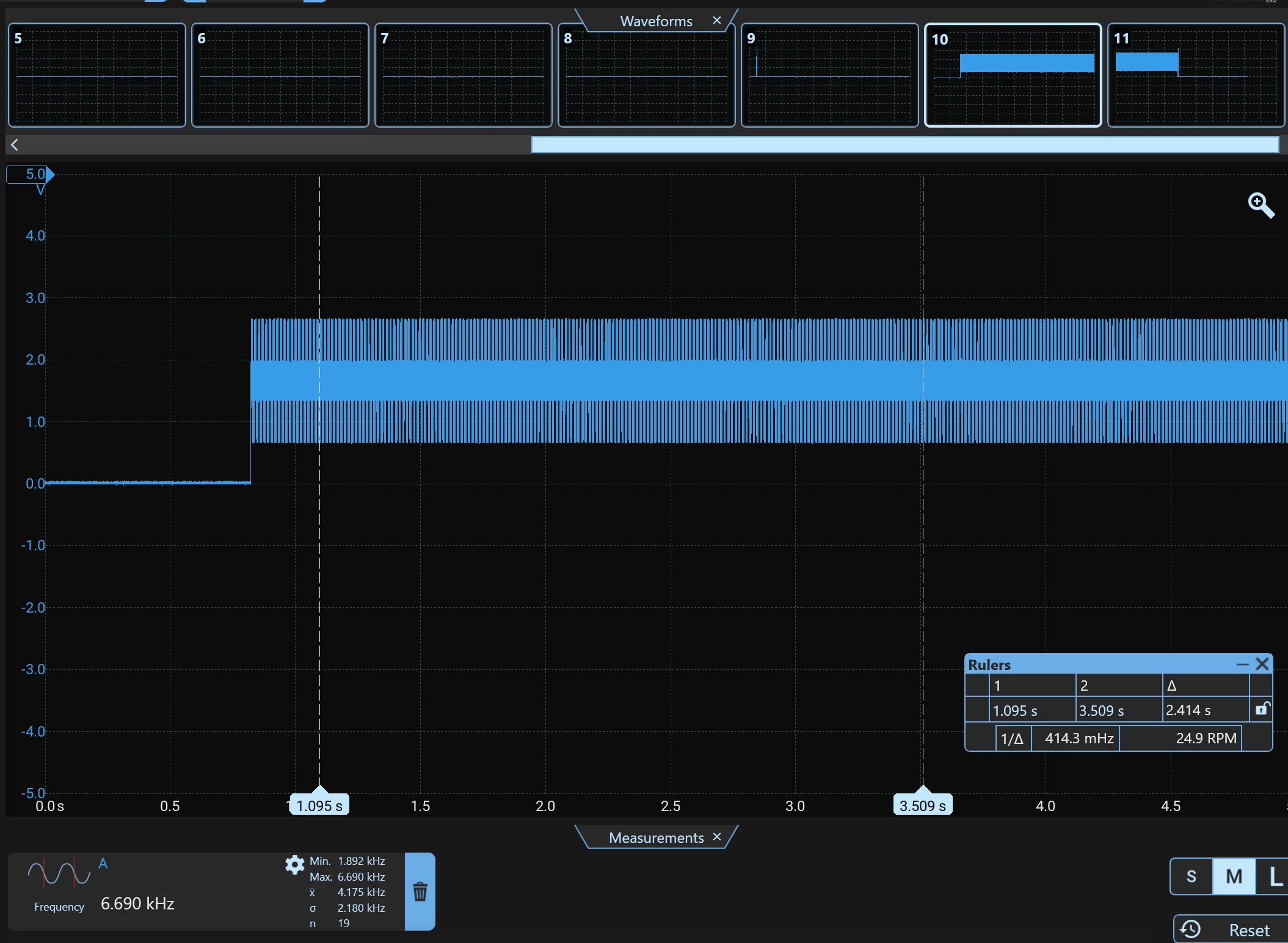

Does SAI output clocks as expected?

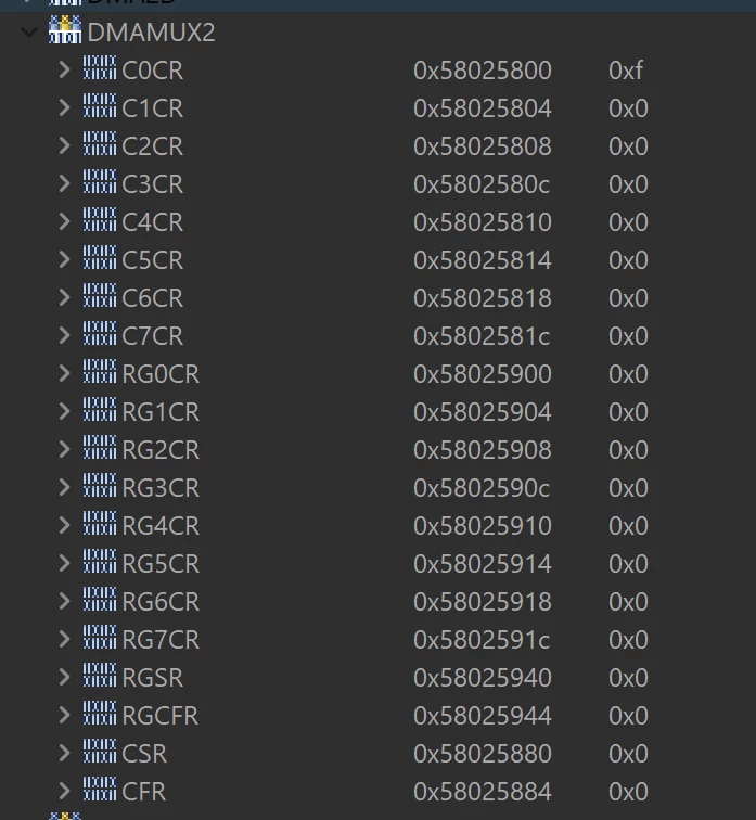

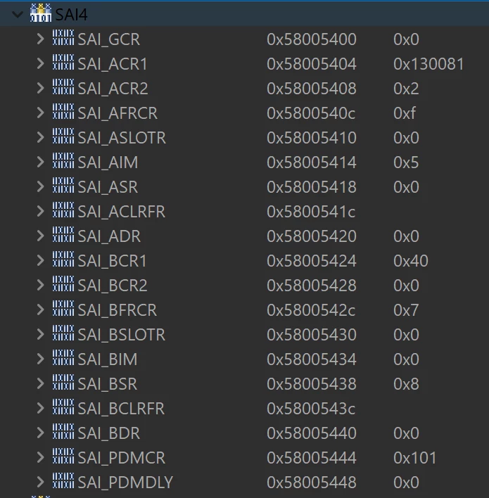

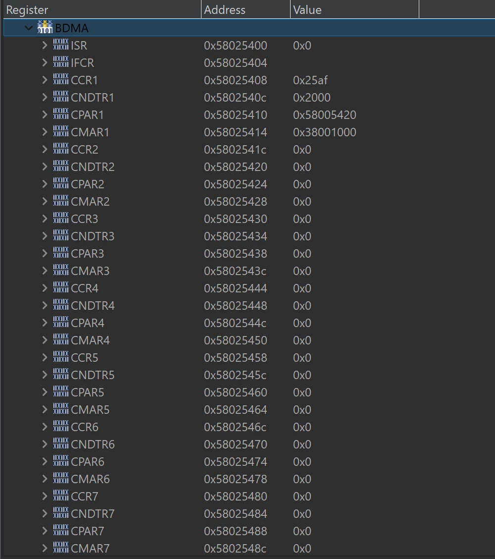

Read out and check/post content of SAI and relevant DMAMUX and DMA registers.
miloaAuthor
July 23, 2025
Hi JW! Yes, I'm seeing a 6.690kHz clock signal on PE2 (designated CK1 pin for SAI4)
Registers are stuck in this state whenever I pause the debugger:
(DMAMUX1 is all zeroes)

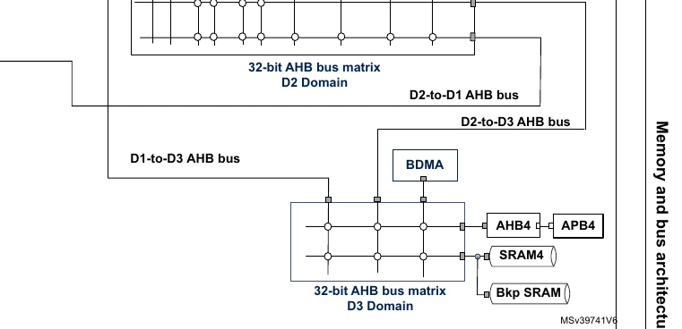

In the H723+ family the BDMA for SAI4 can only access certain internal SRAM spaces, maybe that's also the case here?
So you might have to place the buffers in that particular SRAM.
Check your ref manual, probably chapter "2 memory and bus architecture" might have an overview (which is hopefully correct...).

Already checked this, following this thread, and I can confirm my memory seems to be in the right spot. If you look at my serial screenshot, you'll see that the pointer for the buffer is at 0x380010000, which is within SRAM4 in STM32H747I-DISCO. DCache is disabled.
AScha.3
July 23, 2025
as shown in rm :
-> using BDMA , your data has to be in sram4 .

DMA/DMAMUX registers look good, the only strange thing is, that SAI_ASR is completely zero - I'd expect nonzero FIFO level, and maybe even overflow indicated, since DMA does not pull the data. So I'd suspect SAI being mis-configured.
I'm not much of a SAI expert to judge from registers whether it's OK. One thing which IMO is suspicious is SAI_ASLOTR.SLOTEN being entirely zero, IMO that means that all received data are to be discarded.
Nevertheless, in this case I'd recommend starting with some very rudimentary polled SAI implementation until it works, and only after that going for DMA.
miloaAuthor
July 24, 2025
Ok, you were right! It turns out I had not set any of the slots active. I have a different issue, likely related now. The SAI4 and BDMA are busy, and the transfer callbacks are being called, but the data written to the buffers is all zeroes... I imagine this could be a hardware issue, but I was wondering if there was some way to debug this?

Getting a 63.3kHz signal from the clock on PE2, absolutely nothing on the PC1 data pin. I'm convinced the mic is defective.

> Getting a 63.3kHz signal ...
Does that frequency make sense? Just curious, I would have assumed it should be higher.
miloaAuthor
July 25, 2025
I'm not entirely sure. I am admittedly a little confused on the SAI clocks. When I wrote this reply I had the mux on CubeMX configured to send a 4.096 MHz to SAI4, since I thought that met the specs for 16kHz audio with oversampling on and no internal clock divider. Then I switched it to 50 MHz since I read that CubeMX automatically adjusts the prescalers (therefore, higher frequency = better?). Neither of them work.
AScha.3
July 25, 2025
The SAI needs typ. Fs x 2048 as clock; so for 44k1 stereo I2S mode audio i use 90.333MHz sai clk.
