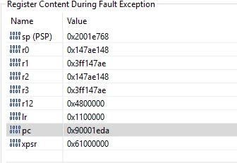

The previous example was one-time-happening. These following two examples with different build - compiler optimization settings modified - seems to be more often occurring - though not in every run:
PC points to the line:
float hdop = atof(data);
Our code is linked starting from 0x9000 0000 and SRAM memory used is MCU's internal SRAM, 0x2000 0000.
Stack is not overrun.
And this build runs normally for minutes, and then suddenly crashes with above shown results

Have you checked the contents of CFSR and HFSR?

Jun 10, 2019 7:50 PM UTC
I once chased a randomly occuring error, which turned out to be hardware - a piezoelement-generated spikes got into one of the STM32 pins through and unexpected parasitic path.
The automagically decomposed "last C line" is completely worthless in this case. Go to the disassembly and look at the last (i.e. the one before the one pointed to by the PC content stored on stack), sometimes also a couple of instructions before that. From that, the content of fault registers mentioned by turboscrew (because in F7 hardfault is rarely other than escalation of some other fault), and the content of registers (some of them stored on stack), it should be immediately clear, exactly which one of them is the culprit and why; work then back through the mixed source/disasm to find the C source and understand the underlying root problem.
