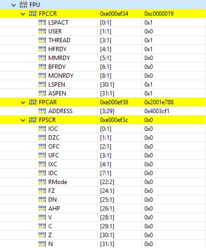

turboscrew
Senior III
Jun 13, 2019 4:39 PM UTC
That's why I pushed to check the CFSR.
The CPACR, Jan Waclawek mentioned, has a bitmap telling which coprocessors are implemented. FPU is implemented as coprocessors 10 and 11.
You might also want to check FPCCR.

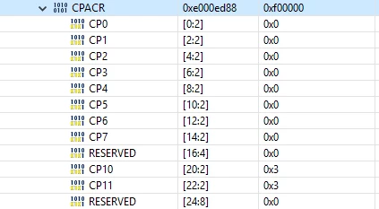

Jukka Lamminm�ki
Jun 14, 2019 9:10 AM UTC
Here are some register values from the crashing point:
0690X000008idmDQAQ.png0690X000008idm8QAA.pngto us they seem to be quite normal - though our understanding on this area is not on very high (if any) level.
In our compiler settings the FPU is FPv5-SP-D16 and - as said before - the calculations are performed successfully and correctly until this crash occurs
waclawek.jan
Jun 15, 2019 9:09 AM UTC
I see no reason for the NOCP fault, as both CP10 and CP11 are enabled.
At this point, I'd start to suspect hardware. Does the fault occur on multiple instances of the hardware? Is the power supply rock solid, as observed directly on the power pins? What's the voltage, can it be changed to slightly lower/higher? Are all supply and ground pins connected properly? Have been all pins checked for bad solder joints? Decoupling capacitors, especially VCAP, have been scrutinized?

turboscrew
Senior III
Jun 15, 2019 9:53 AM UTC
Also, it might reveal something if you disassembled some code and searched for coprocessor accesses (CDP or CDP2). Maybe some other coprocessor gets accessed. Shouldn't, but then again this fault shouldn't happen in the first place. Maybe - just maybe - there is a bug in the compiler or compiler setup.
Maybe the execution gets into some literal pool or something...
