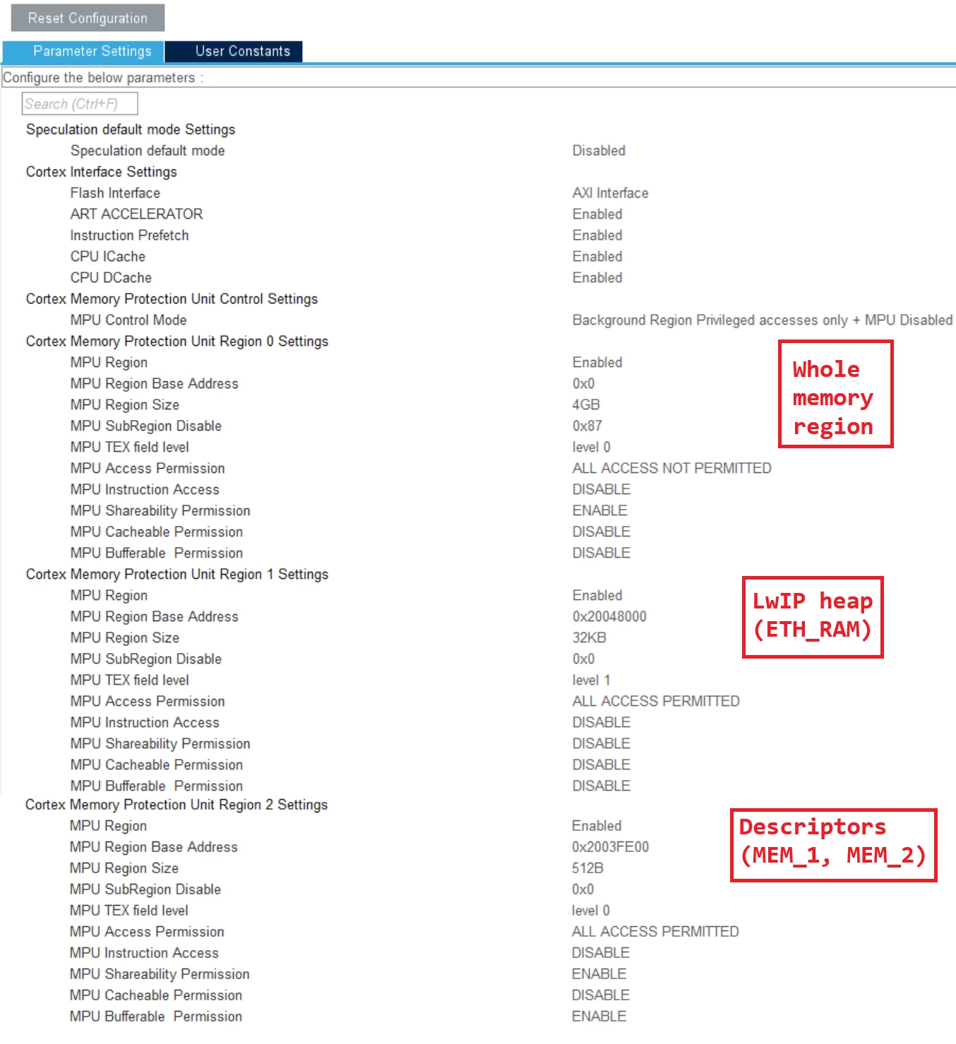

Since STM32F7 MCUs have Memory Protection Unit, I had to configure it as well. I followed the mentioned guide to do it:
Because in the guide there was no memory protection set for RX_POOL, I didn’t set any as well.
I have run the program with this configuration and it seems to be working fine. I would like to ask though if the things I have done are done correctly. I would also like to know:

The STM32F746 you are using has a data cache. If you enable the data cache in main() then yes the RX buffer pool must be configured as non cacheable.
If you were on an STM32 without data cache then no need for special MPU configuration.
The ethernet descriptors (RX and TX) must be in a memory area configured as non cacheable and strongly ordered .
strongly ordered is used to ensure the OWN bit of the ethernet descriptor is written last, after the other words that define a transfer. This gives ownership of the descriptor to the Ethernet hardware, so that it starts the data transfer.

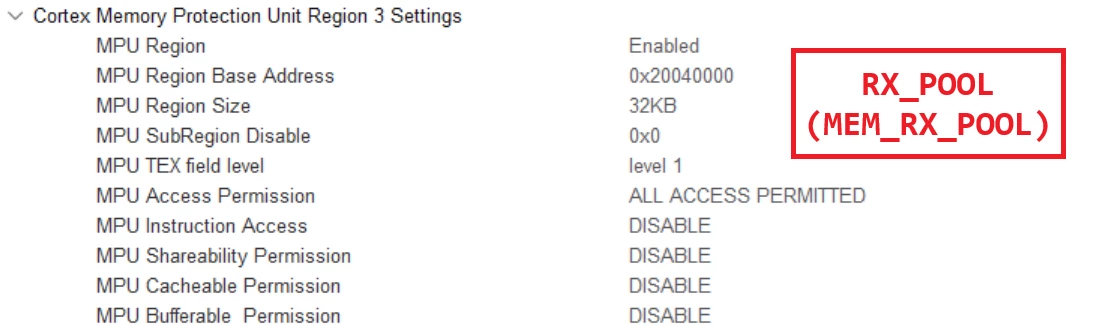

I have met with a new bug. Ocasionally I get a HardFault in pbuf_free() function where struct pbuf *p variable points to an address within the RX_POOL section . The problem doesn’t seem to appear if MPU is configured to treat memp_memory_RX_POOL_base as non-cacheable.
_AdamNtrx
_AdamNtrxAuthor
Jul 17, 2026 10:16 UTC
ST Support confirmed that RX_POOL has to be non-cacheable as well. Here is the missing MPU configuration:
