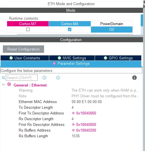

6.4 Ethernet configuration
- Enable Ethernet peripheral in pinout view in MII mode (MII used on the board).
- Enable Ethernet interrupt and set preemption priority to 5. This is required by FreeRTOS™ to call its functions from the interrupt handler.
- Relocate Ethernet CRS and COL signals from PH2/PH3 to PA0/PA3.
- These signals are optional in full-duplex mode and not connected in the default configuration.
- This also allows using PH2/PH3 for QSPI.
- Other pins should be correctly placed, since we create the project from the board selector.
- Set the GPIO pin speed to “Very High”.
The ETH_MDC speed could not be changed, but it does not affect the application and is fixed in new versions.

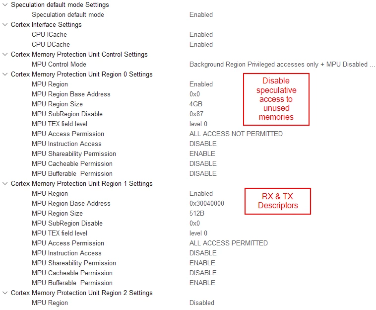

6.5 Cortex®-M7 configuration
This step can be skipped when using a Cortex®-M4 core.
- Enable ICache and DCache.
- Enable memory protection unit (MPU) in “Background Region Privileged access only + MPU. Disabled ...” mode. Configure regions according to the picture below:
The example above is intended for the STM32H743 device. For other devices or Cortex®-M4 core on dual-core devices, different addresses and size might be necessary. Please refer to the section 4. Memory layout.
When using a dual-core device and running Ethernet on Cortex®-M7 core, ensure that memory used by Ethernet is not used by Cortex®-M4. Also note that the Cortex®-M4 can use a different address alias for D2 RAM

- Placement of the RX_POOL buffers (although we configured the address in CubeMX) in ethernetif.c

- For STM32H72x/H73x devices, the Ethernet buffers cannot be placed in the address range 0x30040000 - 0x30048000, since that range is not valid. D2 SRAM on those devices is much smaller, so the buffers need to be placed starting at 0x30000000. This affects RX & TX descriptors and RX buffer addresses (ETH configuration in CubeMX) and LWIP_RAM_HEAP_POINTER used for TX buffers (LWIP > Key options in CubeMX).
- When running the stack on Cortex-M4, the buffers can be placed at the same address (0x30040000), but it is better to place them at 0x10040000, which is the alias for the same address. This alias is accessible by Cortex®-M4 D-bus and helps to utilize the Harvard architecture.

- If a Hardfault is called, the problem might be in the MPU configuration.
- Check the values carefully (for example, a slight mistake like having "256KB" instead "256B" can make a significant difference)
