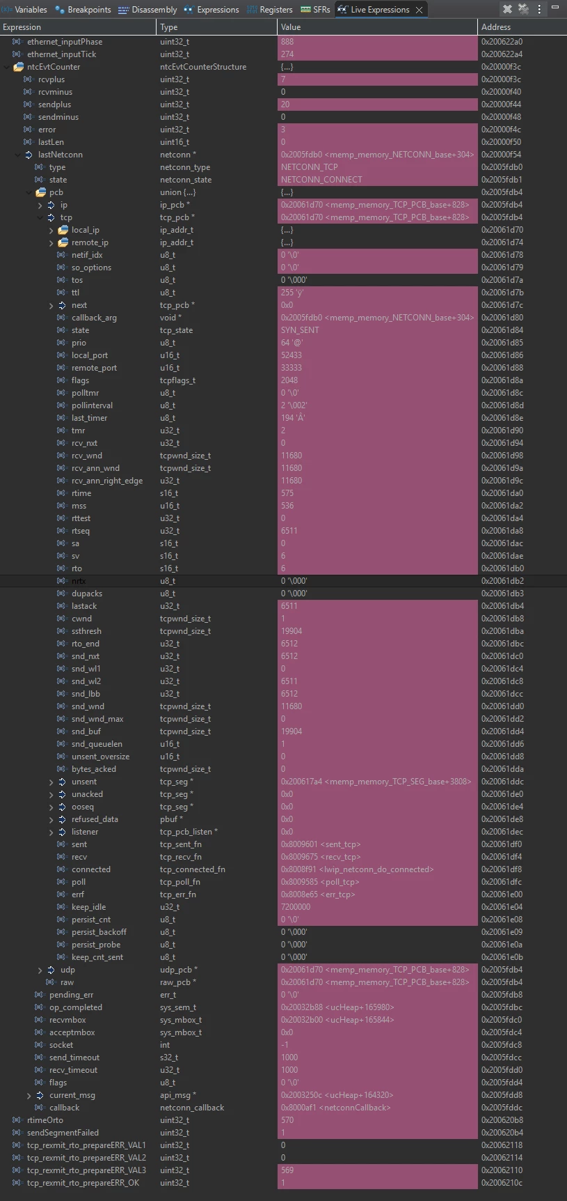

Hello! Recently I discovered that my program (STM32 TCP client) gets stuck in netconn_connect() function for about 5 minutes if server to which I want to connect to is not available when this function is called. Only after that time program would go into
if ((tcp_rexmit_rto_prepare(pcb) == ERR_OK) || ((pcb->unacked == NULL) && (pcb->unsent != NULL))) {
statement (which is present in tcp_slowtmr() function). Once it happens, the debugger shows that:
TCP PCB shown in debuggerTCP PCB shown in debugger
It's the tcp_rexmit_rto_prepare(pcb) condition that allows program to go into the if statement. Also, as debugger shows, nrtx is equal to 0, which means there were no retransmissions in the last 5 minutes (rtime=575, which is 287 seconds).
Interesting thing is it's possible to "unfreeze" the program way sooner by pinging the client device or by replugging Ethernet cable. netconn_connect() would finally finish and device could try to connect to server once again. By the way, the netconn I used was of blocking type. Non-blocking one leaves netconn_connect() immediately and returns ERR_ISCONN, but that doesn't help with reestabilishing connection to server if netconn_connect() was called when server wasn't available.

Using HAL_ETH_ReleaseTxPacket() function before do... while loop finally allowed program to properly retransmit SYN packet and not get stuck in netconn_connect(). From what I understand, old SYN packet, sent when server was down, was stuck in DMA and held reference to output segments, which made tcp_rexmit_rto_prepare() function return ERR_VAL and because of that tcp_slowtmr() would not get into if statement mentioned at the beginning of this post. HAL_ETH_ReleaseTxPacket() makes program acknowledge that SYN packet has been sent and thus retransmitting it becomes possible. Also, since HAL_ETH_ReleaseTxPacket() is being called when device performs a transmission (with use of low_level_output() function), pinging STM32 makes it release old Tx packets when it's responding to ping.
