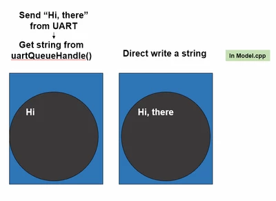

When I use "String" to receive, then copy it to RData and send it to View to display, the screen will display only 1~2 characters.
Another test I did was to replace "String" with the contents of data[256]. the text was displayed in full without going through the Queue.
I suspect it's a queue problem. Is there any way to display the content stored in the queue?

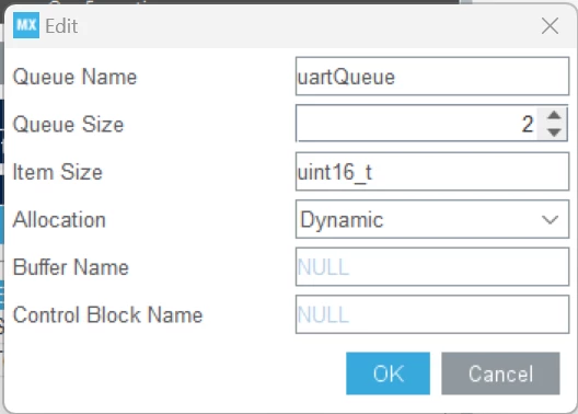

Here is my Queue setting, and my CubeIDE version is 1.15.0.
uartQueueHandle = osMessageQueueNew (2, sizeof(uint8_t), &uartQueue_attributes);

When you created your message queue how much size you configured for it?

Mar 22, 2024 7:47 AM UTC
@mƎALLEm Thanks for your reply.
This is my queue setting

Your Queue size is 2.Increase it to the length of your string.
Item size need to be uint8_t as you are sending characters.
