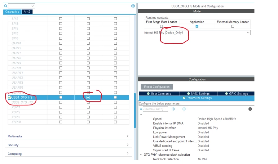

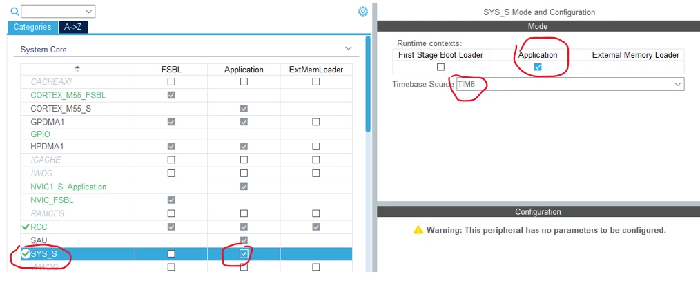

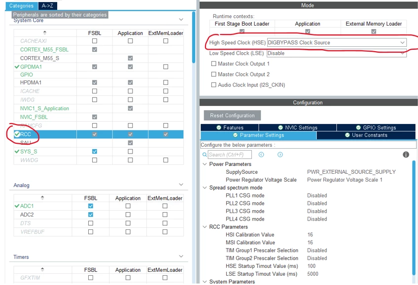

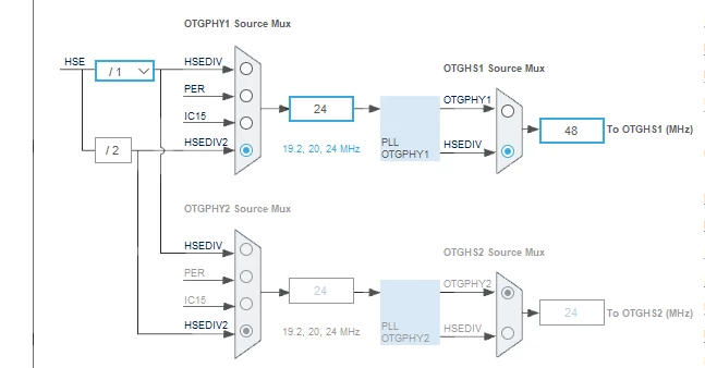

Here are my STM32CubeIDE settings:

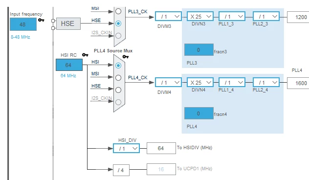

Step#1:  Clock Configuration.
Step#2: Set SYS clock : HSE -? DIGBYPASS Clock Source

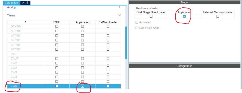

Step#3:  Select TIM6, check off : Application
Step#4:  Select TIM6 as Timebase Source, check off : Application
 Step#5:  Select USB1_OTG_HS, and select Internal HS Phy: Device, check off : Application

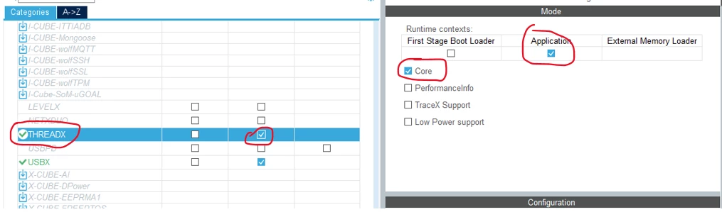

Step#6:  Select Threadx  and check off Core and Mode: Application

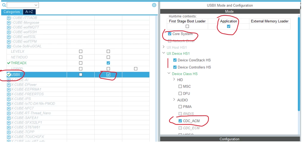

Step#7:  Select USBx with the following setting :
1. Mode: Application mode
2. Check off  Core system
3. UX Device:  Device CoreStack HS and Controllers HS
4. Device Class HS: CDC_ACM

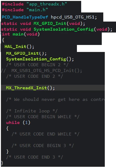

And here is my main.c file :

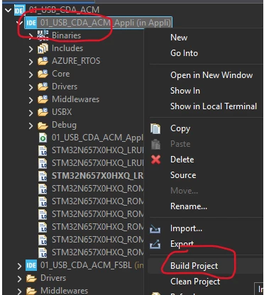

Here is my project folder structure.
To program the board, I've set the boot switches to DEV mode and compiled only the application code. I don't build or program the FSBL.
When I connect my board to my laptop, nothing happens. There isn't a new virtual COM port.
I'd appreciate it if someone could guide me on what I'm missing here.

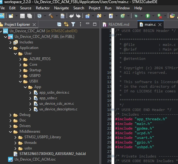

I followed your advice and downloaded the example. I opened .project file from this path : NUCLEO-N657X0-Q\Applications\USBX\Ux_Device_CDC_ACM
Here is the imported project inside the stm32cube ide:
When I tried to build the project, I have encountering this error :

I managed to fix the issue and now I can see a USB Serial Device
